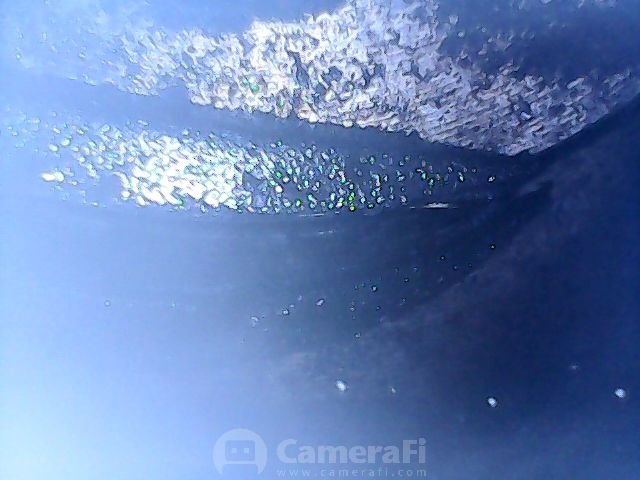

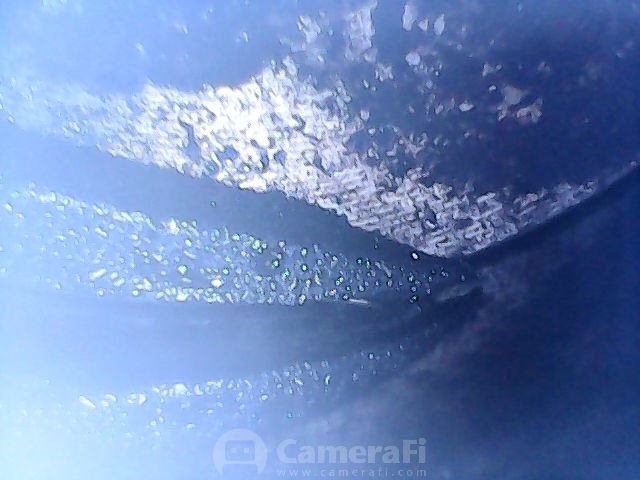

I've been thinking about this all day. With something in a combustion chamber it will fall or slide to the outside wall do to the angle of the piston so it's kind of out of the way. When inverted anything in there will fall onto the valves then get between valves and piston. I'm going to run a scope down the holes tomorrow.

Okay guys, mystery solved. I ran a scope down the holes and definitely saw something in number 8.

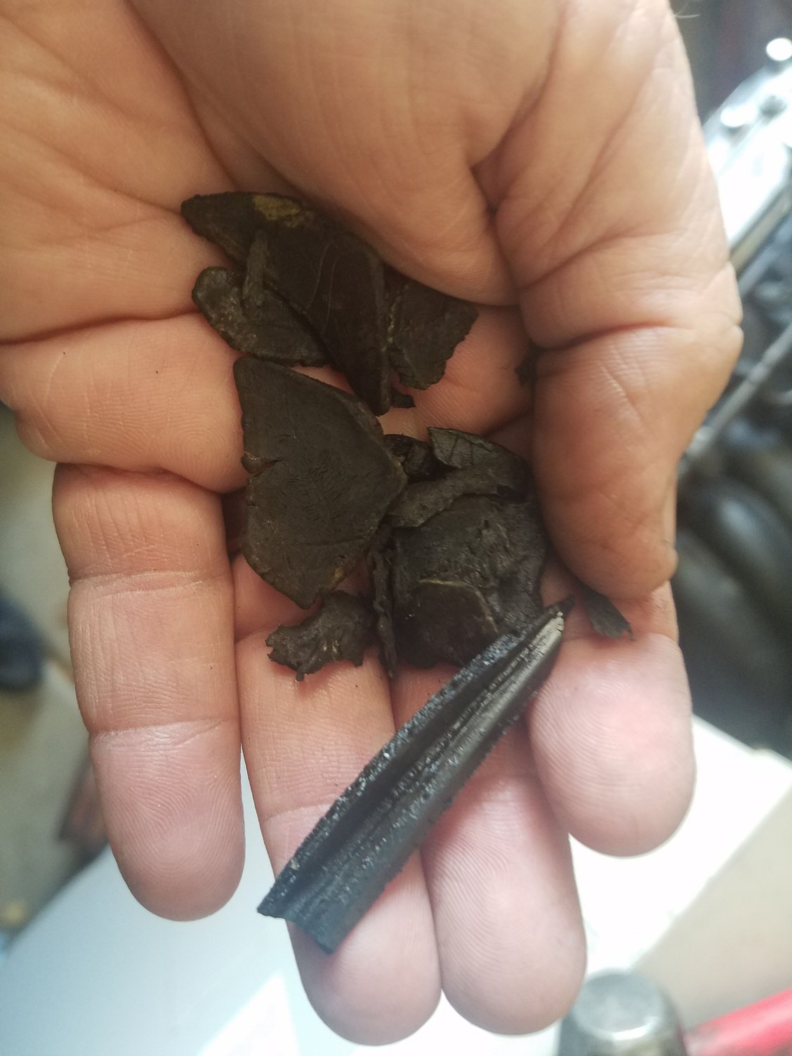

I went ahead and pulled the heads and found plastic bits in most the cylinders. Probably sucked in when the car got hit. The power steering pulley was broke so I'm guessing the air box possibly shattered in the wreck and this **** got sucked in. Number 8 had the most pieces. This probably would have never hurt anything to begin with, but now I have piece of mind knowing nothing is damaged.

Good work there! Isn’t it amazing what will get past a valve?

Just an outside caution -- while the plastic isn't hard enough to damage cylinders or heads the way metal would, you could bend something if you got enough of it in any one cylinder to become un-compressible. I'd give the seller a heads up until you see what you've got on start up.
