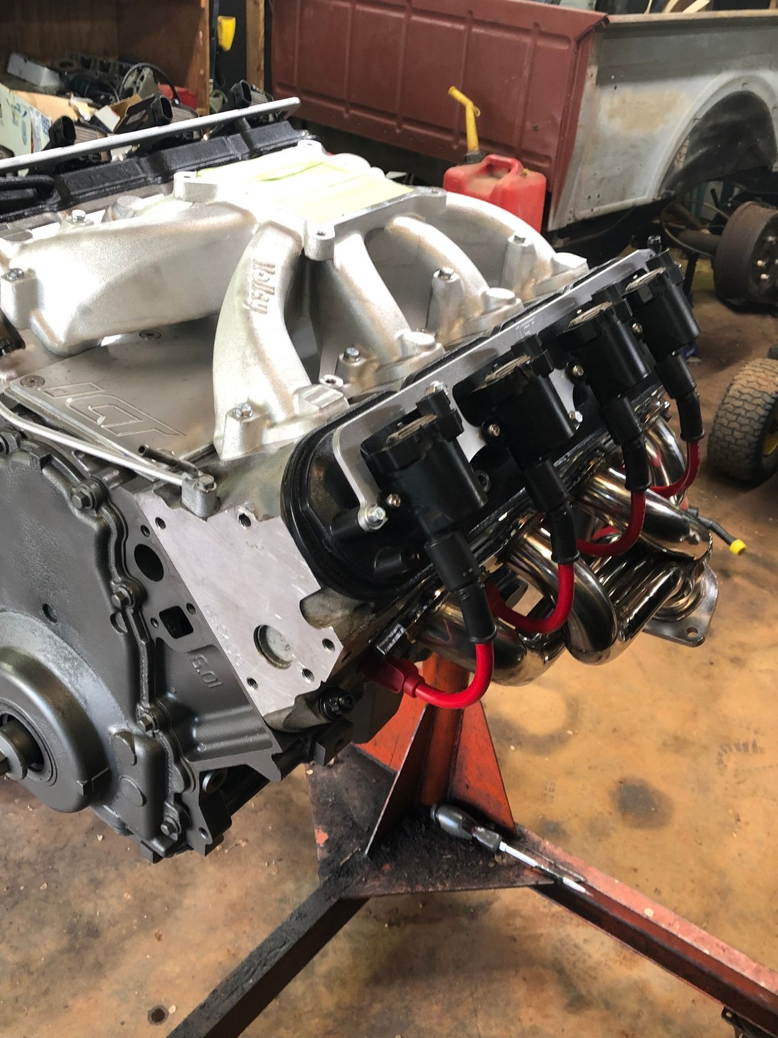

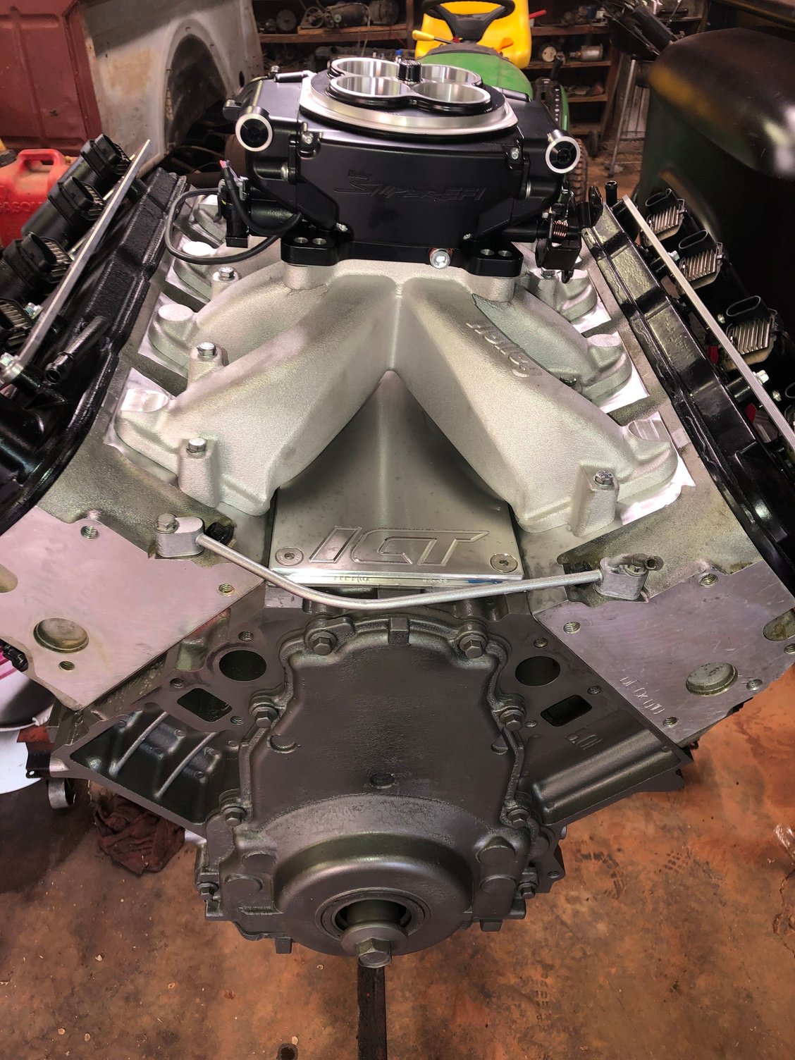

Performance built LS 6.0L with the Holley sniper fuel injection.

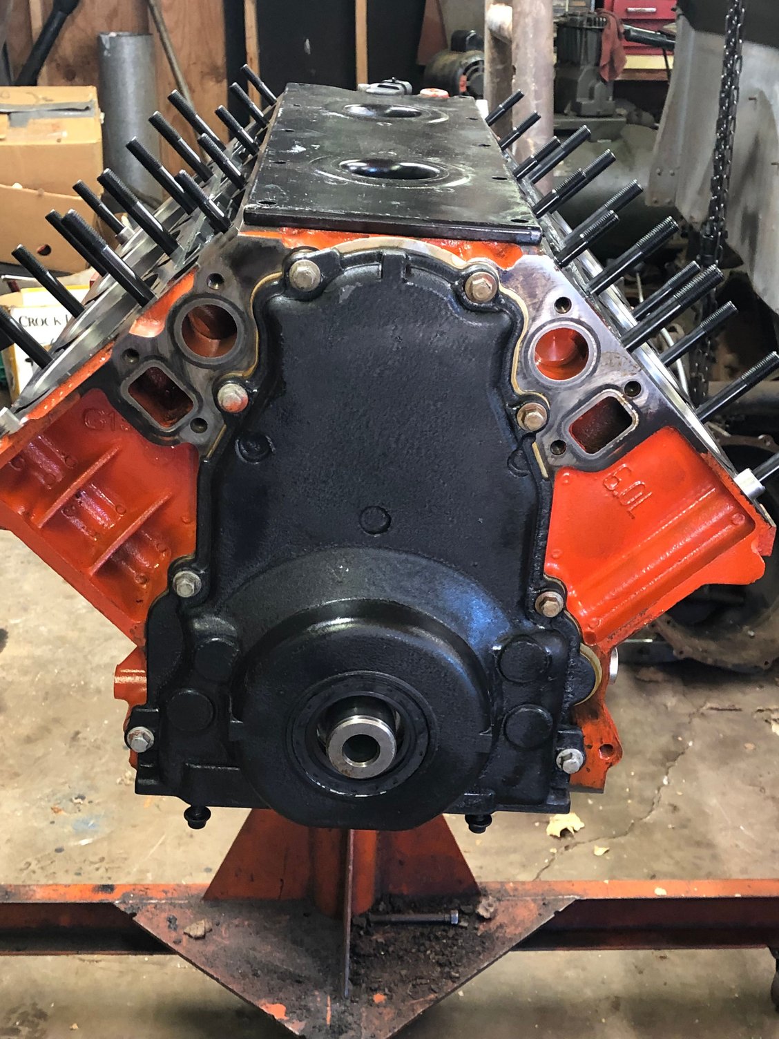

This picture was taken before I painted the block grey.
