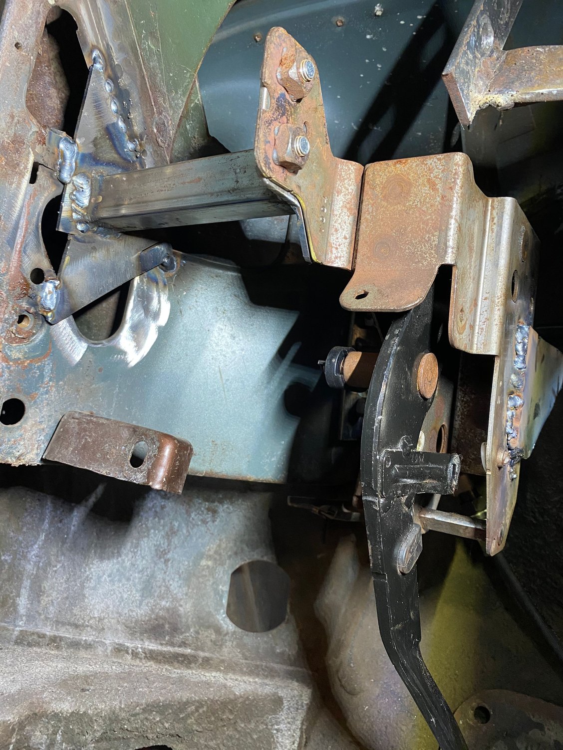

I managed to find some used CTSV pedals. So I fabbed Some mounts up.
my only issue now is the hydraulic line is about 12” short. But the silver lining here is that one end is threaded so I’m fairly confident I can get an extension on this one. Thank you everyone for your help!
