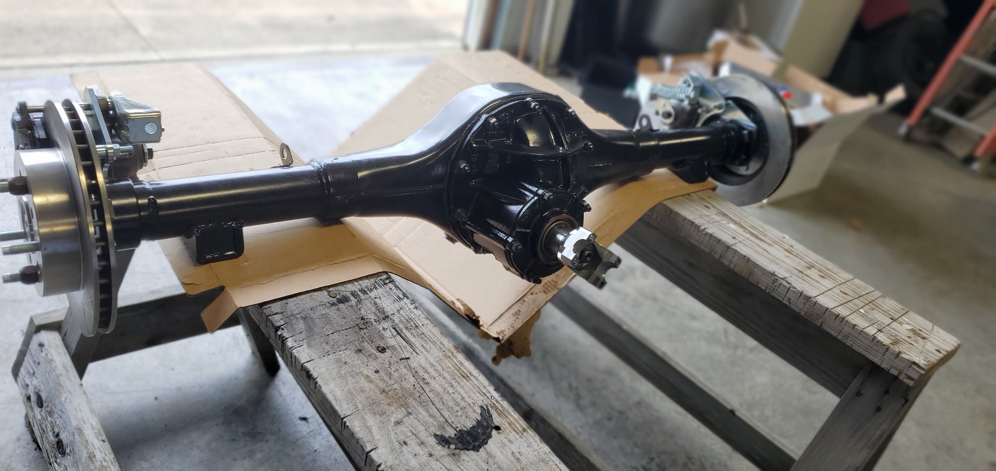

Here is my rear I'm using. Ford 9inch, 31 spline, 3.70 rear ratio, Auburn posi, disc brake conversion. Powder coated black.

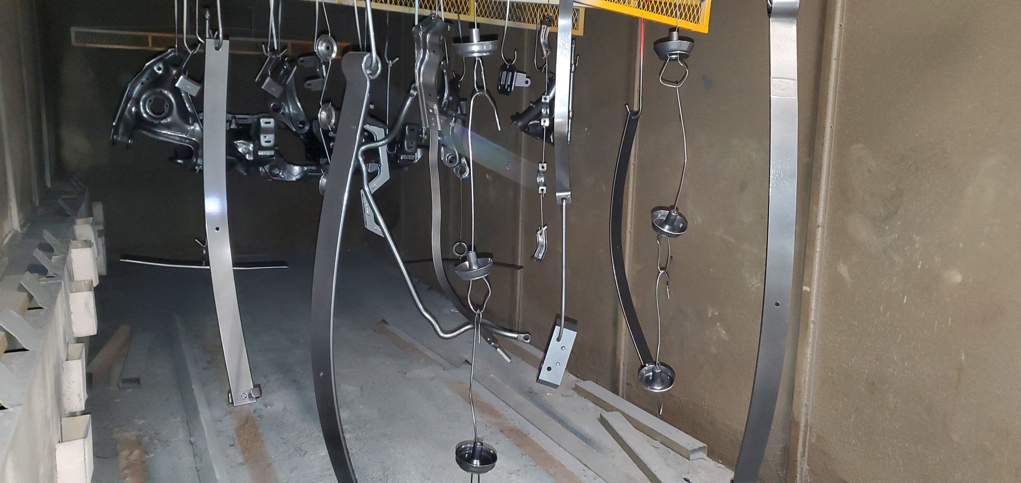

Here is some of the smaller parts coming out of powder coating...

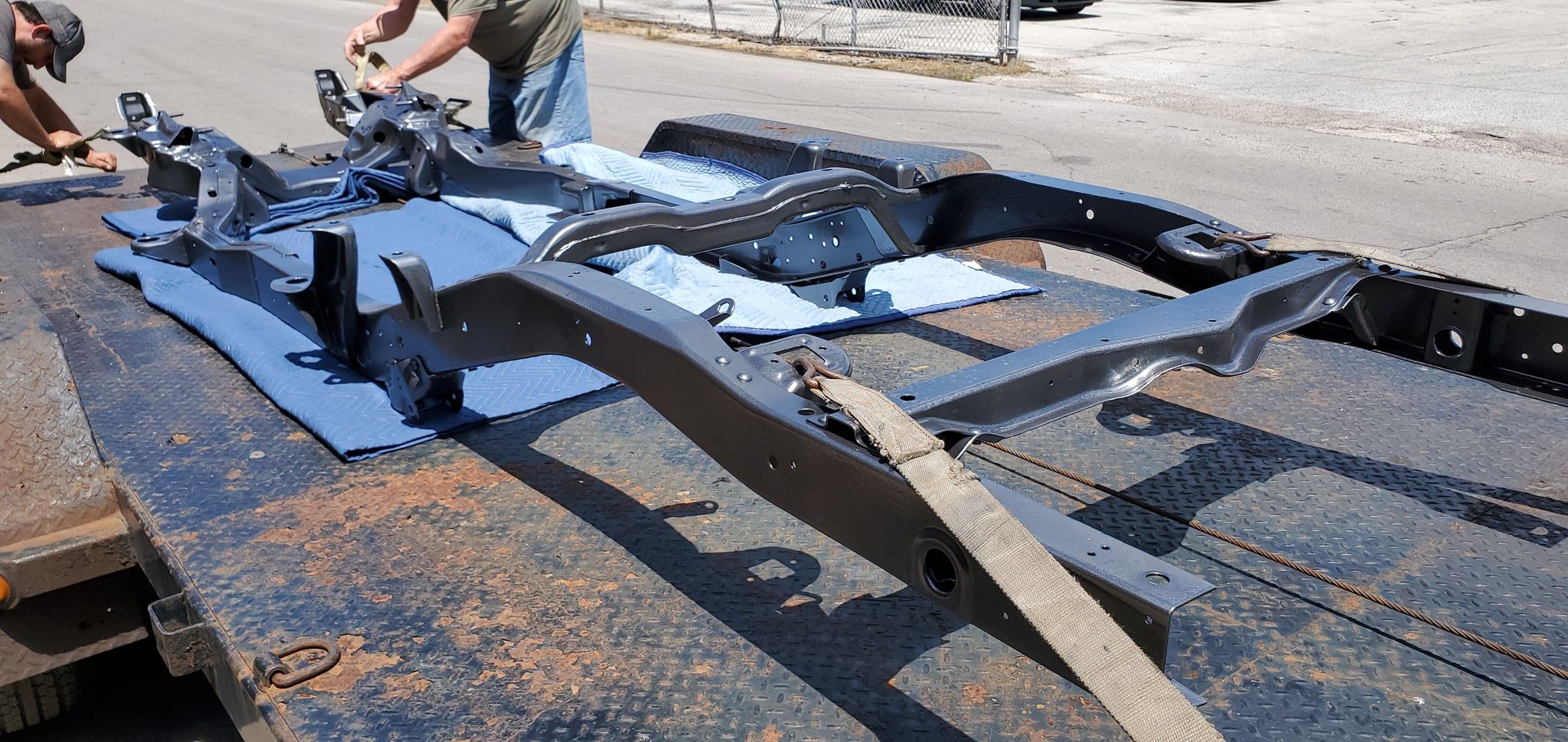

Picking the frame up from powder coating.
That's really slick! Did you build it, or buy it?
Old Jan 28, 2021 | 07:41 AM
  #34
jeremywilliams12's Avatar
Joined: Apr 2020
Posts: 63
Likes: 18
From: Indiana
I bought the housing from a friend, whom bought it new and never did anything with it. Saved a money there. I had a used 3rd member, just needed rebuilt. So I took it all to MOSER Engineering. Dropped it off, had them build it and bought the disc brake conversion kit for it.
