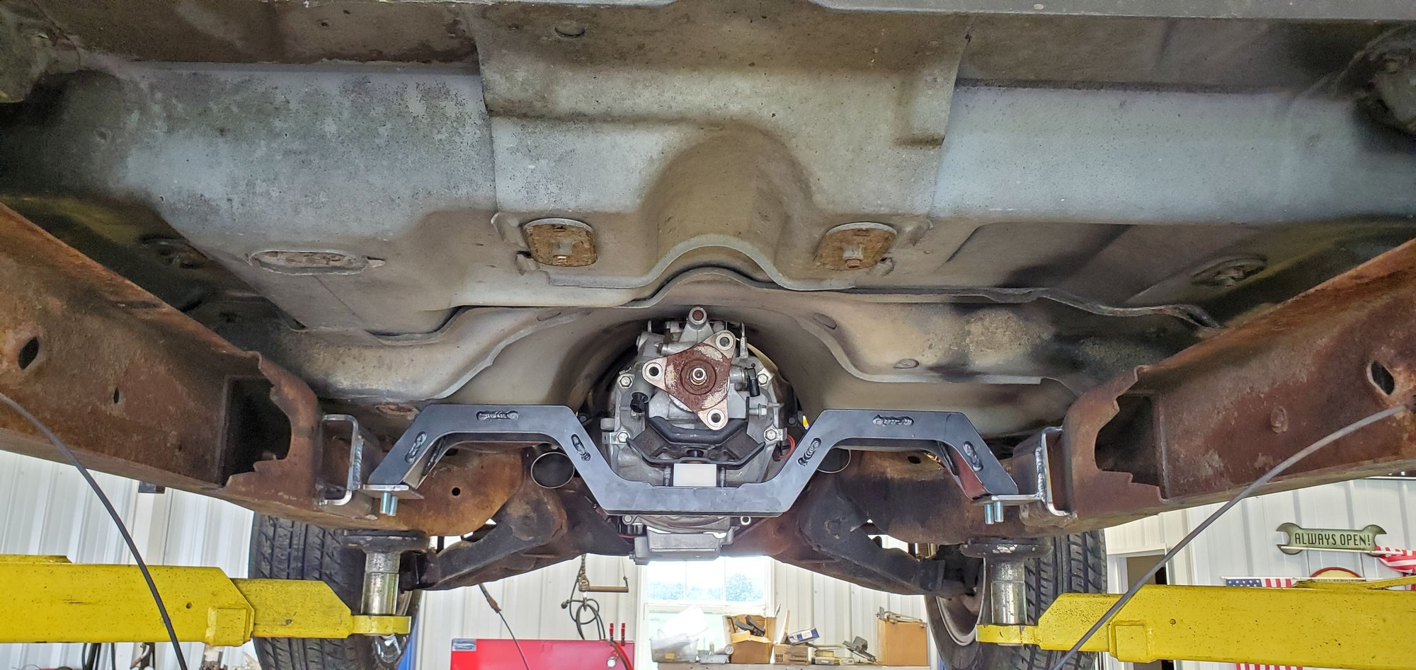

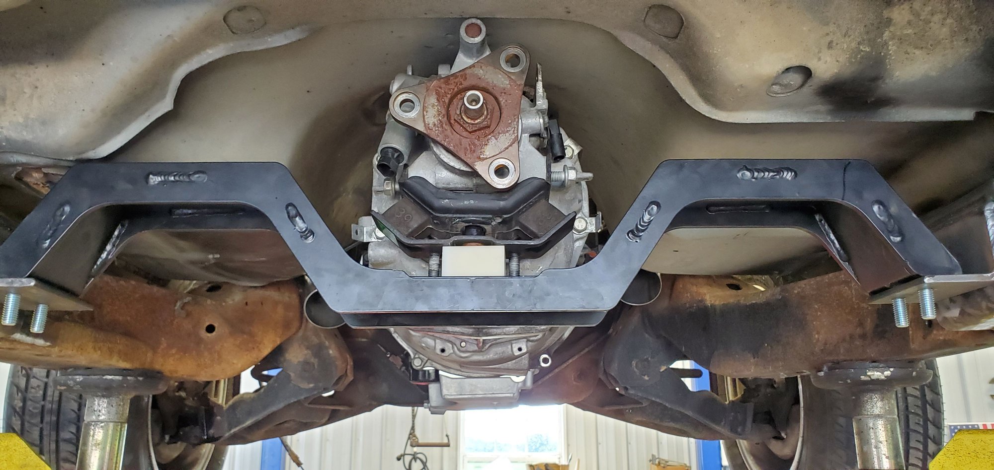

Hey. its me again. What transmission mount did you use? I cant see it because the tranny crossmember blocks the view. Thanks in advance.

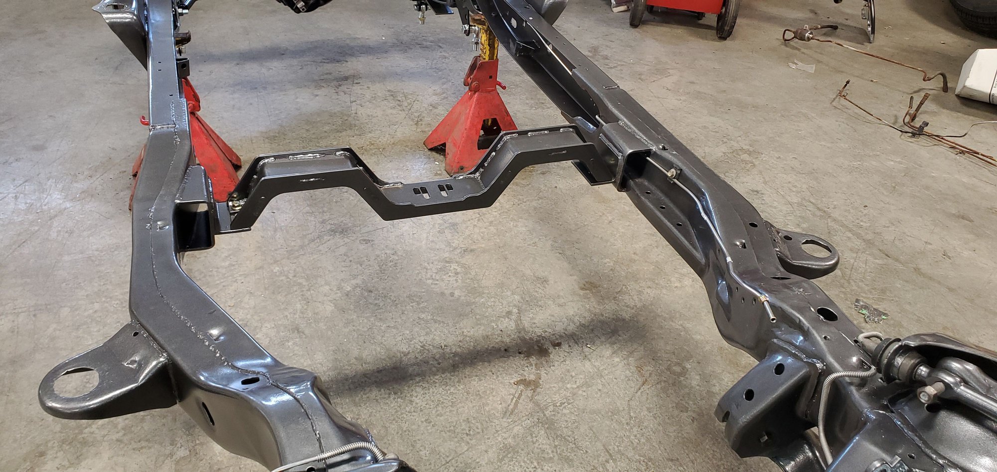

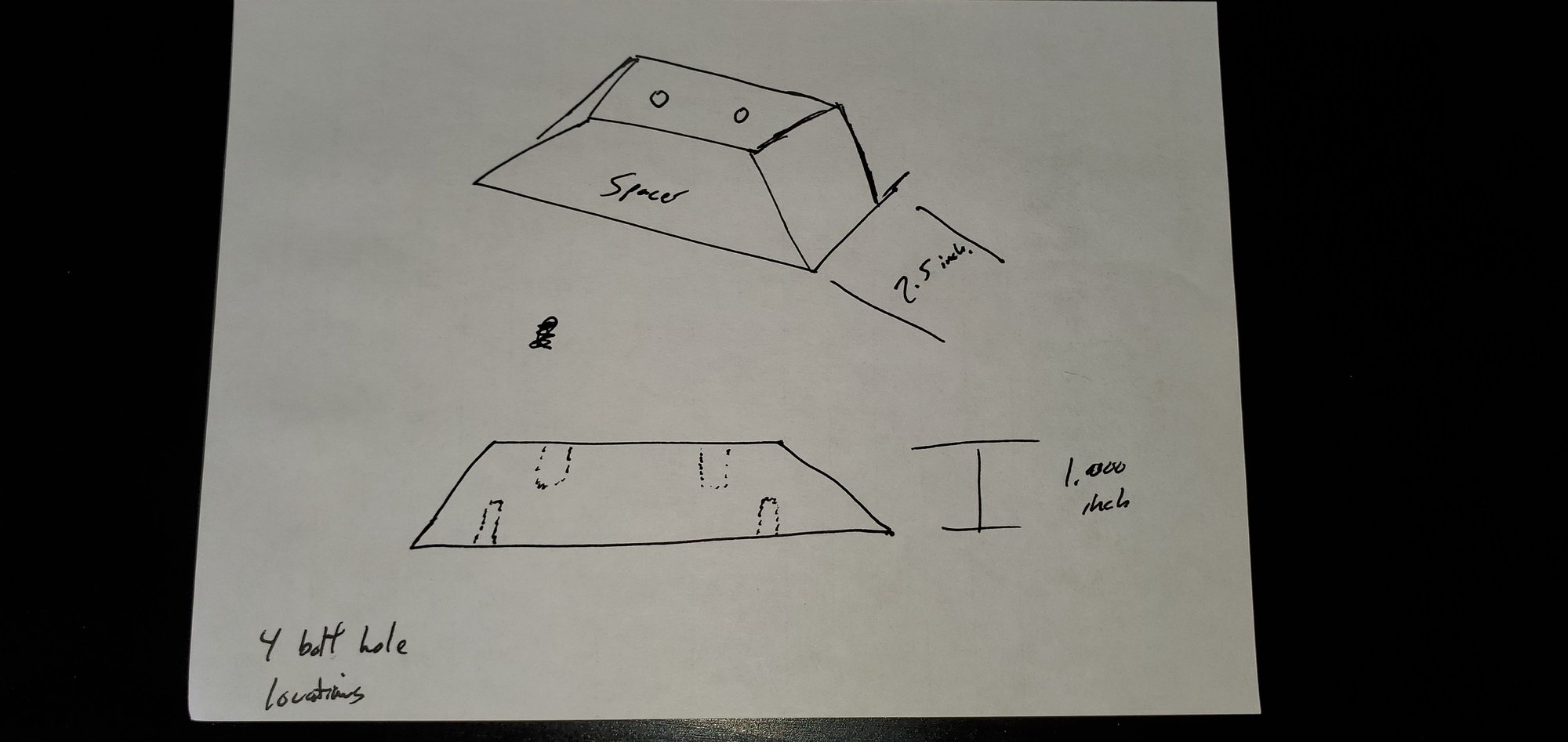

I am using the stock GM transmission mount. It works great. I did have to mock up and make a new spacer to have transmission in the correct drive train angle. Cross member is Holley. However, it is not made for this TR6060 trans. Essentially, I had to move the cross member back a few inches and then made brackets on frame to attach cross member. Of course after mock-up, everything was powder coated. I am adding pics to help explain. Let me know if you have more questions... Keep in mind, my goal for this truck is to have it look as close to possible to looking as if GM built it this way. I am also running the stock handle inside the cab... lol
