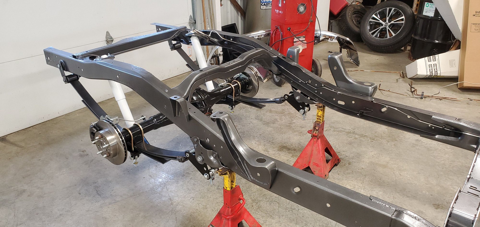

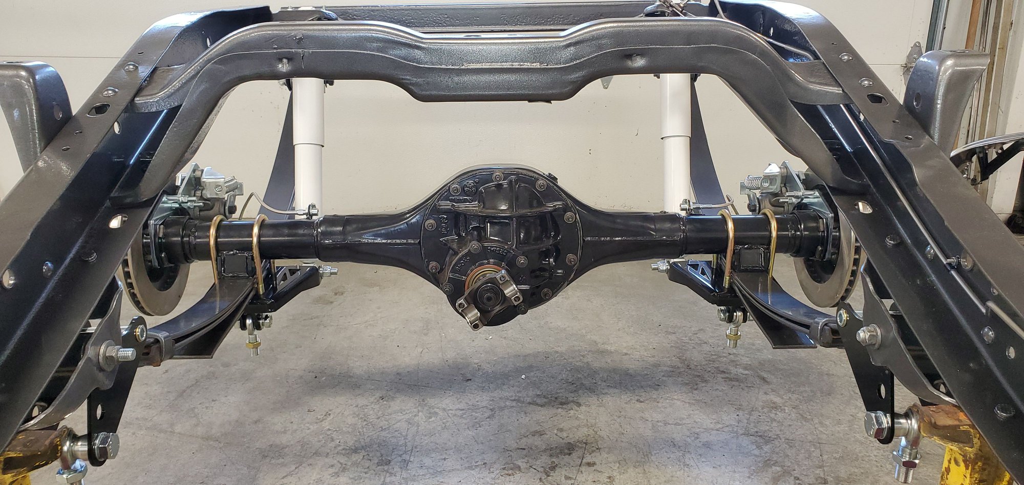

Running new stainless brake lines, install rear end, new shocks, about to add CalTracs. All new bushings etcs on the frame.

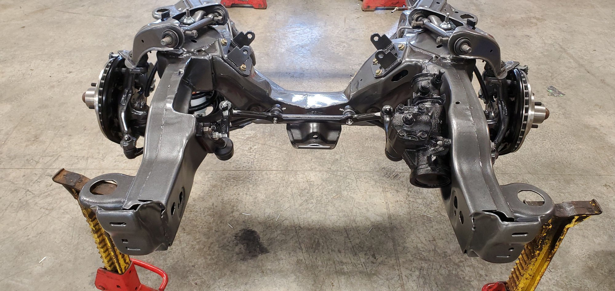

From: Indiana

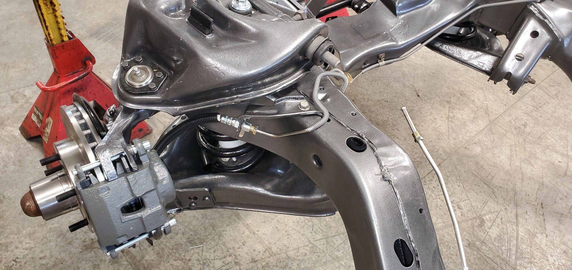

Front end coming together..... New brakes, new SS lines, new steering components, powder coated springs, new shocks........

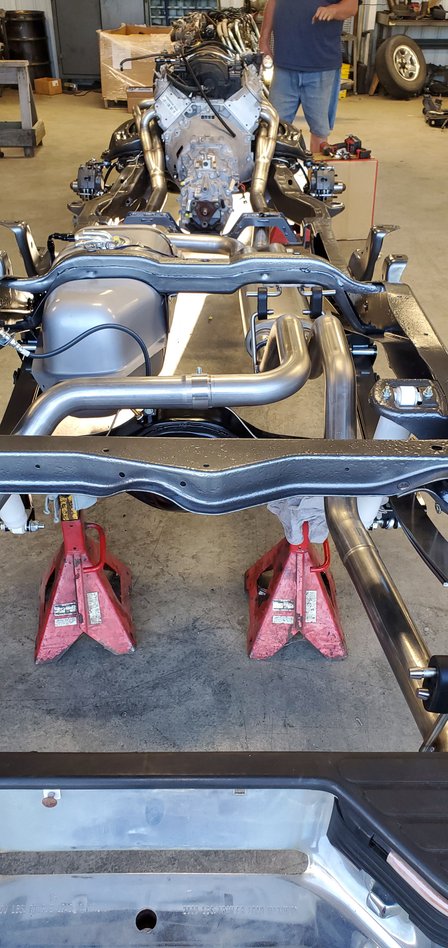

From: Indiana

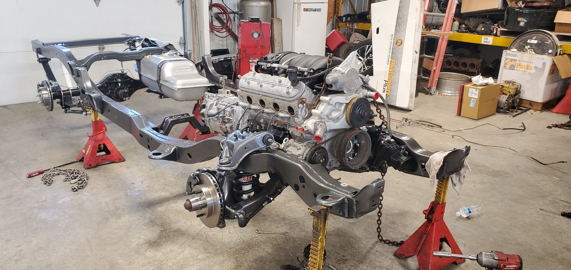

Sit the motor/trans and new fuel tank into the frame....

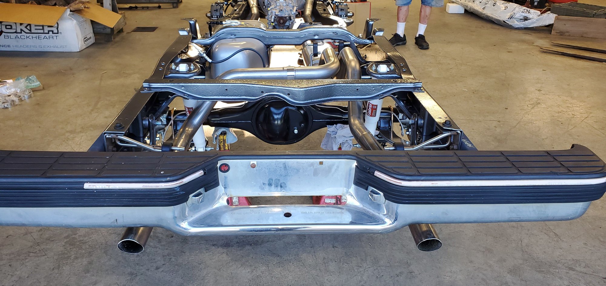

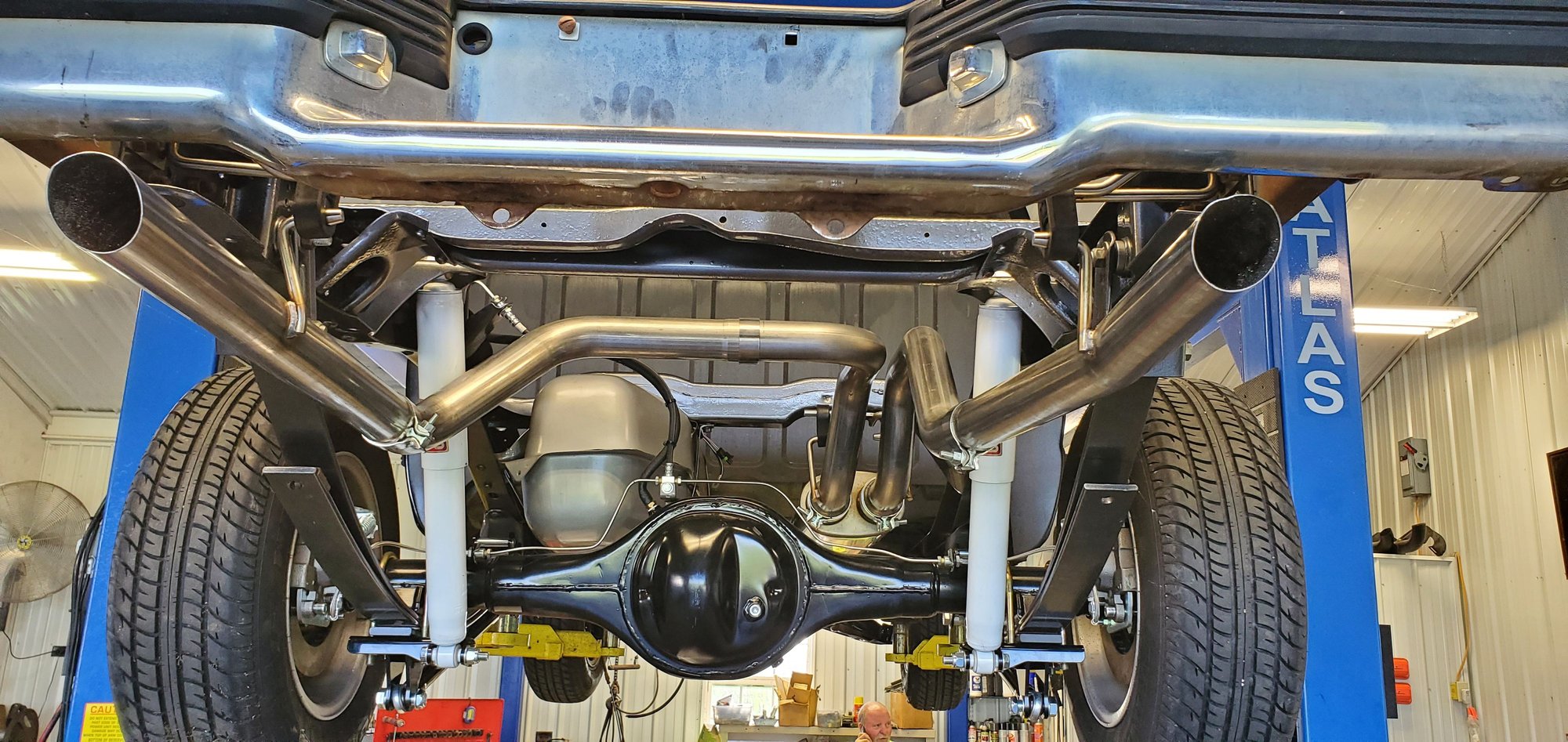

Test fitting the exhaust system.

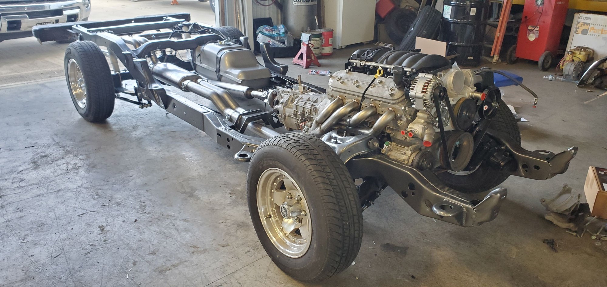

From: Indiana

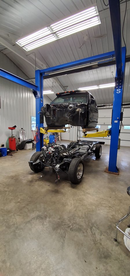

Put wheels on and test fitting the cab again! Getting close to final cab placement. Need to test fit for clearances on exhaust, trans, brakes lines, fuel lines, and whatever else might be lurking....lol

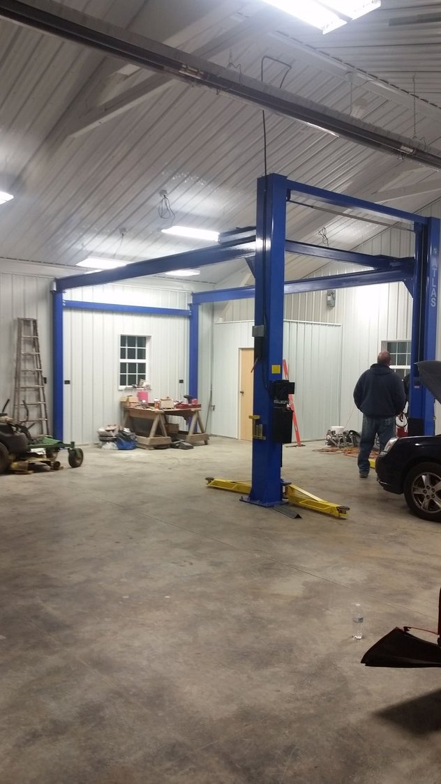

LMAO.... It is my very close uncle's garage. 10 mins from my house. I have been his sidekick for 40+ years. I helped him build it about 4 yrs ago. It is 40x60. 12 ft side walls with cathedral ceiling. Center ceiling height is 20 ft.
Here is the place we built it thru. Best thing about it, no word in the ground like pole barns. http://dandisystems.com/
In the winter, we can wear shorts and t-shirt and be warm. I insulated the heck of it. In summer, it is AC.
He is an old drag racer and helped me on this build. Notice the custom overhead crane attached to the front of the lift? lol

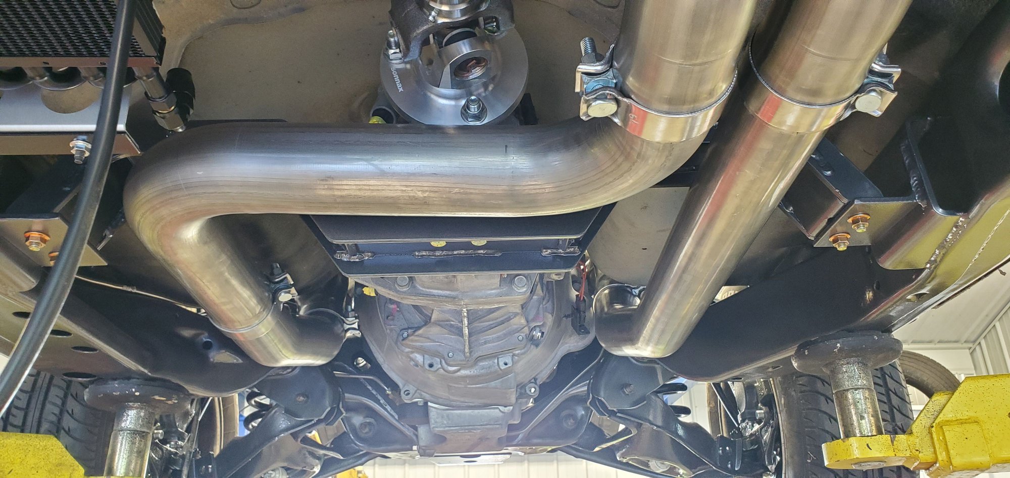

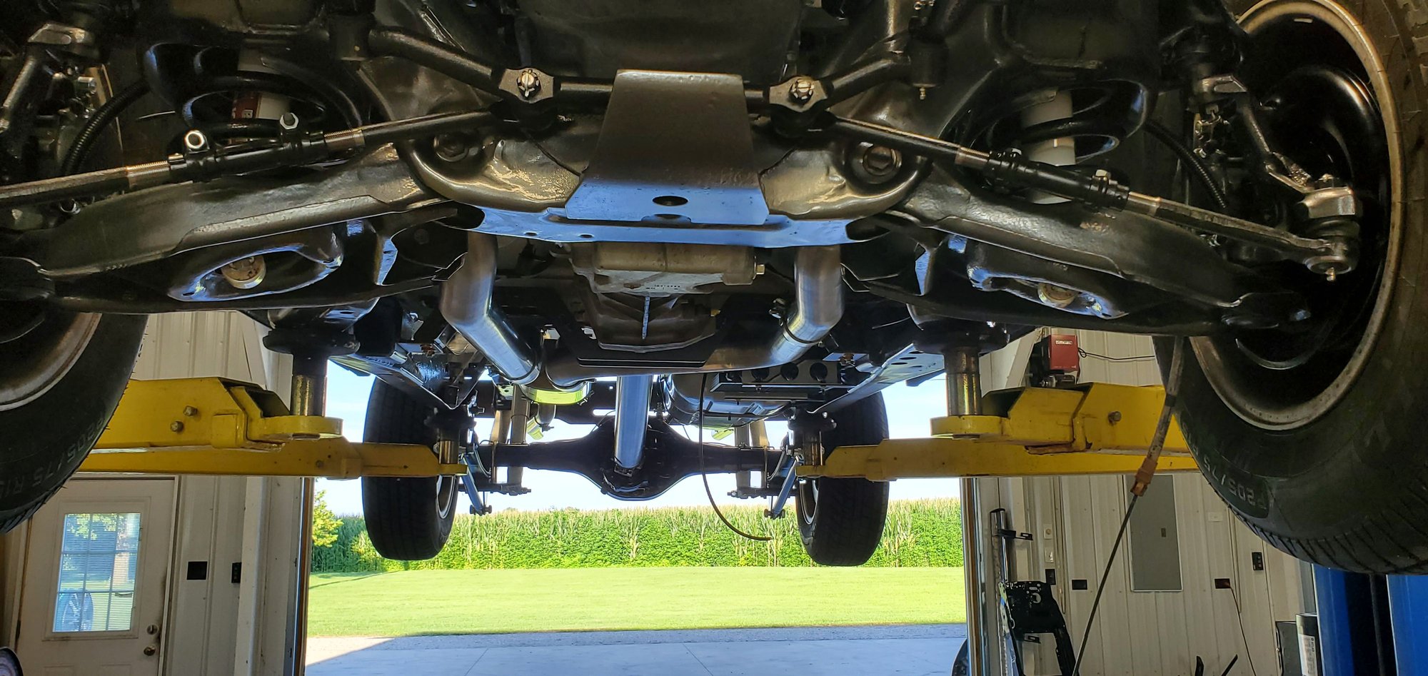

From: Indiana
Cab on and under pics........

How did u insulate it? Closed cell spray foam? I’ve heard that’s dispose to be really efficient, but I’m just repeating hear-say.
Your truck is really coming along nicely. You got to be getting excited as the work progresses
Old Feb 11, 2021 | 11:20 AM
  #52
jeremywilliams12's Avatar
Joined: Apr 2020
Posts: 63
Likes: 18
From: Indiana

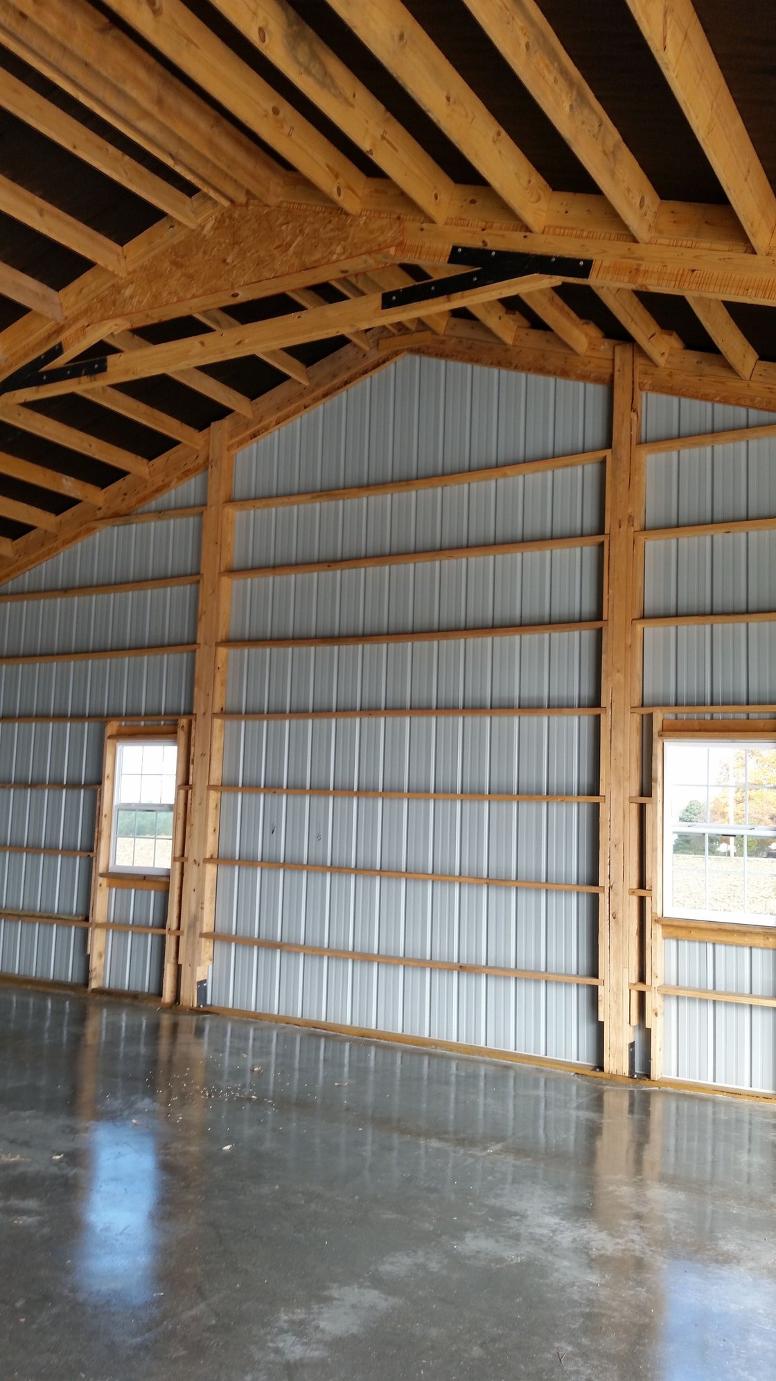

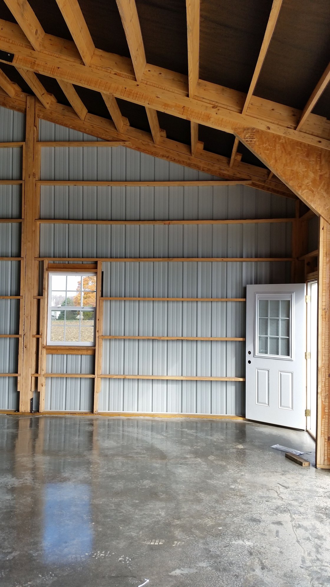

Closed cell is probably the best, but expensive. I used 3 inch foam board cut to size in walls and ceiling. Then I followed up with normal batting insulation on top of the foam board.
Ceiling thickness is 10-14 inches of insulation and walls are 6 inches of insulation.

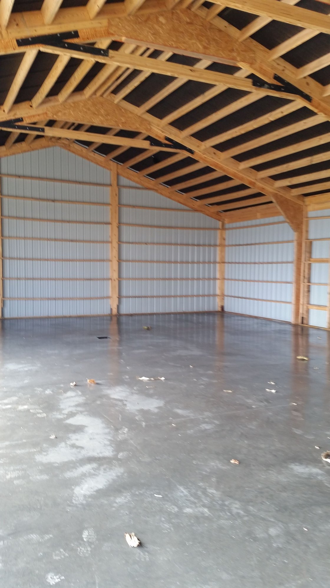

From: Indiana
Pics of inside prior to insulating.
