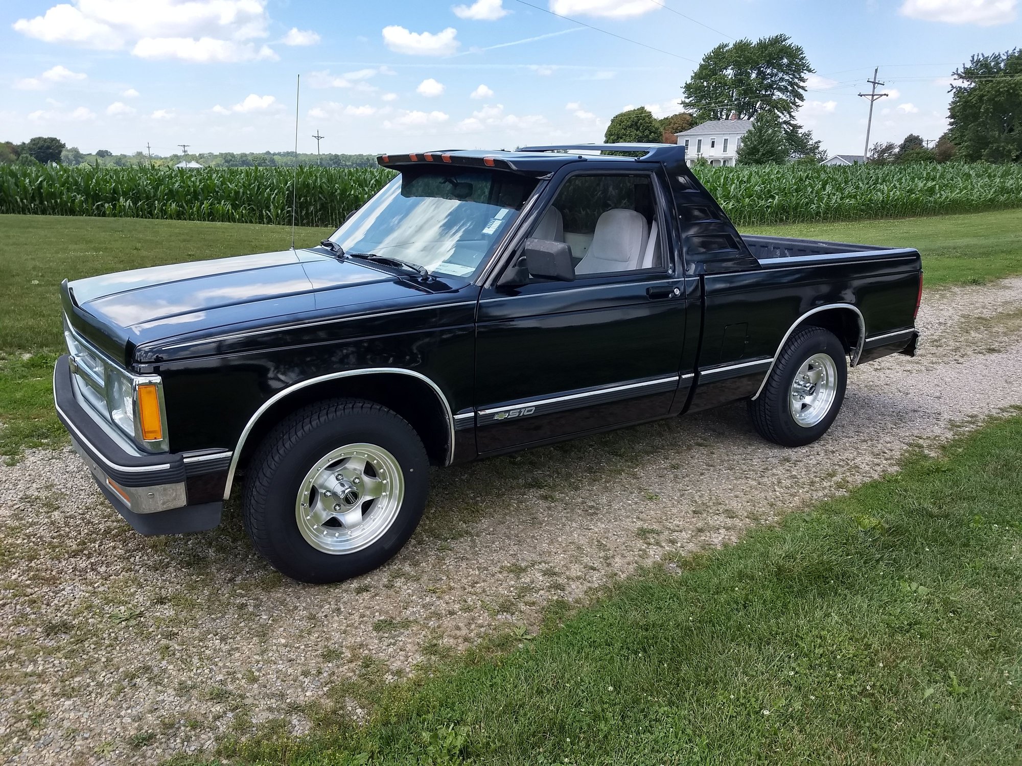

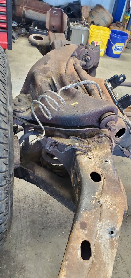

Gents,
I am just sharing my build to date. Here is the truck I started with.

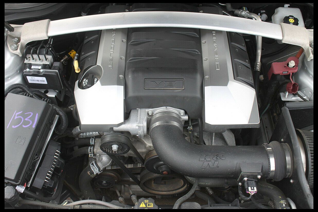

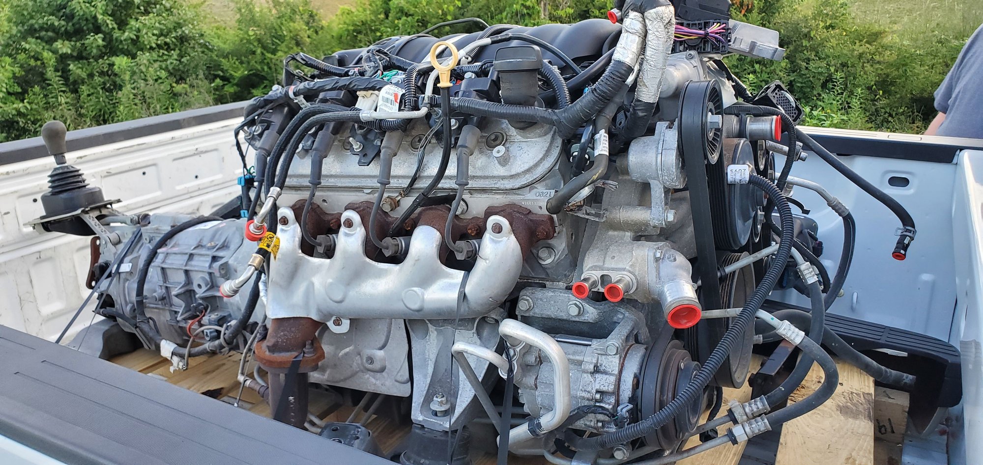

The donor.....

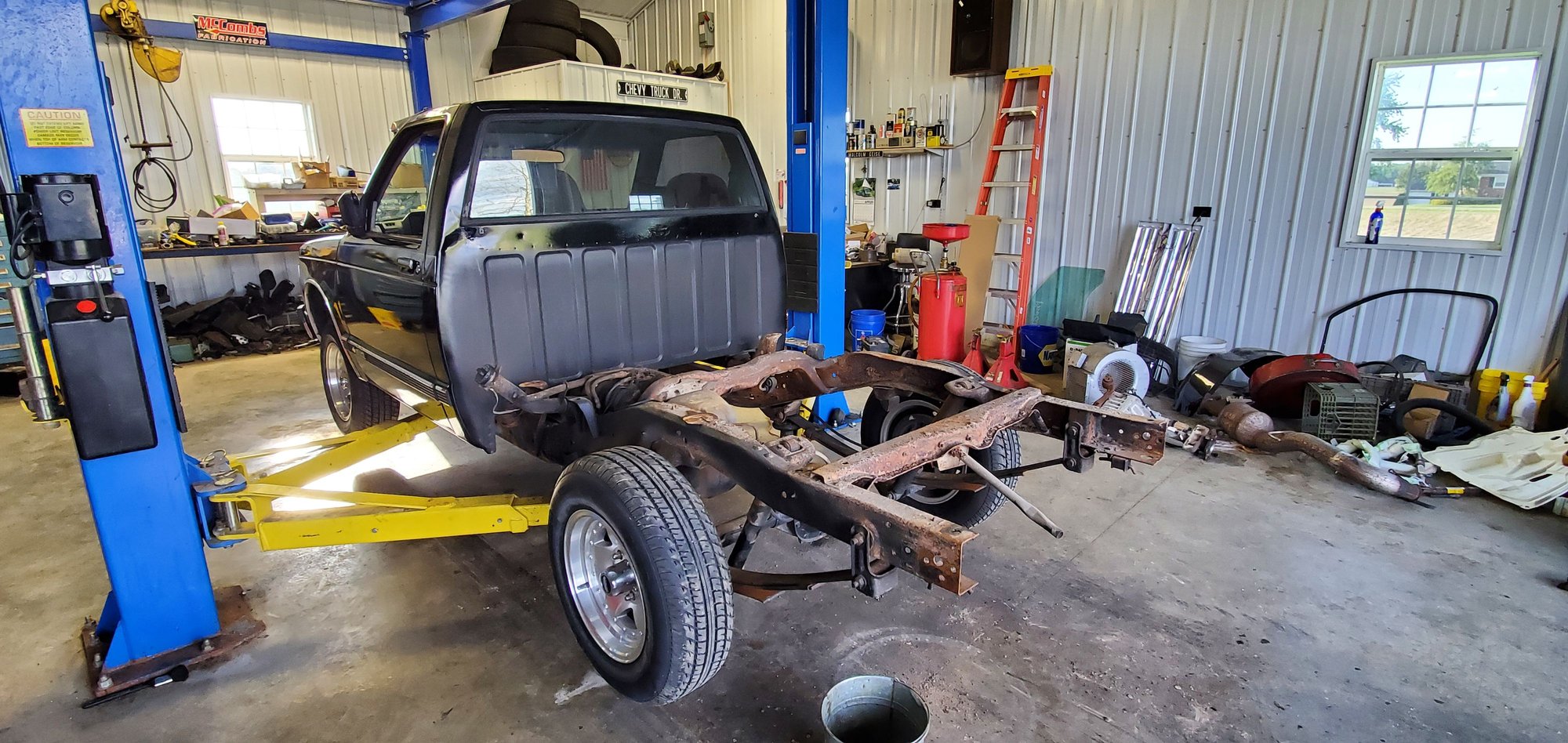

The tear
down begins....

Looks like a fun build. How many miles on the camaro/drivetrain?
Old Jan 11, 2021 | 09:26 AM
jeremywilliams12's Avatar
Joined: Apr 2020
Posts: 63
Likes: 18
From: Indiana
57K. southern car. I bought the drivetrain out of it. I do not have the whole car.

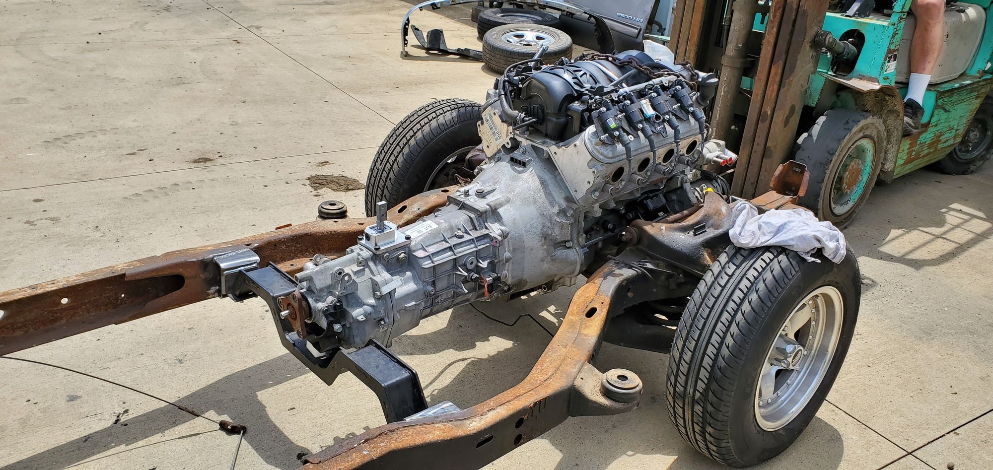

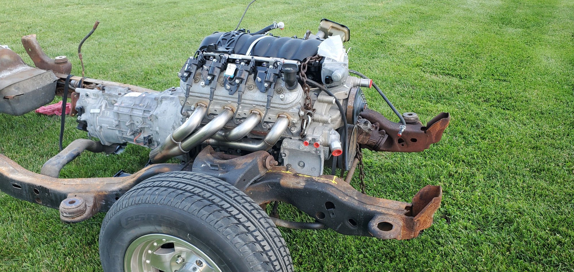

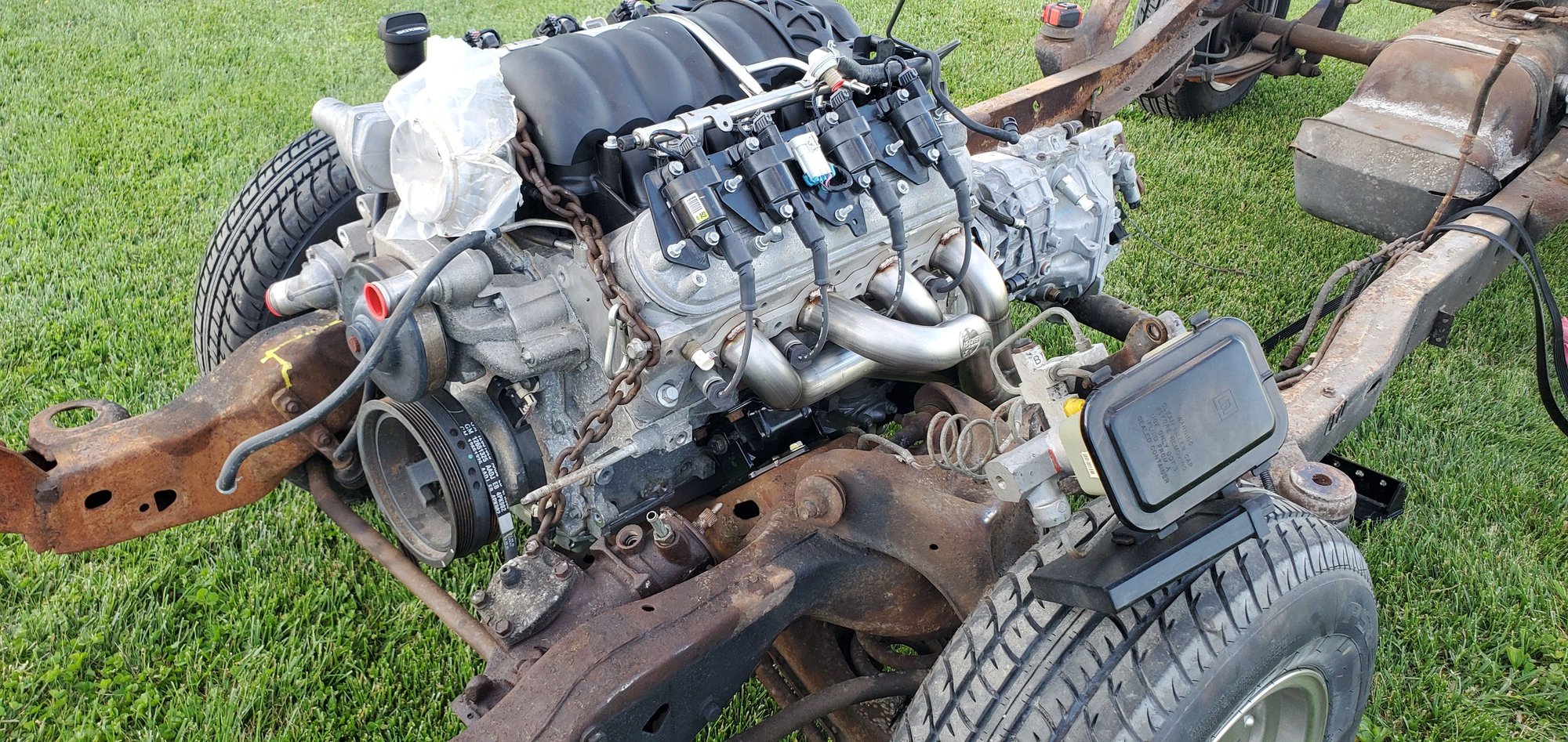

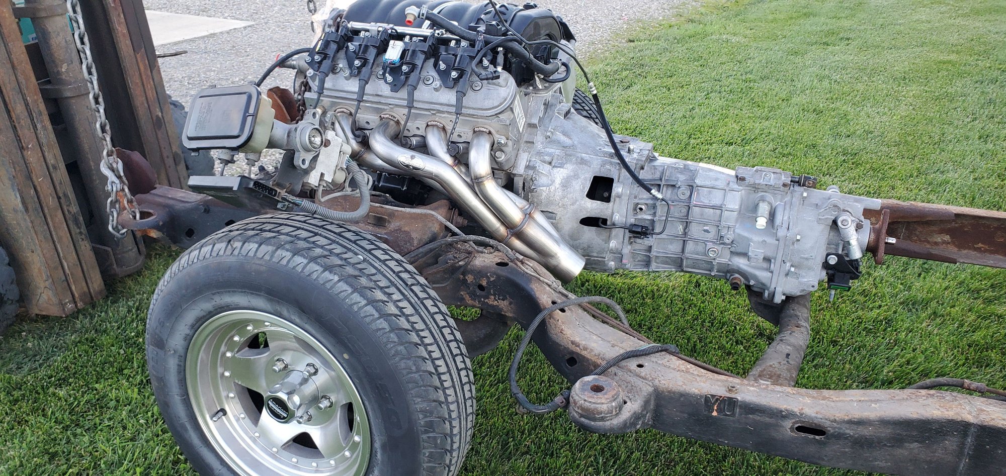

Starting to test fit the engine and trans. Using Hooker 1 7/8 headers mid length. Holley mounts. GM Hot rod oil pan.

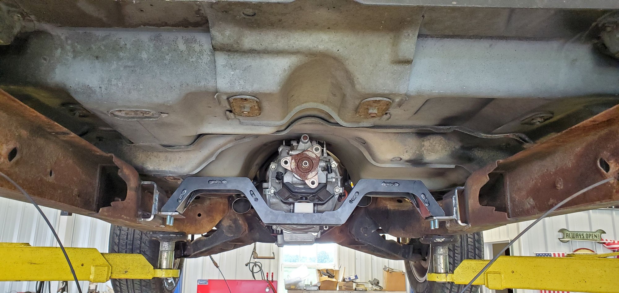

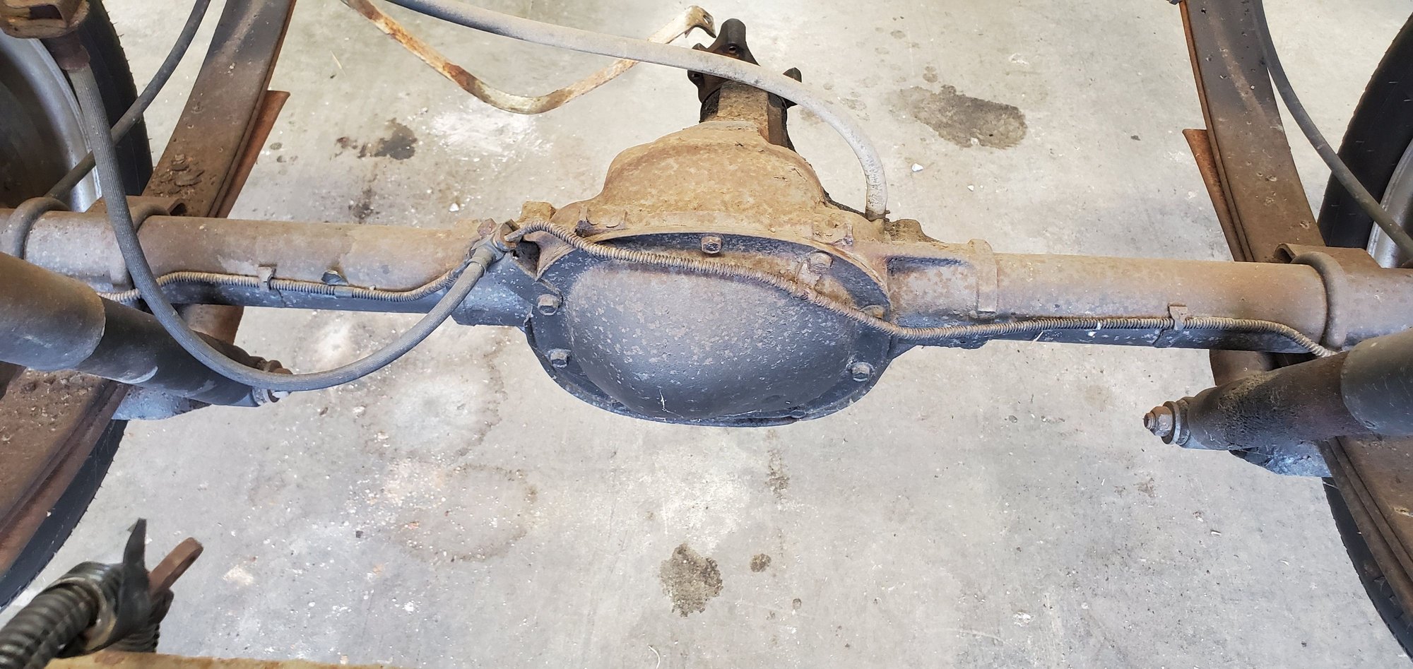

Trans cross member build. Tried to use Holley setup to no luck. Making my own.

Also, planning to use a Ford 9inch rear end with posi. Pics coming.

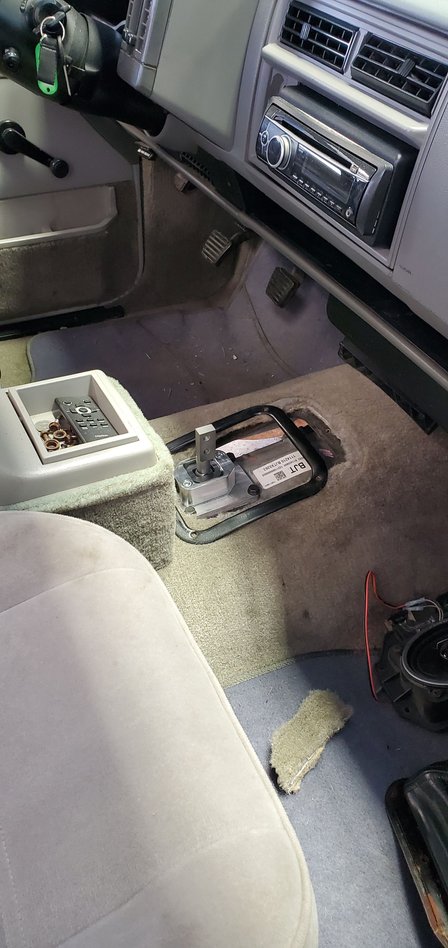

Test fit of the trans cross member setup , including TR6060 shifter setup in cab.
