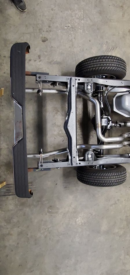

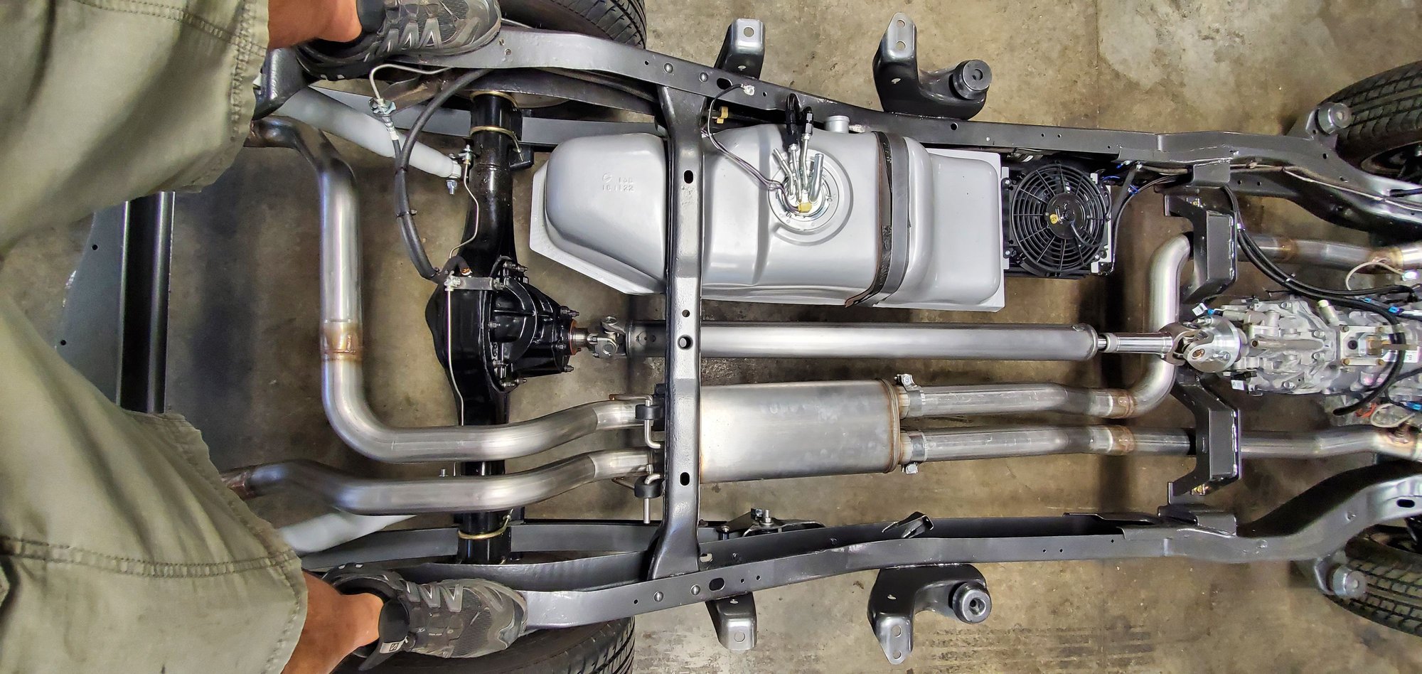

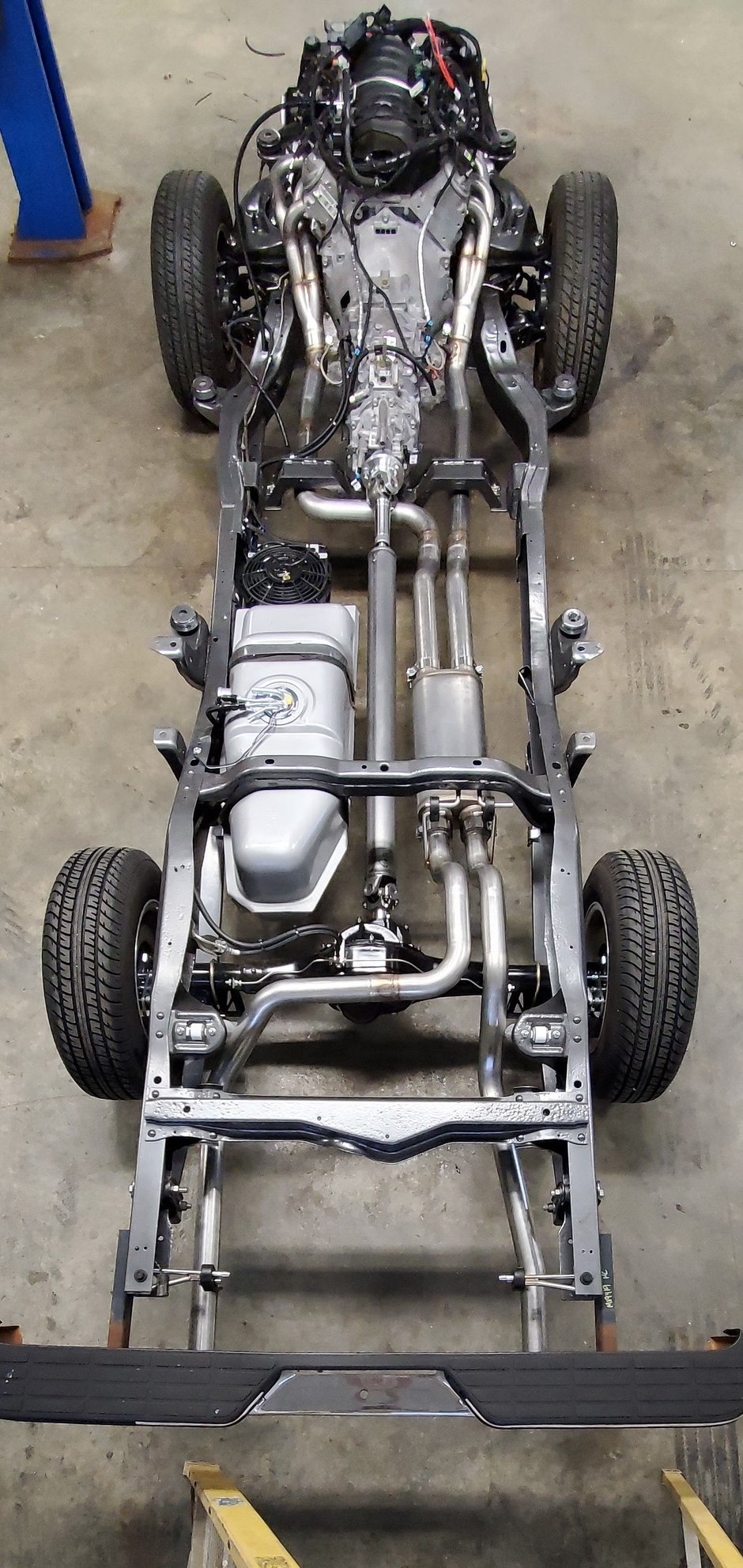

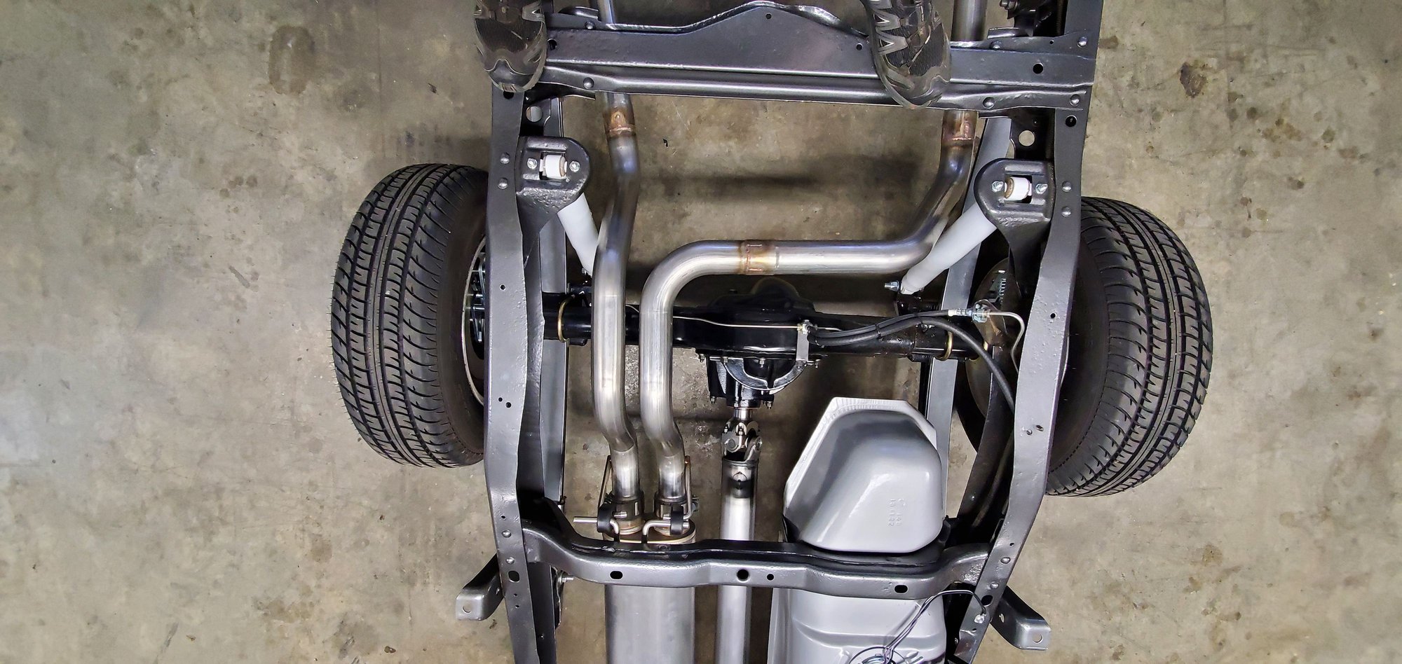

Pics of the chassis from above. Exhaust tig welded. Trans cooler added.

Hello. I'm looking at your driveshaft. my build is similar. what driveshaft did you use?

here is the receipt. Great place. They ship to anywhere. 3.5 inch steel driveshaft. I wanted smaller diameter for extra clearance under truck and strength. I got it home, scruffed it and clear coated the drievshaft. People think it is Aluminum. LOL

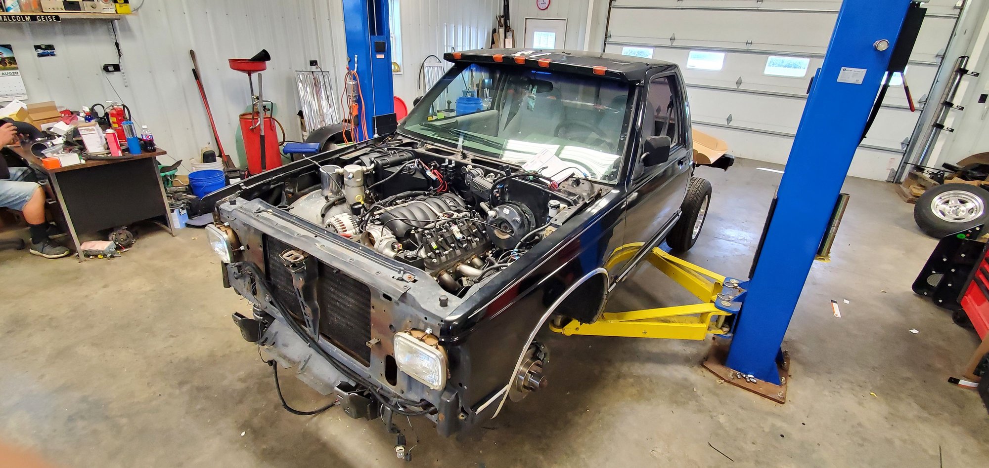

Last pic as it stands today.

Next order of business: drive it this year as is and prep for full body resto for winter of 21/22.

Thanks. Hard to believe, but with relative help, we did this build in 10 weeks. Of course a lot of planning was done prior to the build. My wallet is smoking at this point.
If anyone has questions, feel free to ask. Many things we addressed during the build that was not in the posts.

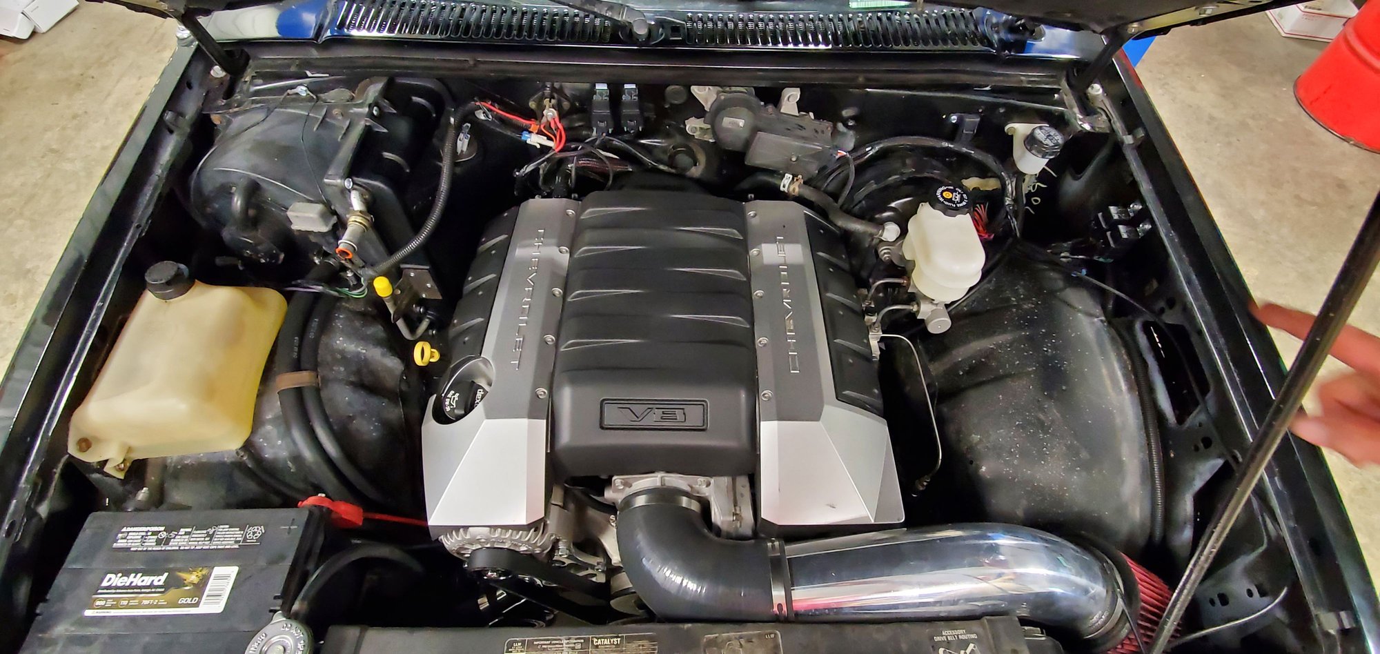

looks great! I like the headers. how well did engine fit up against firewall and heater box?

I used holley motor mounts and headers. Also, holley heater box cover. It is a must to have clearance for the heater box. I wanted a factory look. Some guys cut and mod their heater boxes, but I wanted it to look as if factory made.
Headers were close to the frame on the drivers side, with that I massaged the frame to add in some clearance.
Firewall clearance is about a inch from what I remember... not alot of room lol....
FYI, I have the cab off and on probably 10x to check for clearance etc.

Great appearing engine compartment, just like factory look. I am waiting for your driving impressions, do you have it running yet?

what engine cover is that off of?
Old Mar 19, 2021 | 01:23 PM
  #78
jeremywilliams12's Avatar
Joined: Apr 2020
Posts: 63
Likes: 18
From: Indiana
The engine and trans is from a 2015 Camaro. 6.2L with manual 6 speed.

how did you adapt the driveshaft? looks like one of the sonnax ends?
Old Mar 21, 2021 | 10:20 AM
  #80
Joined: Apr 2020
Posts: 63
Likes: 18
From: Indiana
Yes Sonnax on trans end. Normal ubolt end on 1350. Here is a zoom in of the driveshaft.
