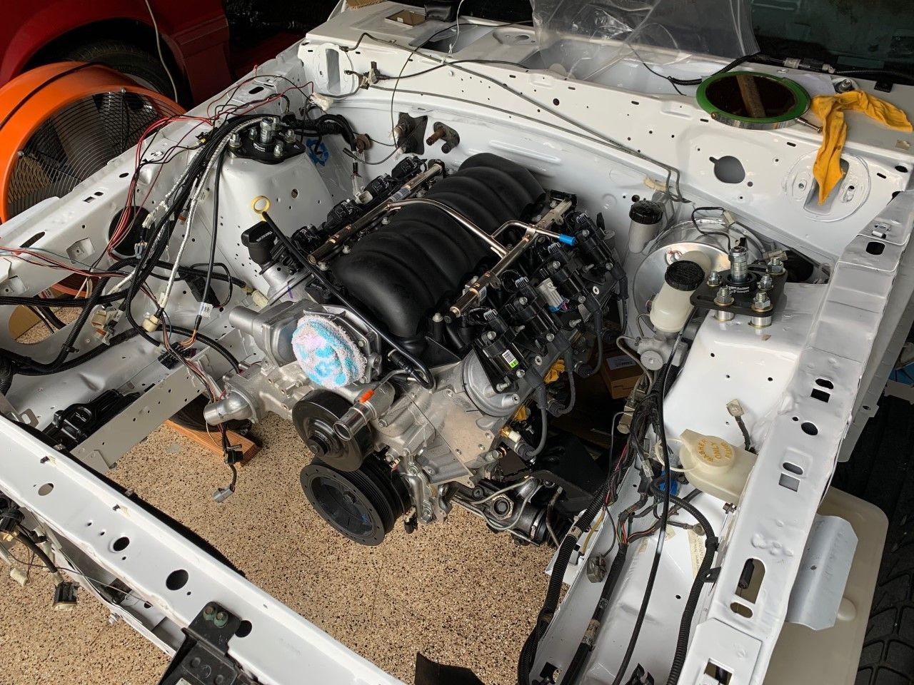

I've got a 1991 Mustang coupe project that I'm working on. It's LS3 swapped with this engine that I purchased from Gandrud Chevrolet Performance Parts 4+ years ago:
LS376/480 495HP Hot Cammed LS3
It is currently selling for $8584.41 as of today, 1/15/2023. Obviously it was less expensive when I purchased it in Dec 2018 but I had determined that it was the best value out of the three LS3 crate motors offered; 430hp, 480hp or 525hp. My engine still hasn't been started so I can't tell you how it runs or anything like that but I've never regretted buying it. If you don't want to deal with used engines or rebuilding an engine and if you can afford it, I think this engine is the way to go.

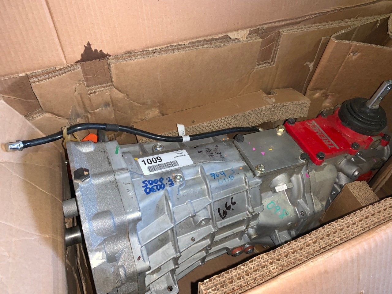

I'm a manual transmission guy so I went with a brand new Tremec T56 Magnum (close ratio version.)
I paid about $3200 3+ years ago for the T56 Magnum.
