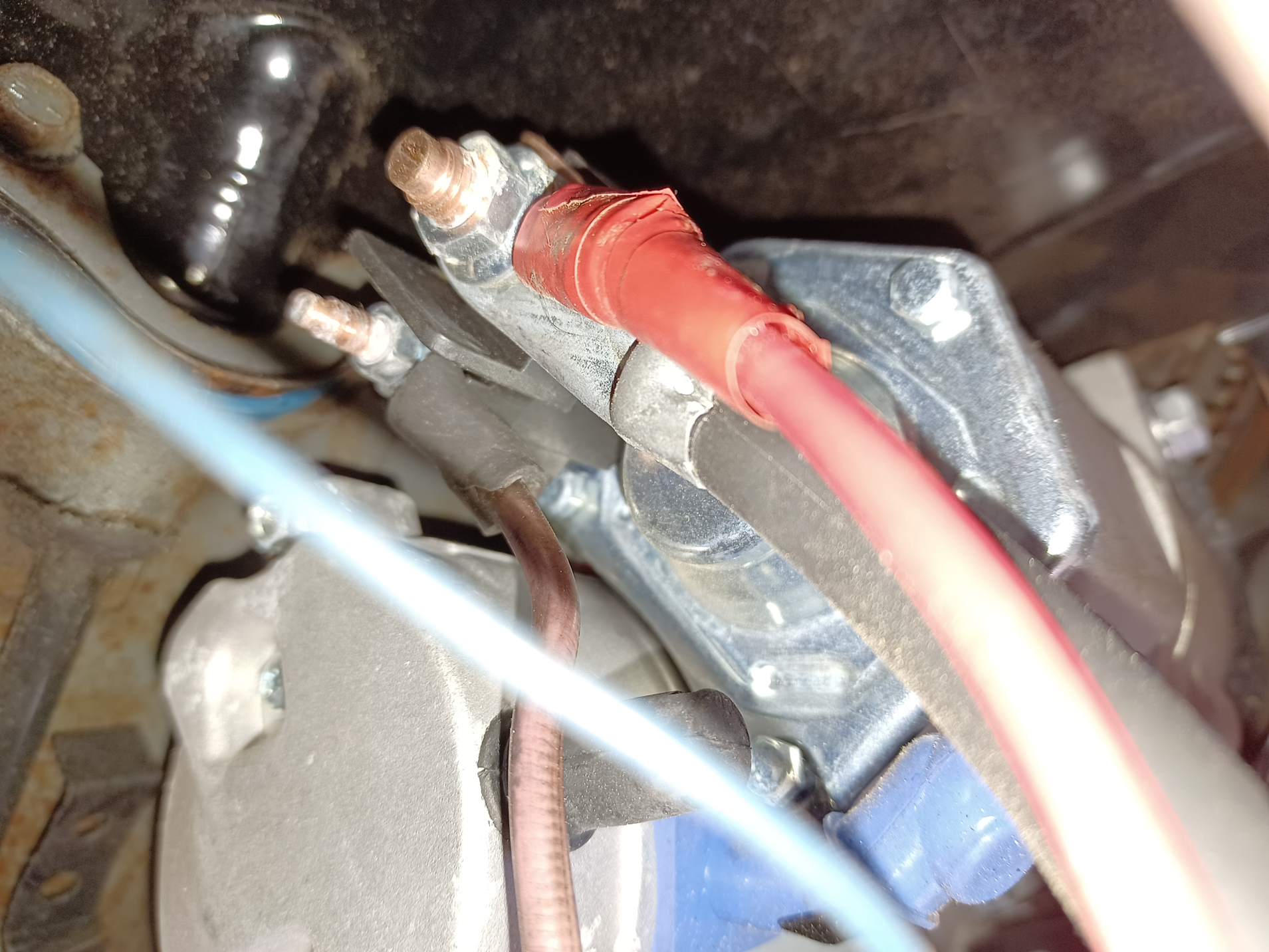

I just converted a 67 Camaro RS to a LS1 engine and i am having a couple wiring issues that may be easy to trace but with my limited experience with this type of conversion I am reaching out to the experts so here goes.
My camaro started life as a california car with a straight 6 with all factory wiring. The LS1 engine came out of a 91 corvette.
The first issue I am trying to solve is turning the engine over. I am starting with a new battery and a new starter (see wiring) . When I turn the key I get the accessory light on the dash but nothing is happening at the starter.
I have 12 volts at the battery terminal on the starter. I have no voltage at the brown/purple wire at the solenoid when the key is turned.

After searching the many posts on this message board I found the issue was the neutral lock out under the dash. The engine will crank now but doesn't turn over. The 1991 Corvette LS1 I purchased ran before it was taken out of the car, the guy I purchased it from sent a video. The wiring harness came with the engine and I sent the wiring harness to a guy who specializes in this type of conversion. He set up the ECM and harness for my 67 camaro and sent it back. I installed it according to the instructions that came with the conversion. I am presently going through the process of checking voltage to the HEI coil and to the optispark. I have a pink/blk wire at the HEI coil with 12 volts but there are 3 other wires (pic). I don't have a tach so the white wire should not have voltage but should the other two wires have voltage? I will be checking today.

To get back to your question, you need to figure out where the break in the line is for the starting circuit. I assume the 67 is an auto car and has the column mounted P/neutral switch. Either this is unplugged or not properly aligned. To test, you can simply bridge the two 12ga wires and bump the key again
Manual 67-68 cars do not have a clutch safety switch, so there's nothing between the IGN cyl and the starter. 69's do have one, and again it's a two wire 12ga switch. Bridge and bump the key to test
If it's not that, then there's chicanery somewhere in the system. I'd recommend rewiring the whole car as 55 y/o wiring isn't the safest
