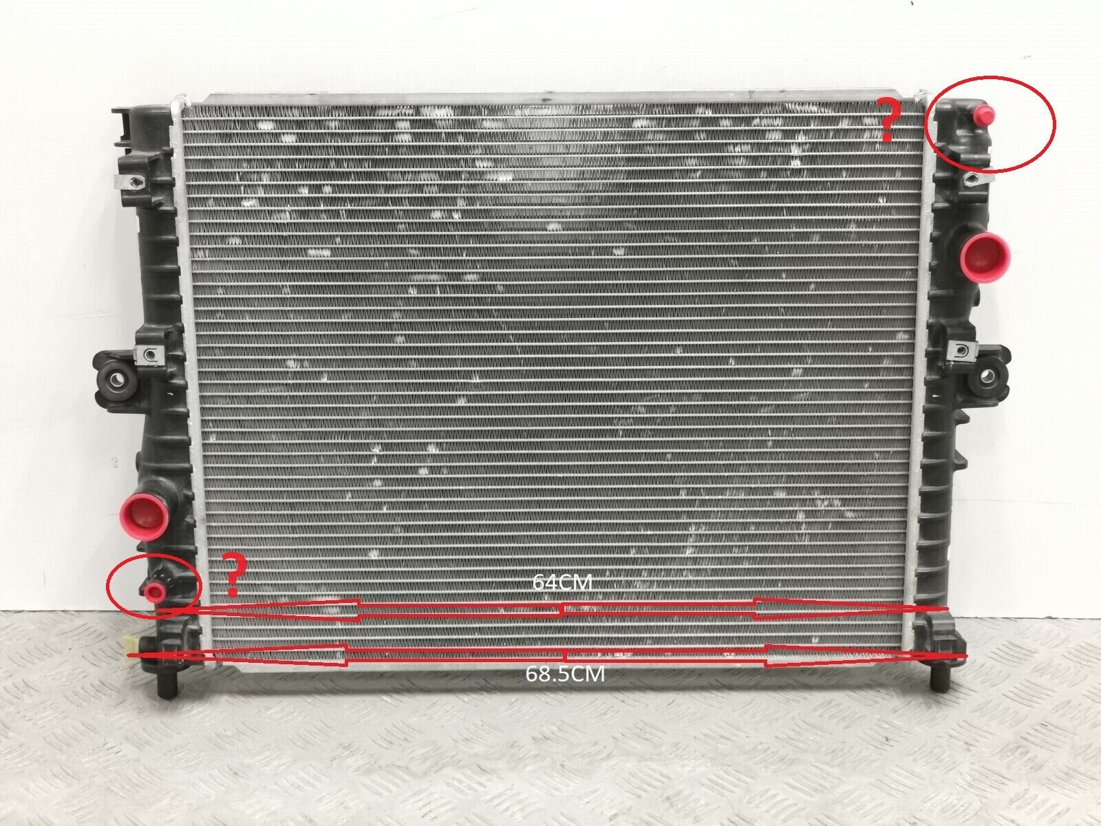

I have the hoses on left and right side.
Attached a picture.
i think that on the lower left is the "steam" tube from the heads and on top right is to reservoir, left big in and right low out.

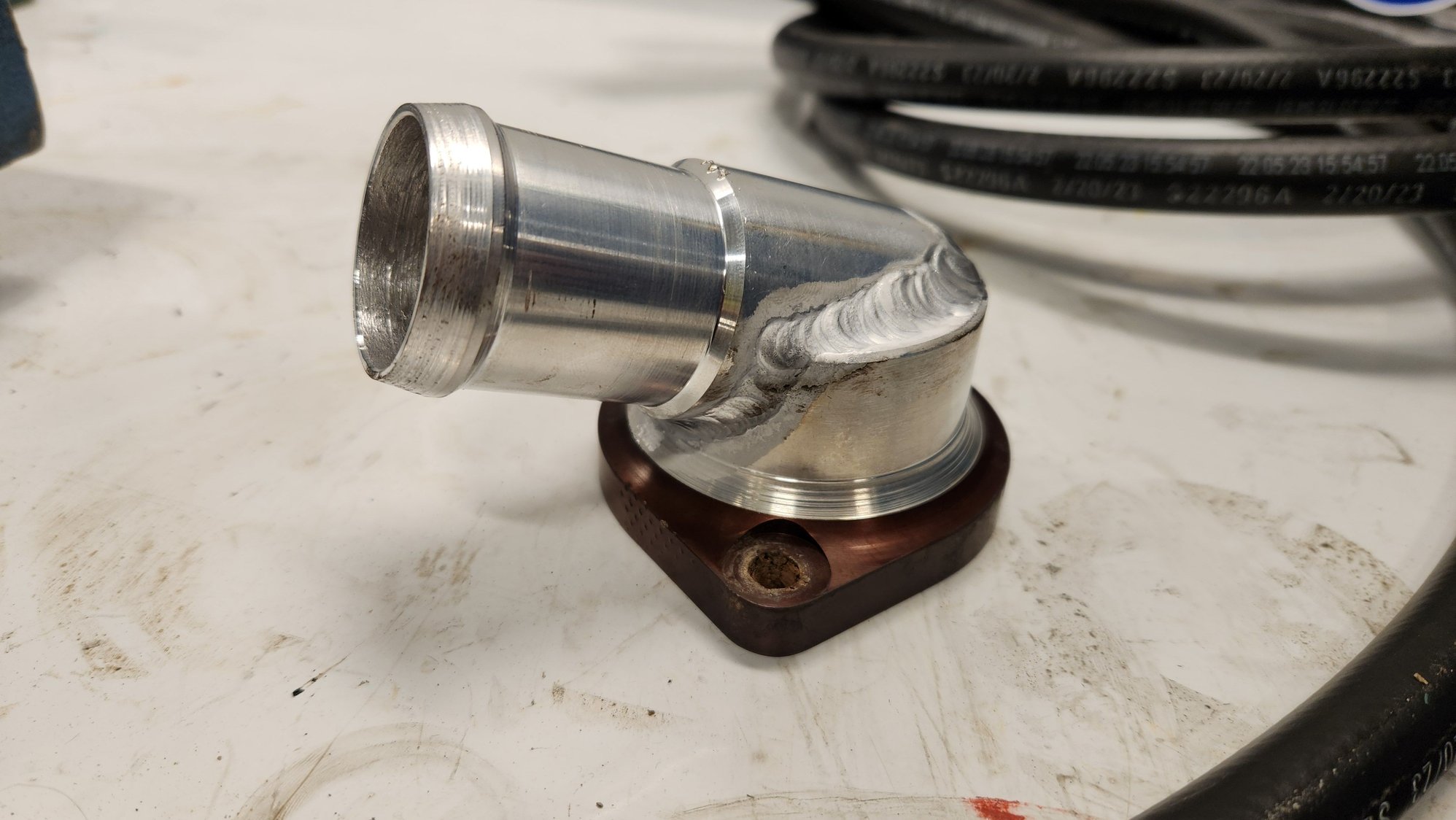

Hello ,
It ended up with a C7 lower hose cut just a little bit and a homemade thermostat housing
Some grinding and paint on the housing and it is ready to go.
