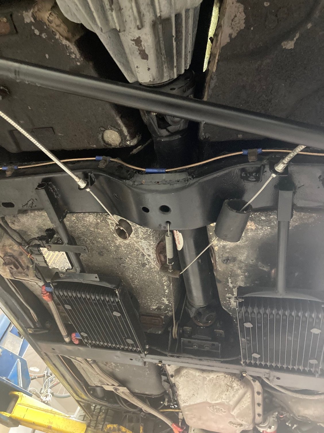

For my C3, LQ4 turbo, 4L80e intall, I went with a 3" chromolly driveshaft. I use the long (not stubby) end for the 4L80e because I have a solid axle that moves rather than the fixed location of stock C3 rear ends.
This setup is good for !000HP. I'm running over 700 at this time. I can take a picture from under the car to let you see the fit if you want.

Can that driveshaft be removed from the bottom? I see that you do not have a two-piece yoke at the front.
Andrew
Yes, it can be removed. Remove the 4 bolts at the rear end pumpkin, move it to down (may need to jack the rear some to make more clearance), then the yoke simply slides out of the transmission.
