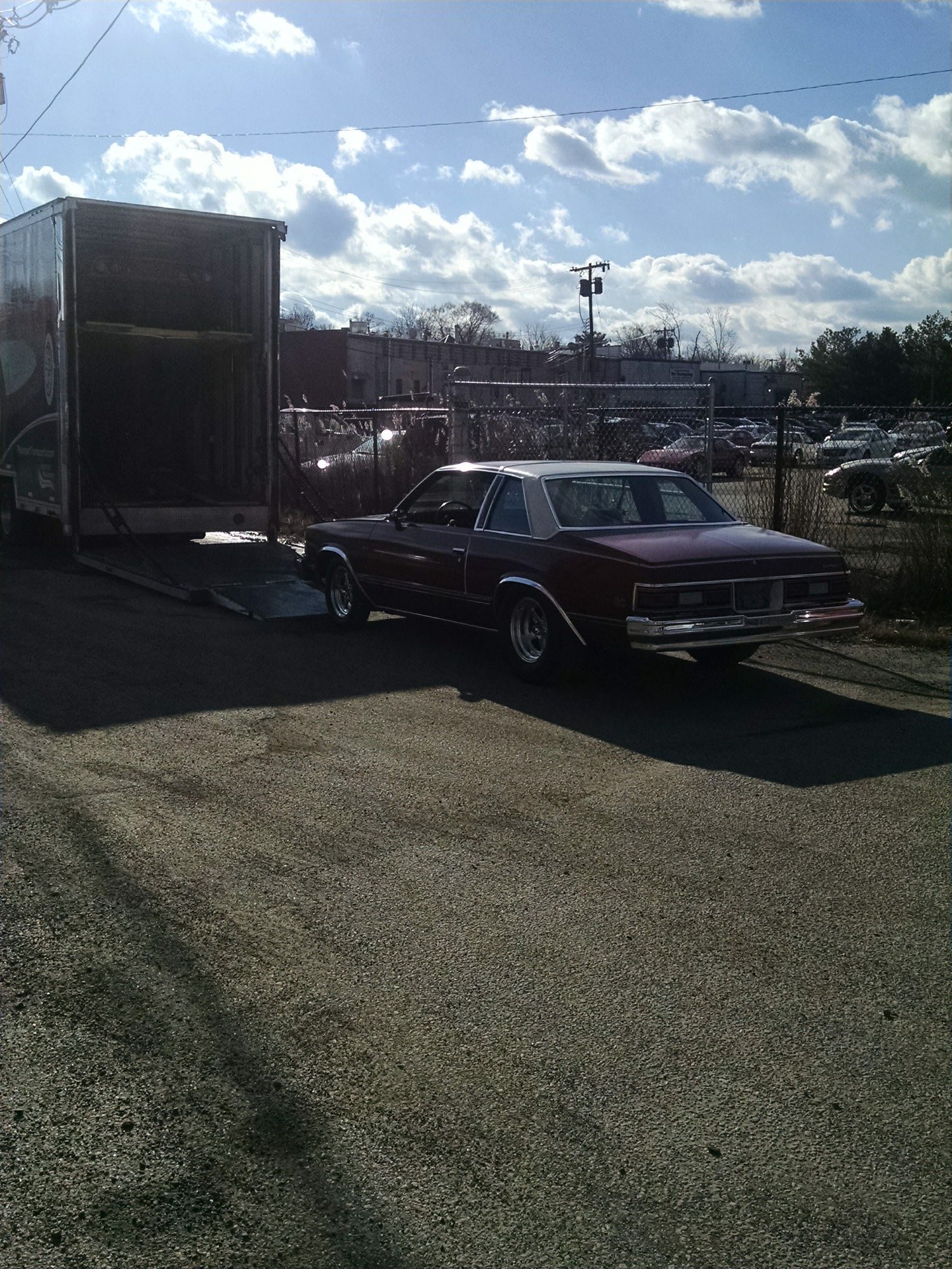

well i ended up getting engaged, i had this car and my 81 mustang and couldn't keep both because we planned to move from NJ to NC so i sold it in 2015 to a guy in Wisconsin thinking id never see it again. fast forward 10 years and i made a post on a whim to the gbody page seeing if it was still around, about 30 minutes later i was talking to the owner! i text my wife and she tells me i had to buy it back (which ended up taking about 5 months to make happen)

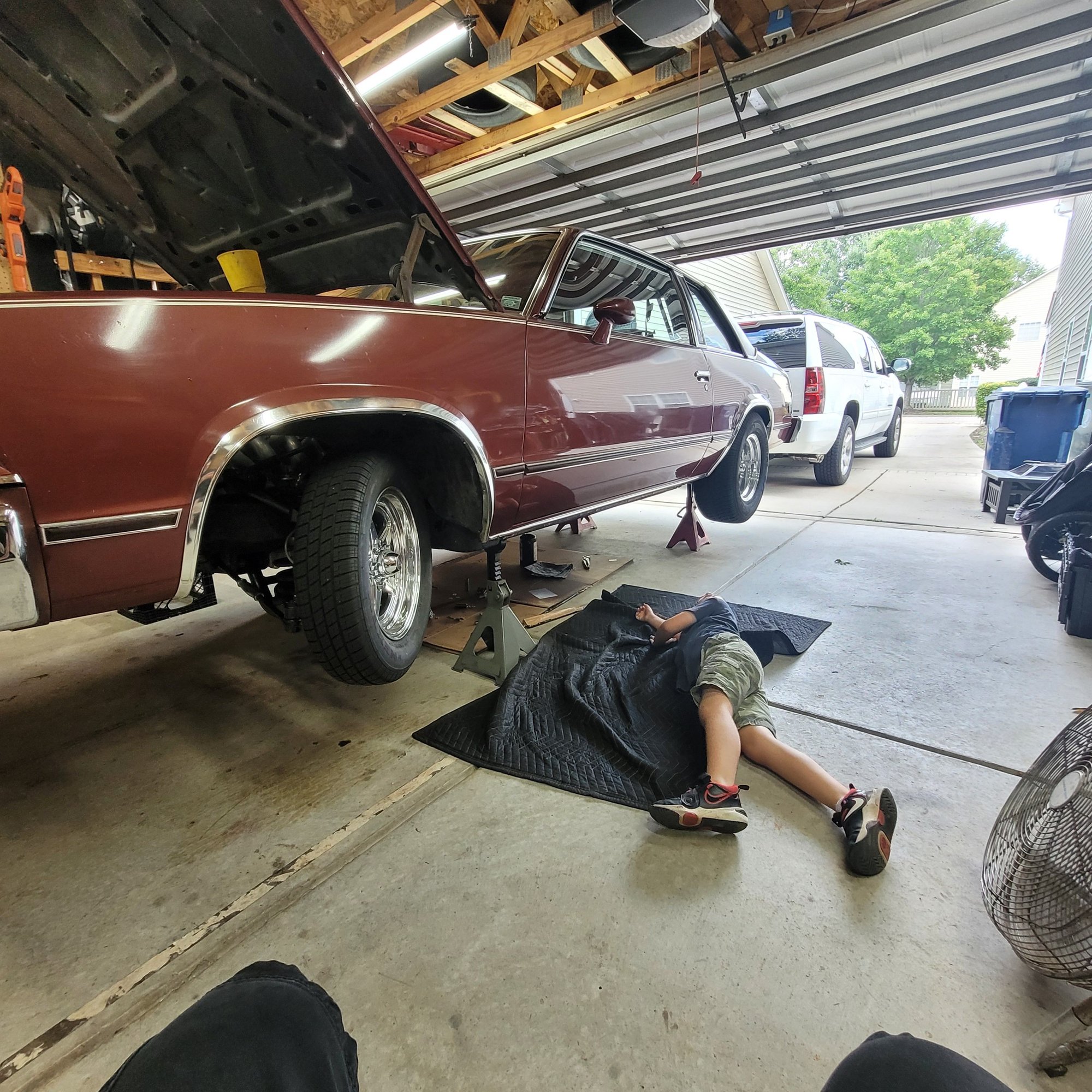

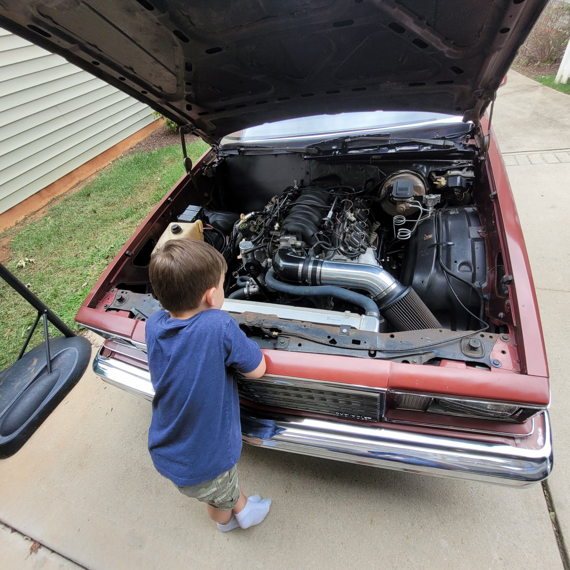

so in may of 2024, it arrived from wisconsin on a transport truck. i drove it back and forth to work, picked my kids up from school and did a few small maintenance things with my son on it. the whole reason i bought it back was to have something a little more family friendly to do stuff with my kids and as a family.

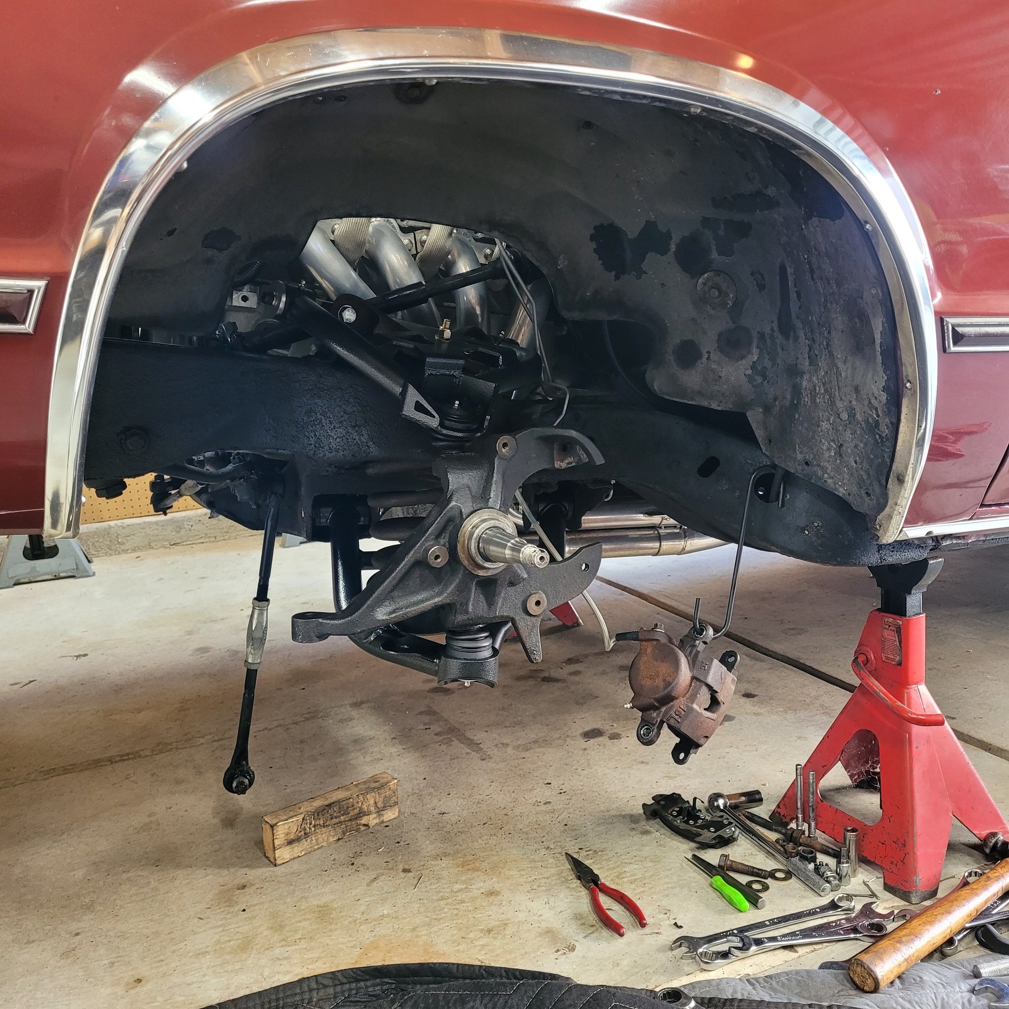

so last weekend i started taking apart a perfectly good running car to do some upgrades. i had been saving up some parts and figured it was time to get going. this car is exactly the way i sold it in 2015 - nothing had been changed, nothing broke, its pretty wild! Phase 1 is to get heat and ac back in it, convert it to a holley setup for engine management and put in a 4L80 trans. i also have an LQ4 6.0 for it that may go in now in place of the LS1 (which is for sale lol) with plans of a power adder later on. so heres some pictures and ill do my best to share what ive learned and what i do as i go. ive also been tinkering with a TIG machine hoping to improve my skills as time allows.

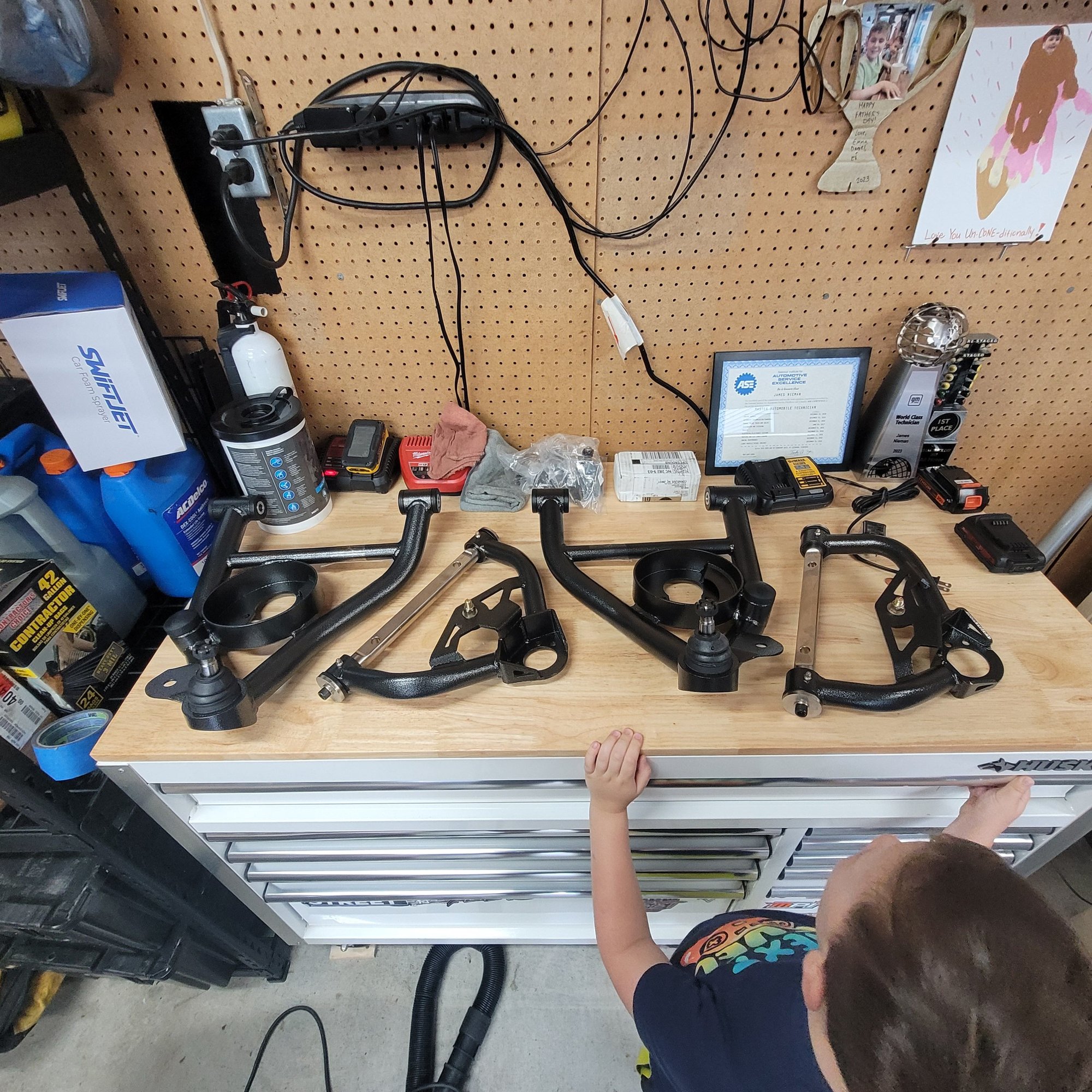

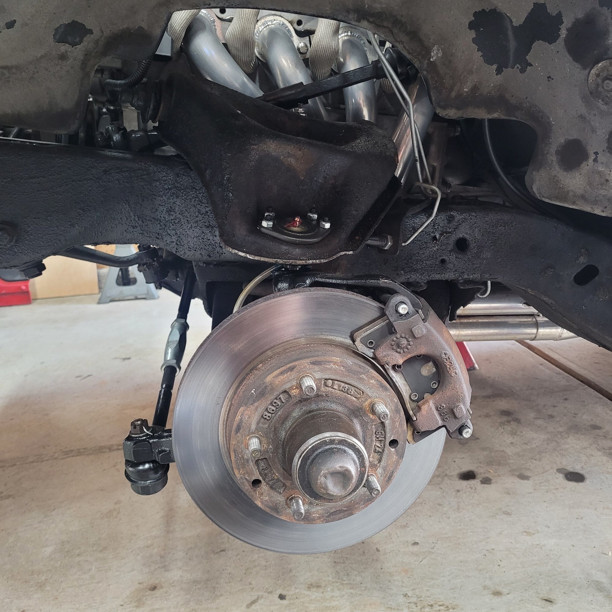

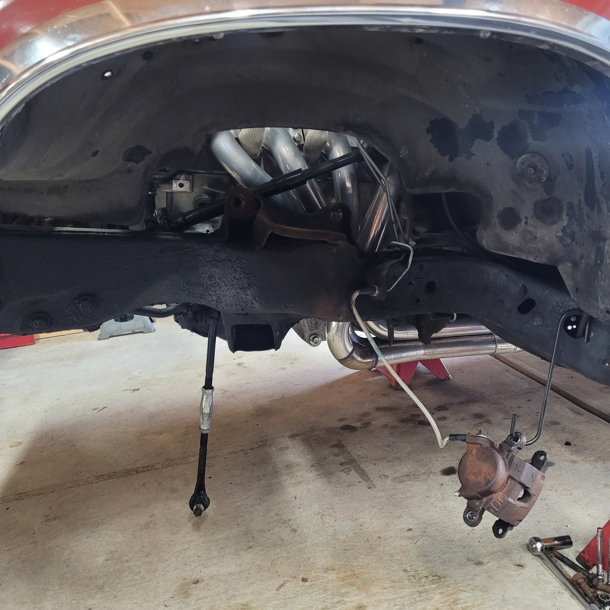

when i got it back it had the same tires i sold it with lol so i swapped on some fresh ebay front runners and regular street tire for the rear. also changed out the stock front suspension for some BMR stuff.

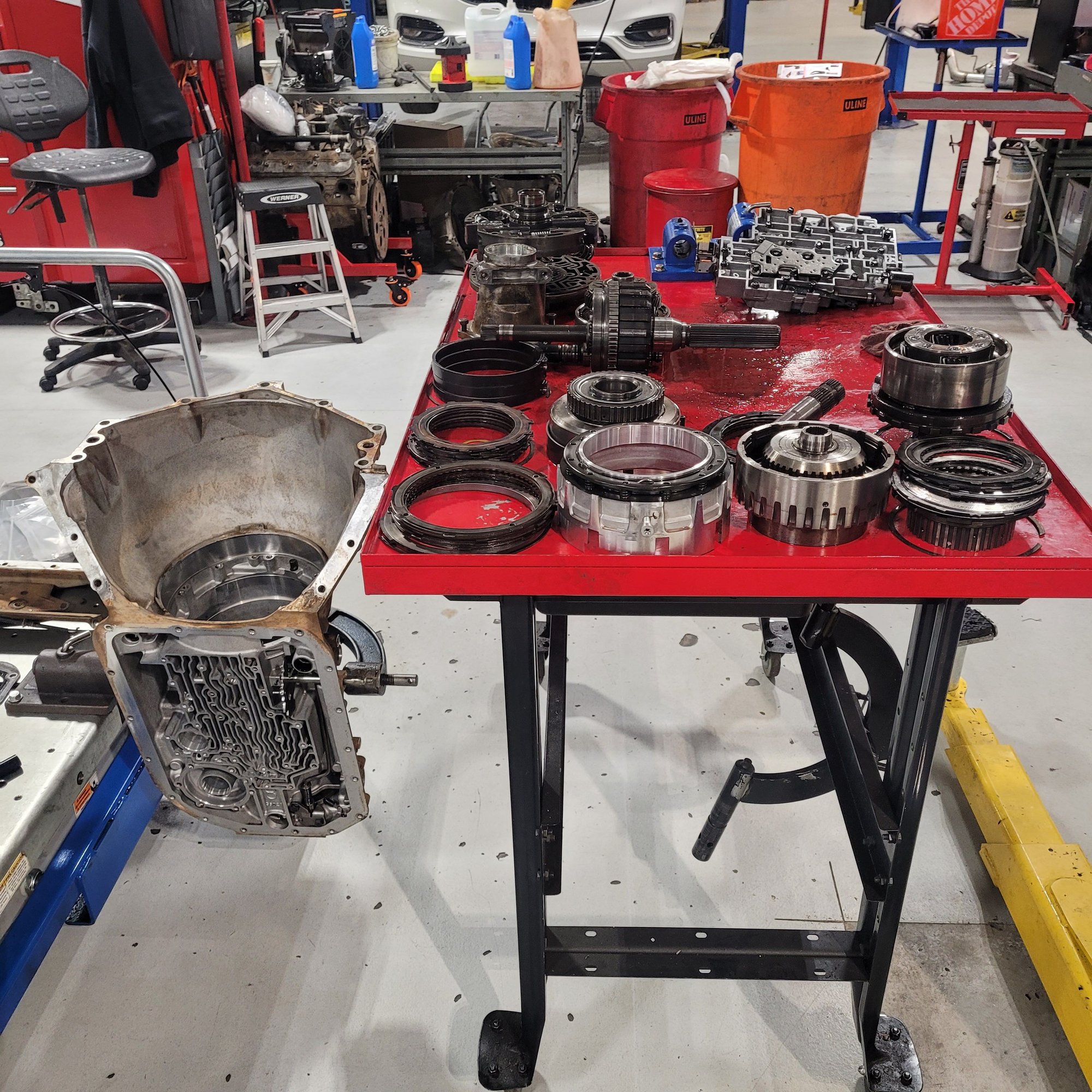

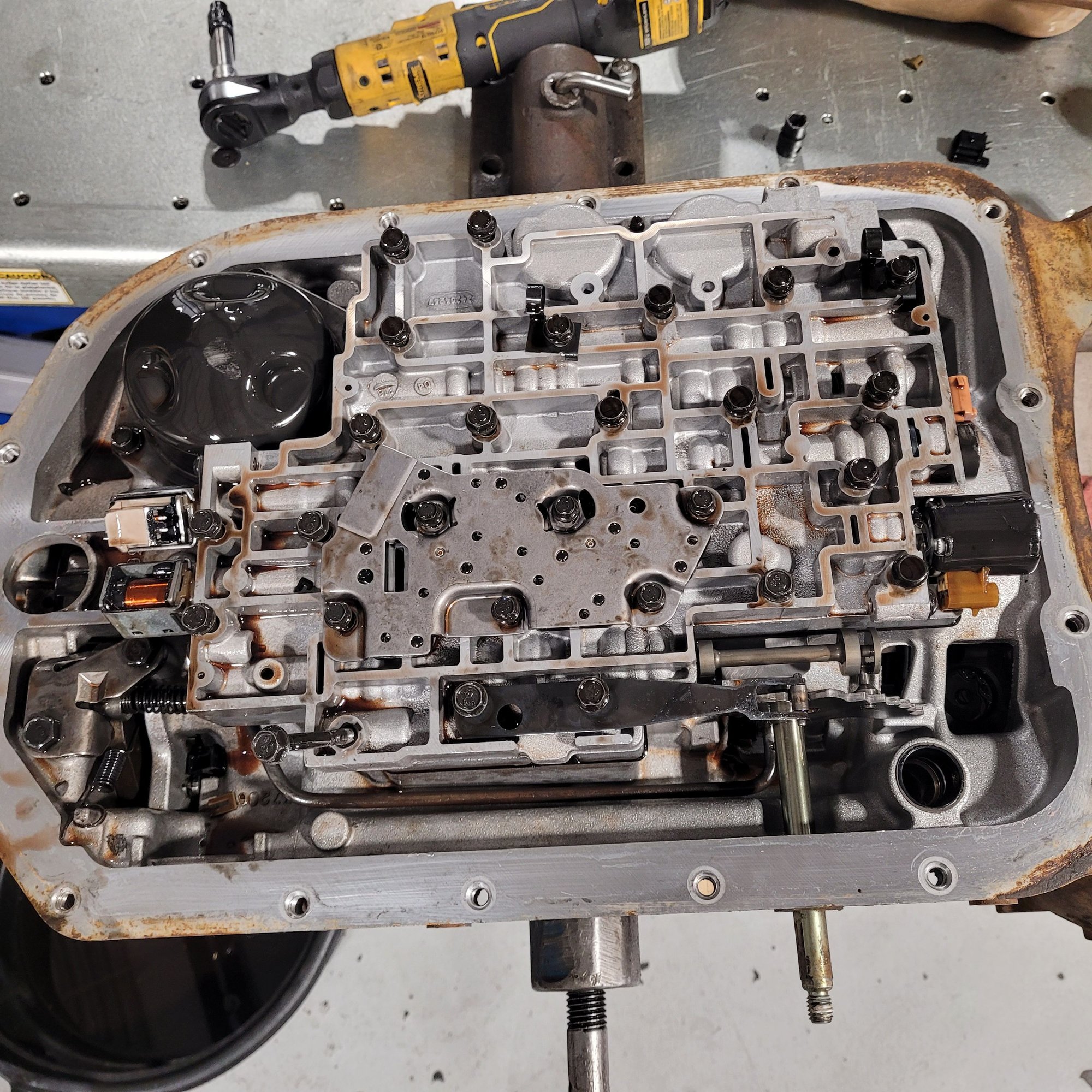

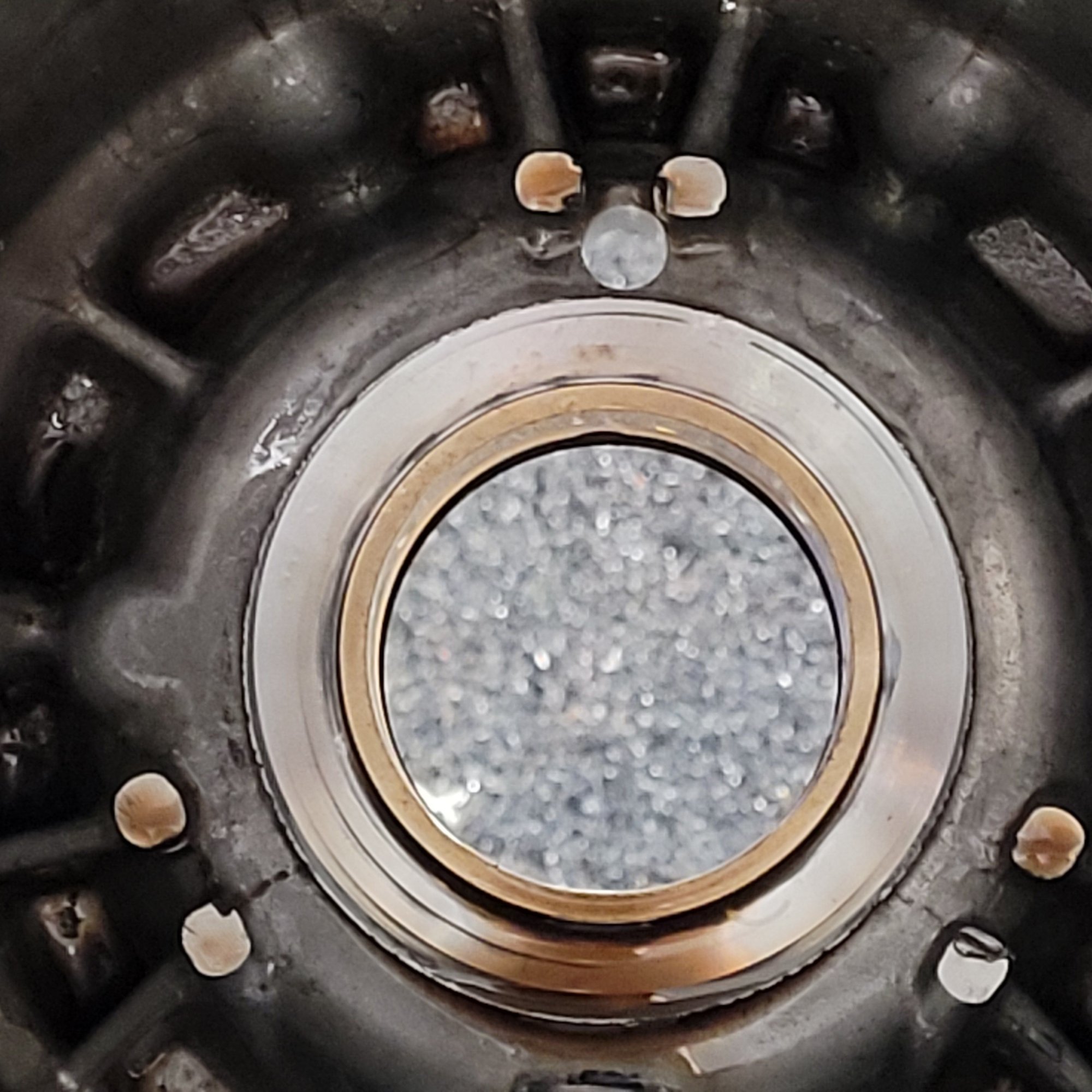

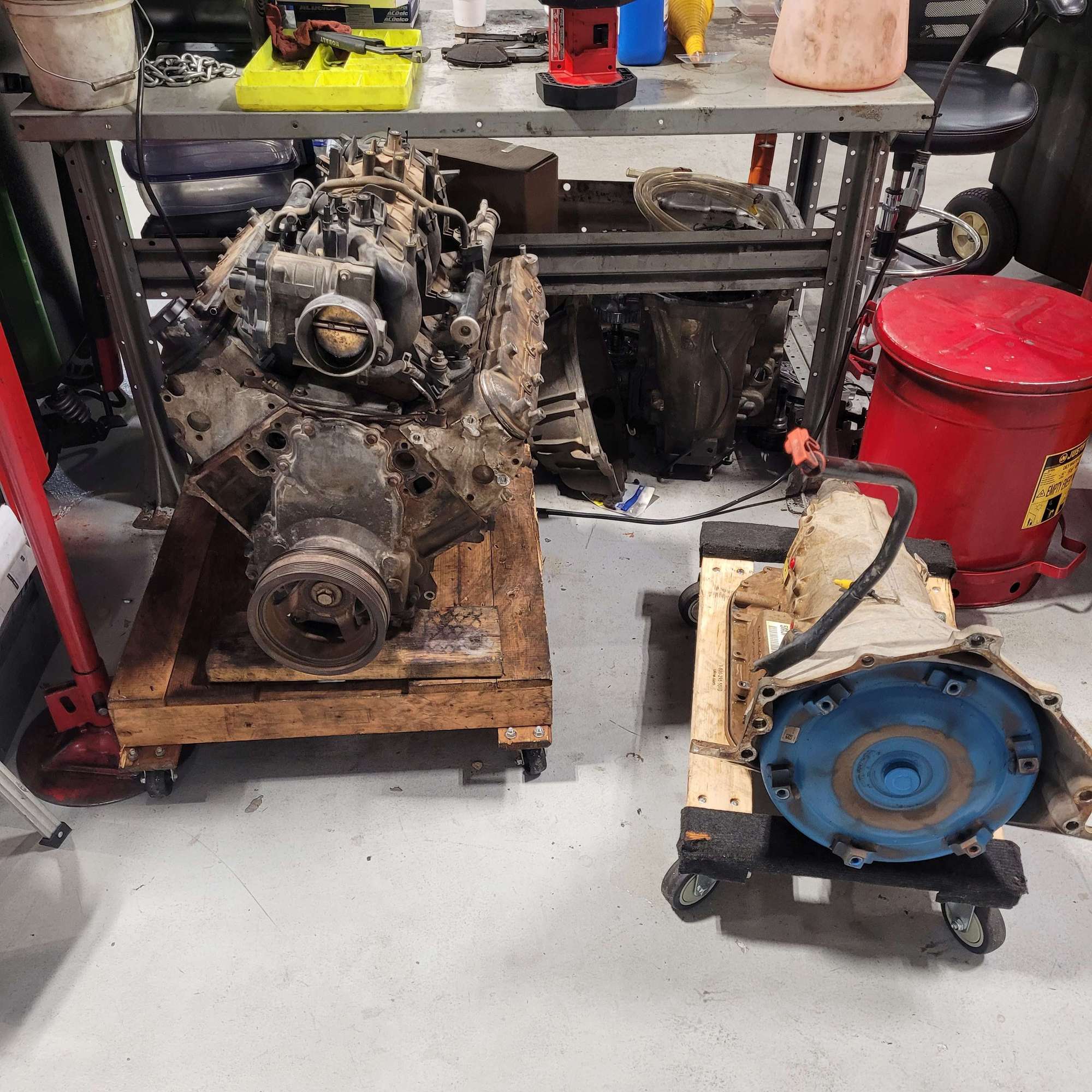

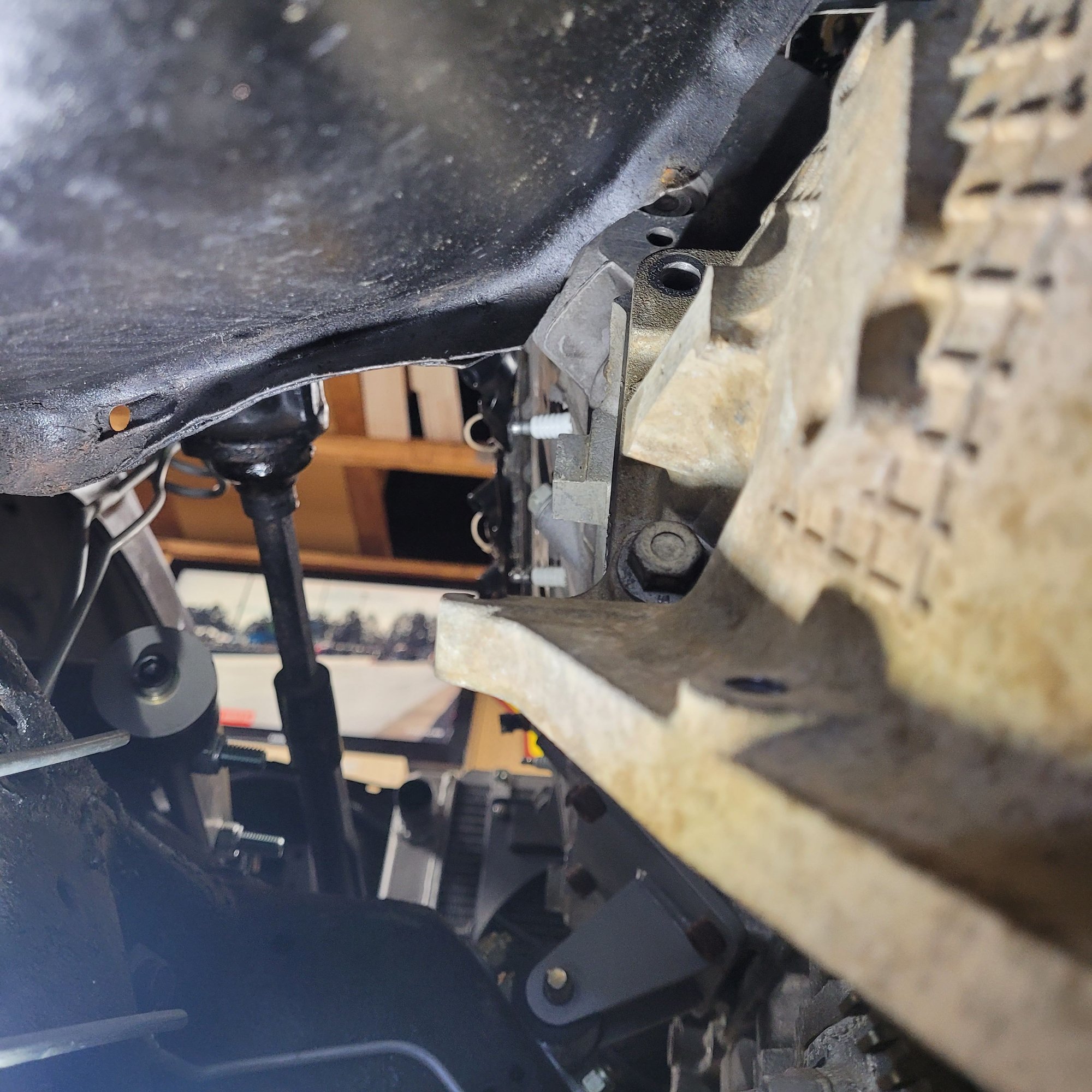

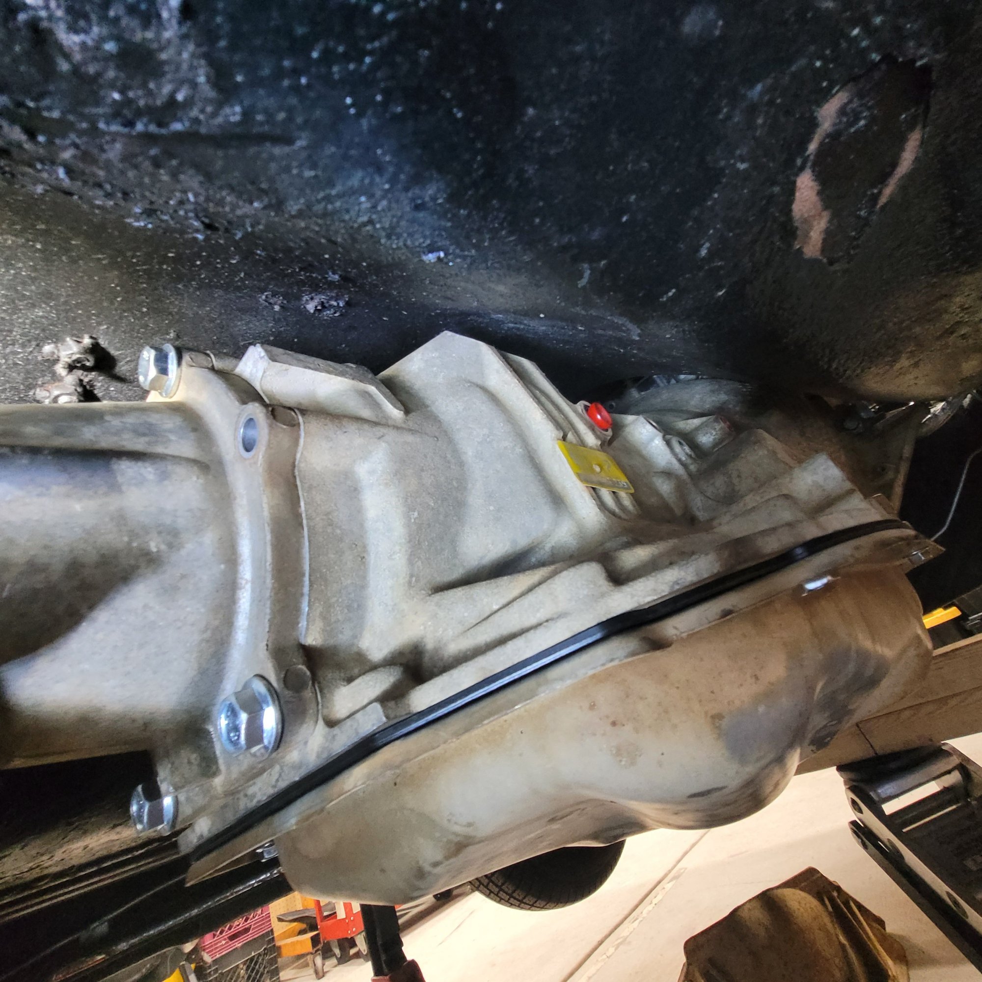

finally got around to separating my LQ4 and 4L80 last week and tore down the trans to inspect it. definately was rebuilt before (truck this stuff came out of had 300k on it) converter has a tag from 2017, along with a few other things (no walk case bushing, and direct drum looking almost new).
im going to take the empty case and stick it in the car this weekend and make sure it fits (i know tons of people have done this but i dont want any suprises). id also like to see if my current transmission crossmember will work or if ill need to get a new one.

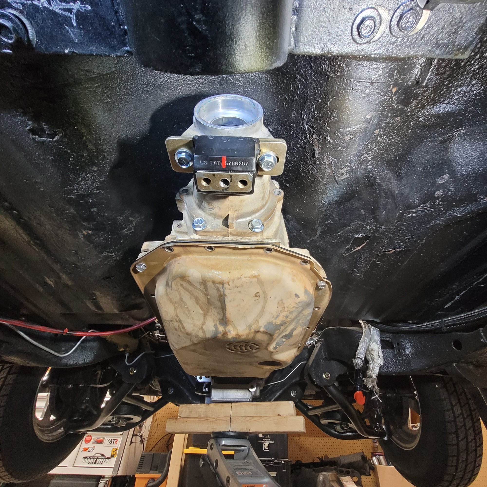

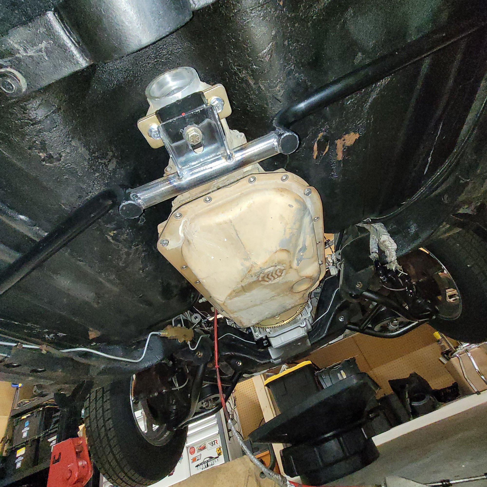

Was able to get the 4L80 case up in place tonight, crossmember wont work (which i was 99% sure it wouldnt) so ill have to get one coming.

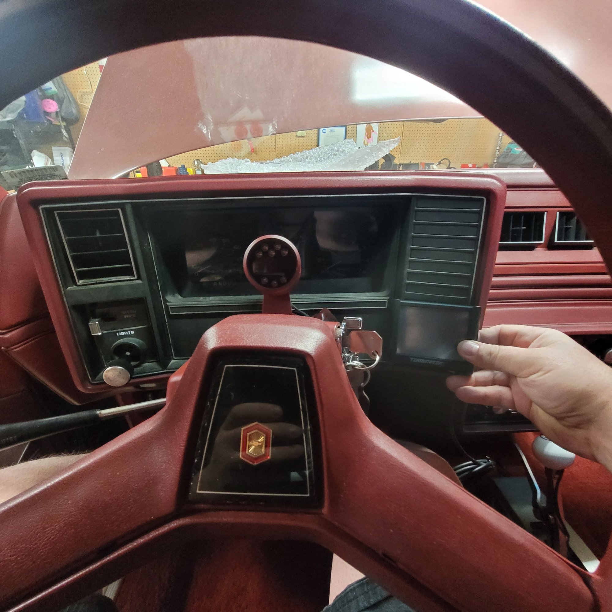

also started trying to brainstorm where to put the terminator x screen. Not sure i want it in the cluster so im leaning toward the bottom right corner

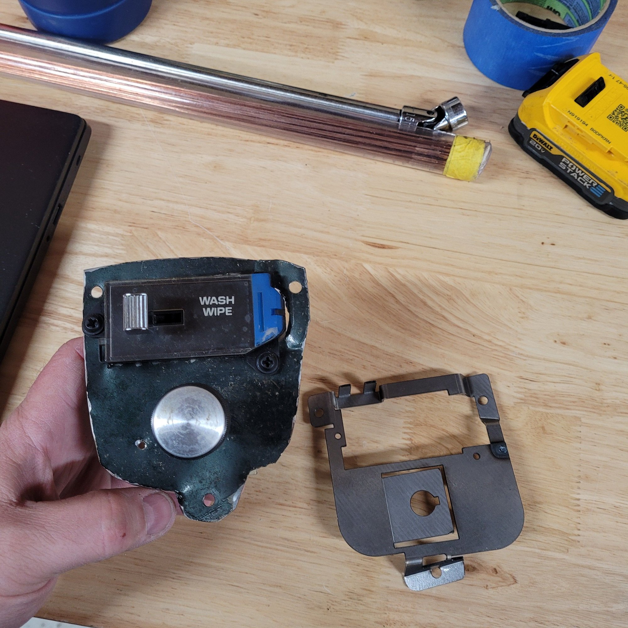

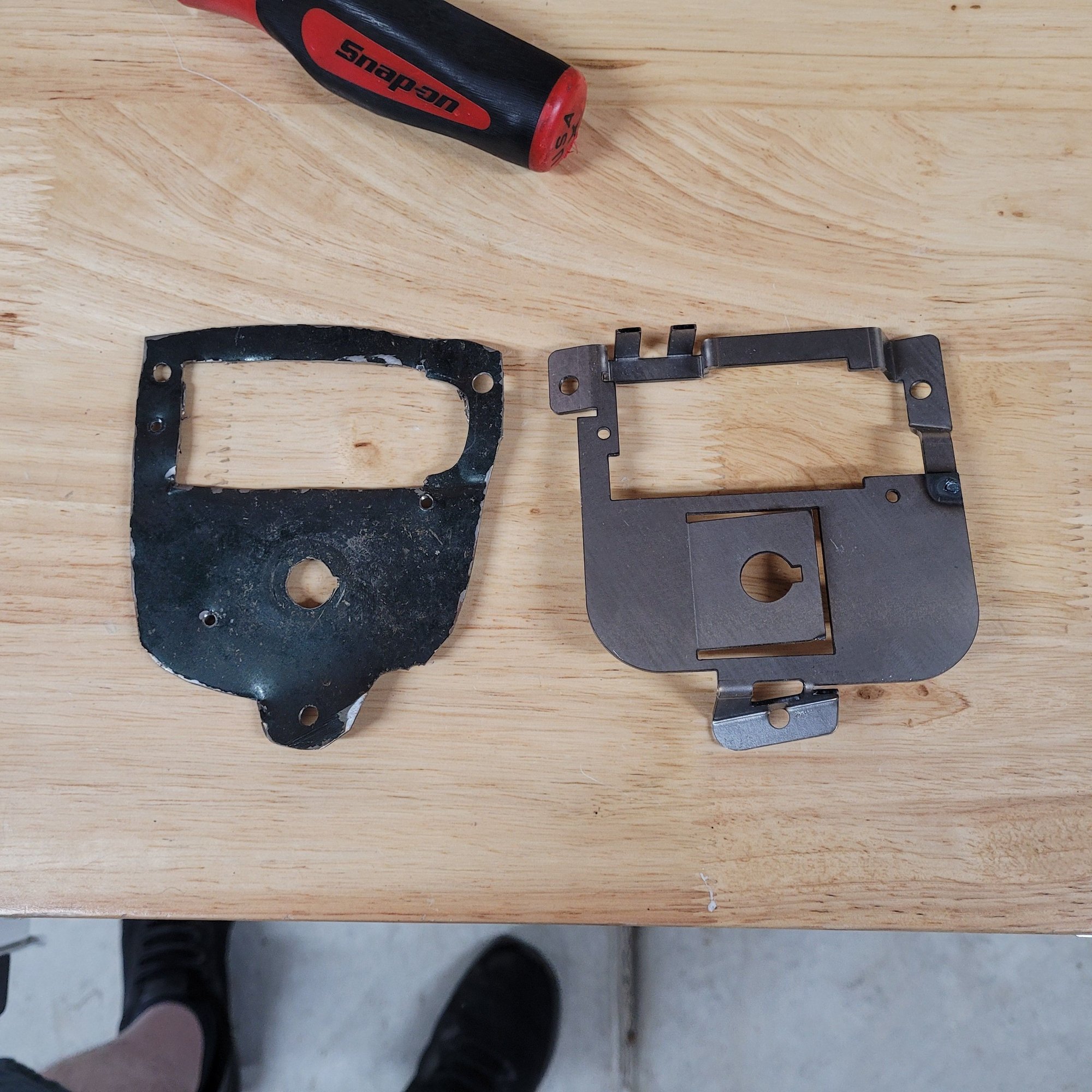

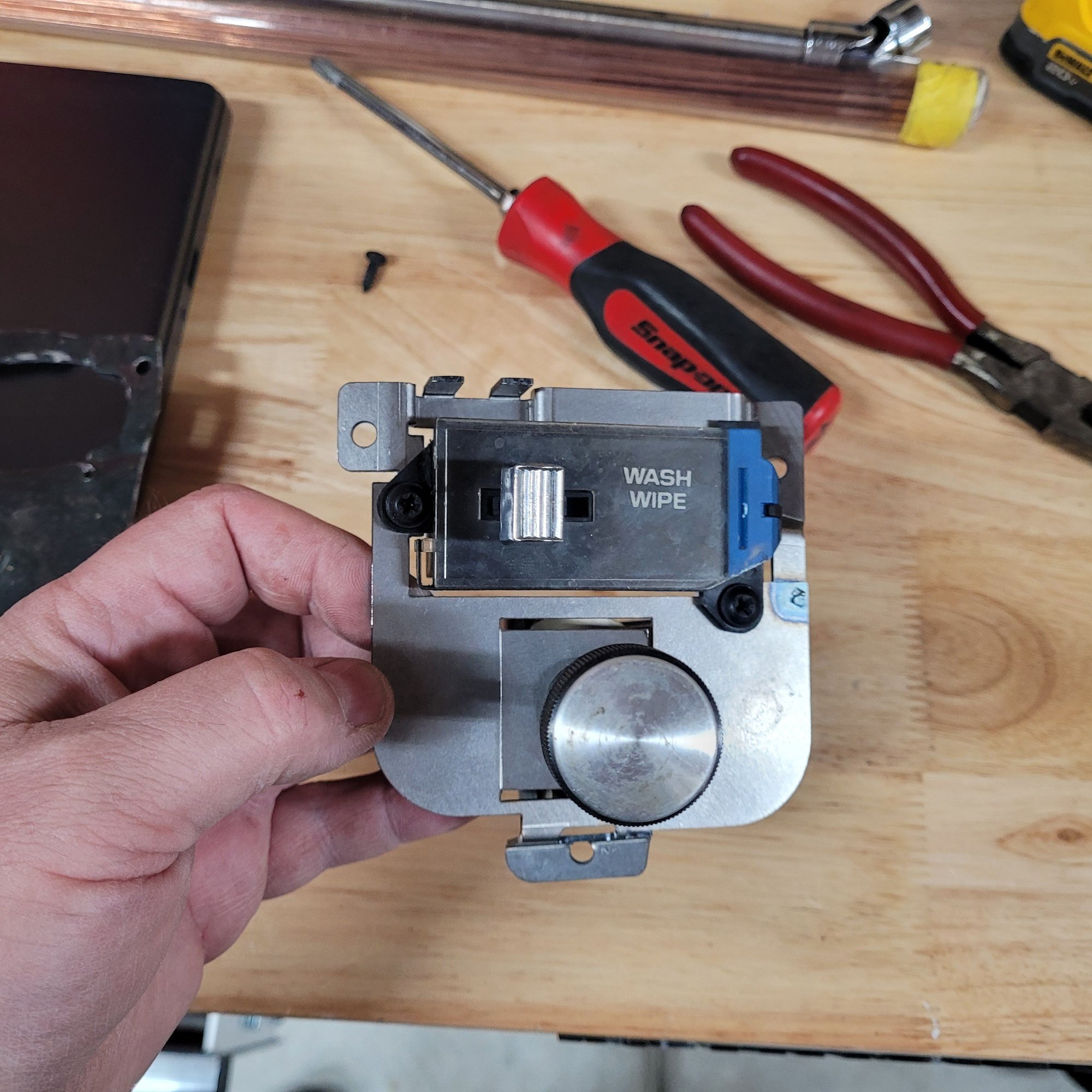

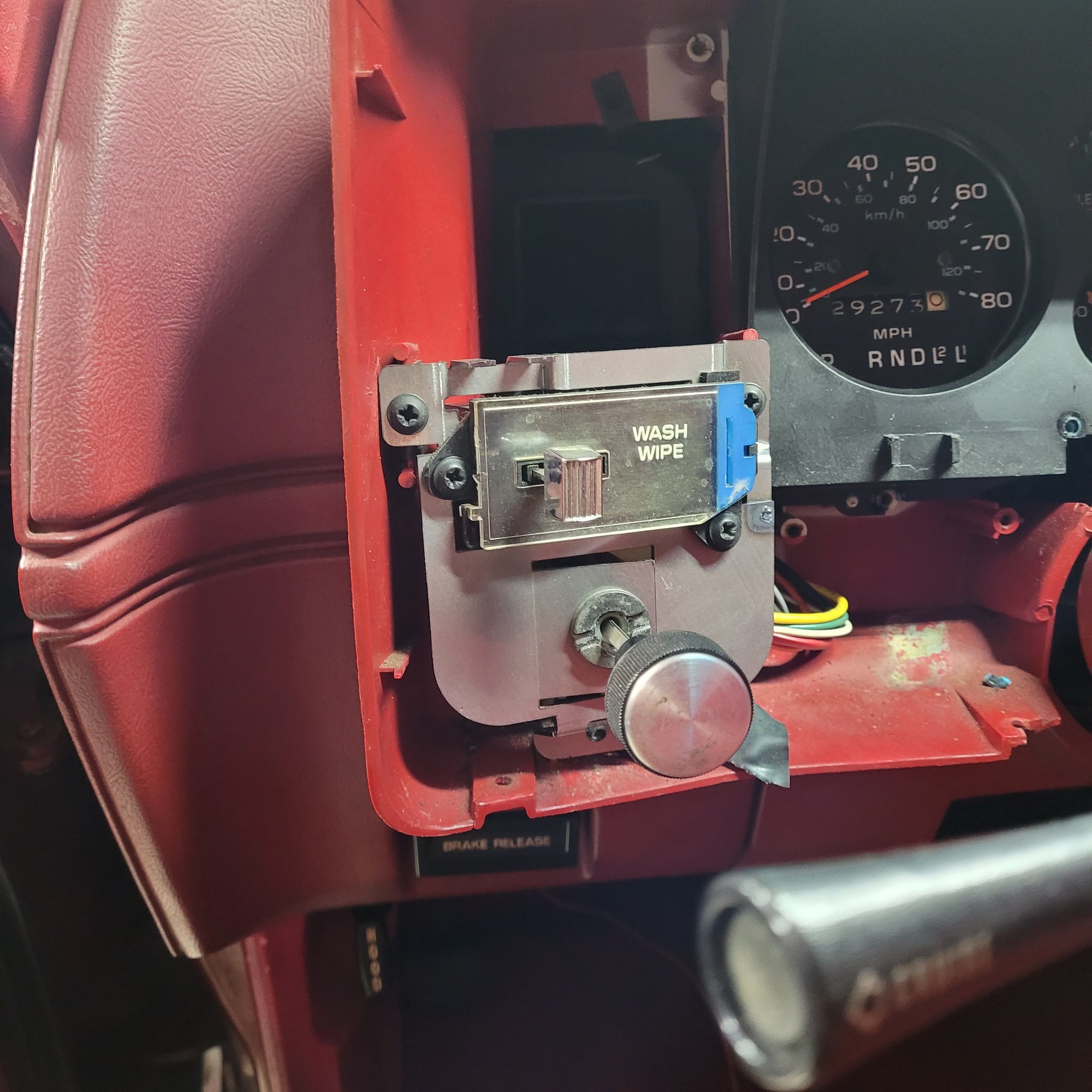

Another side note: pretty wild whats available for these cars now. This home made headlight switch bracket was in the car when i bought it 10 years ago and i always thought it was janky, well dixie resto sells a new one lol

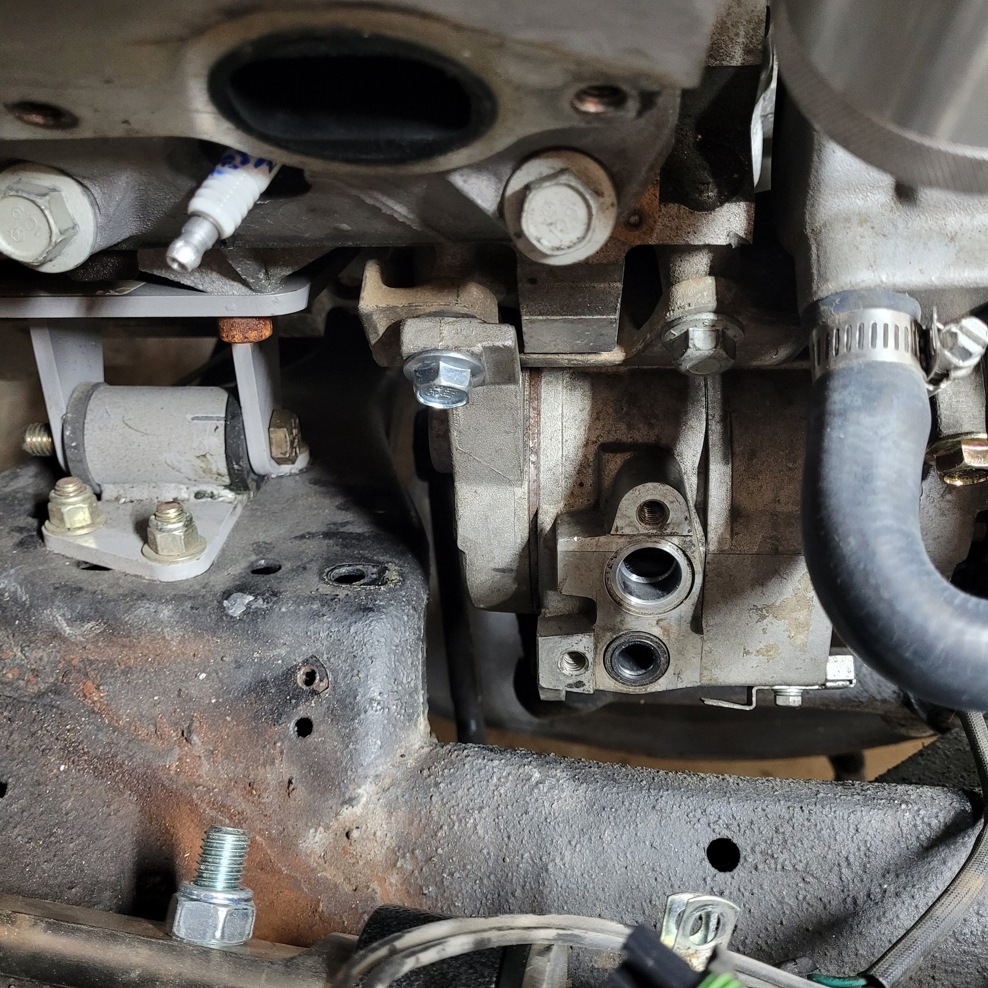

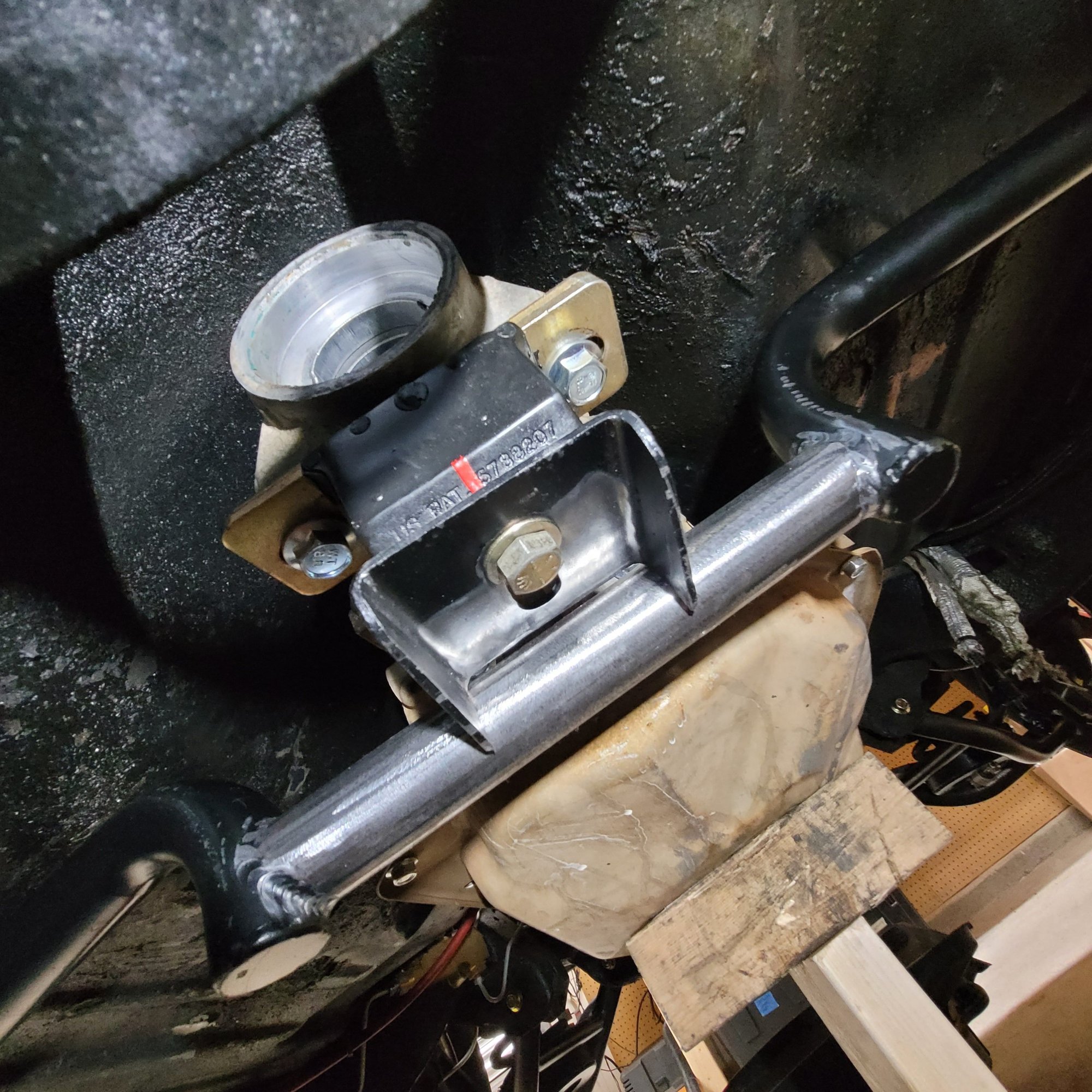

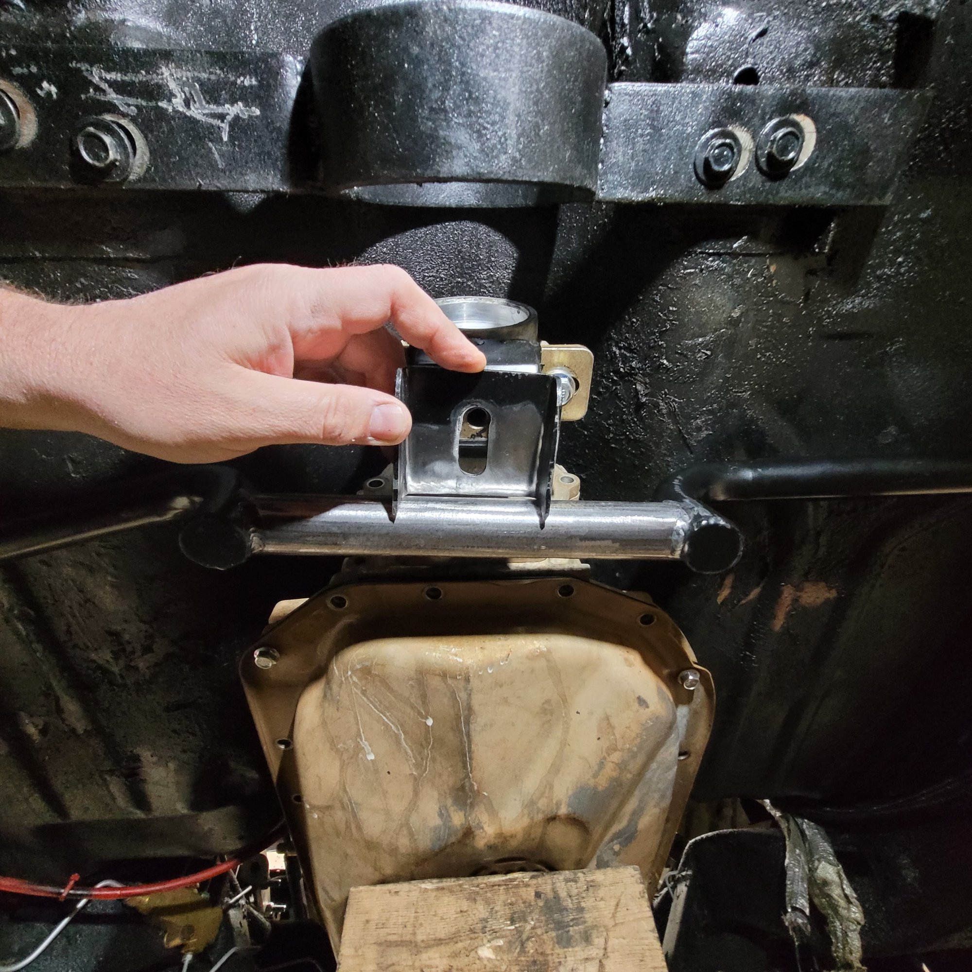

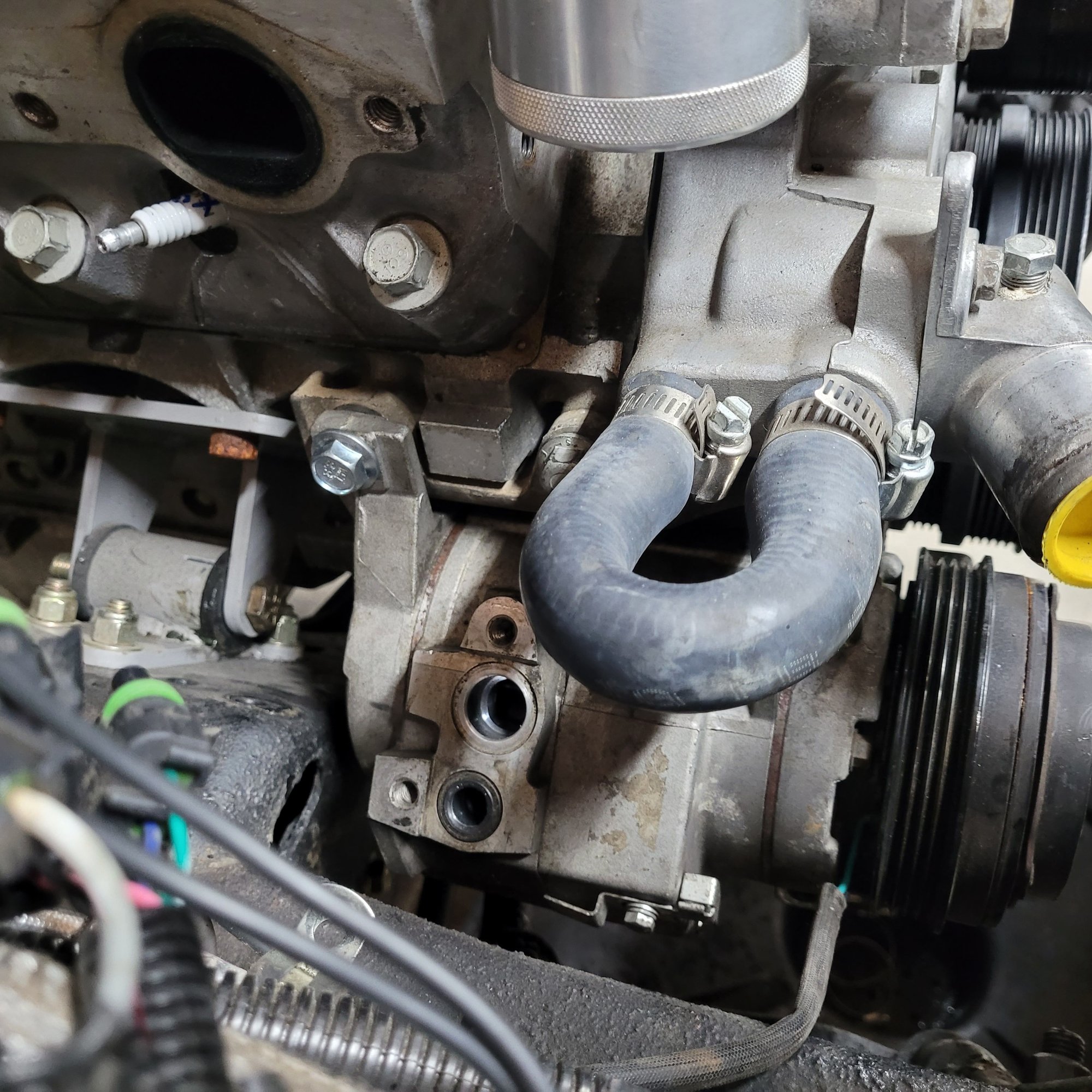

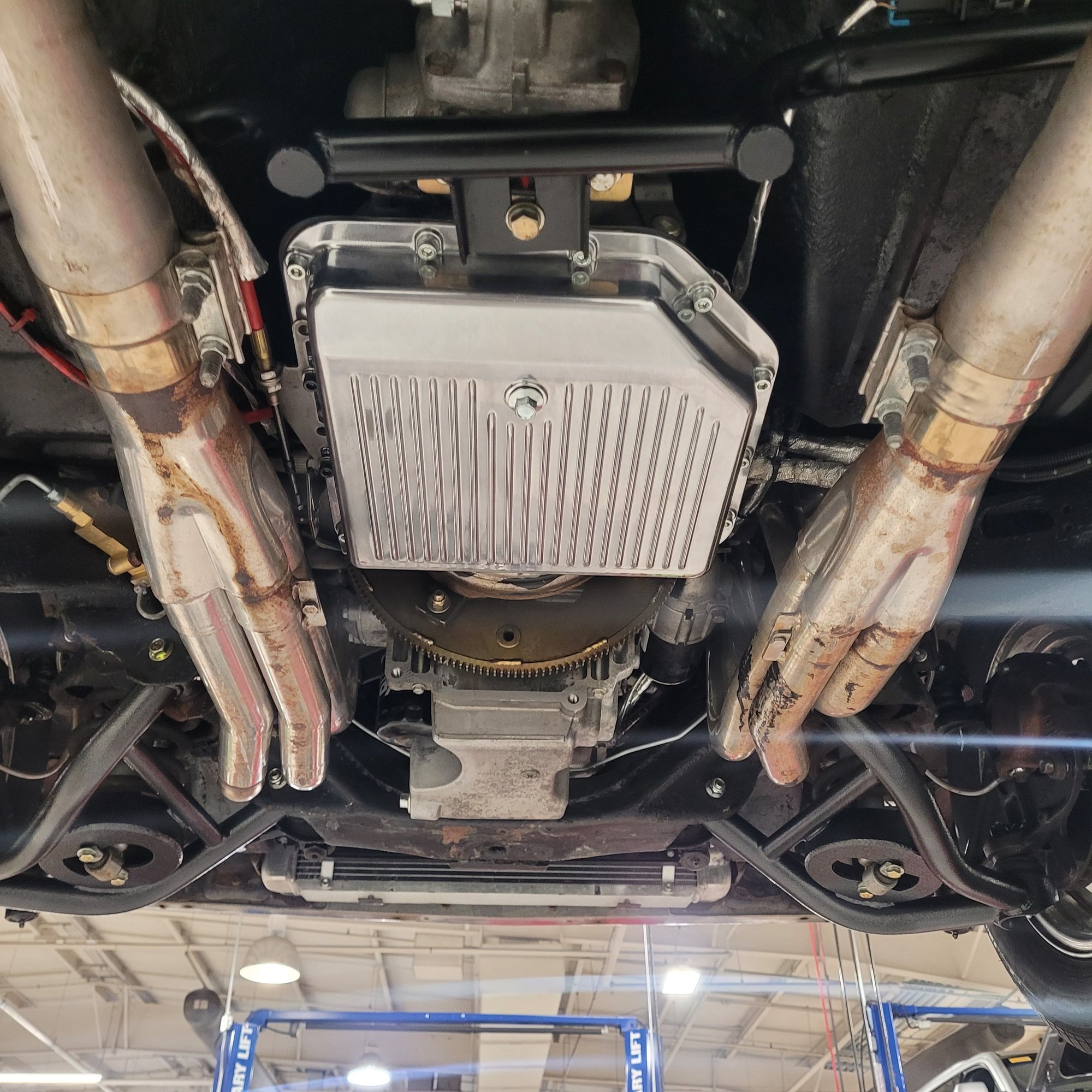

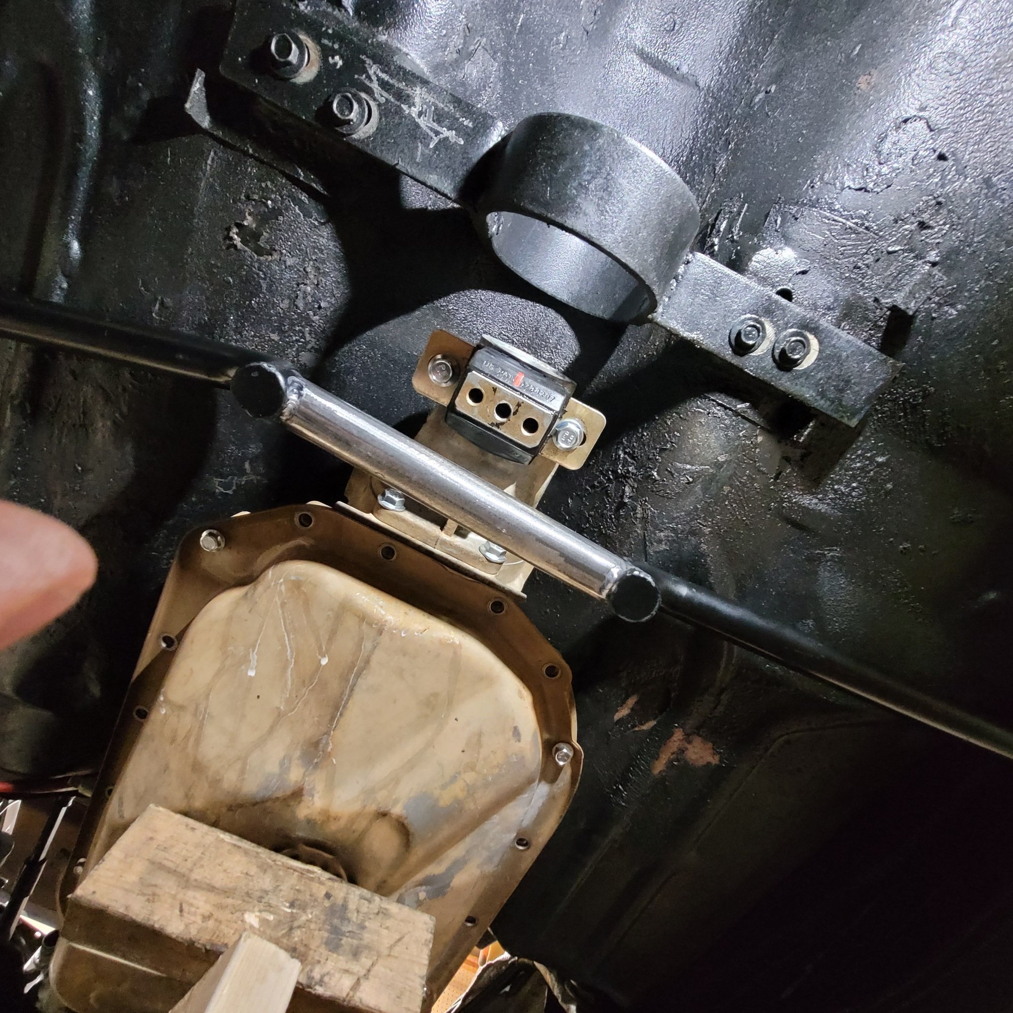

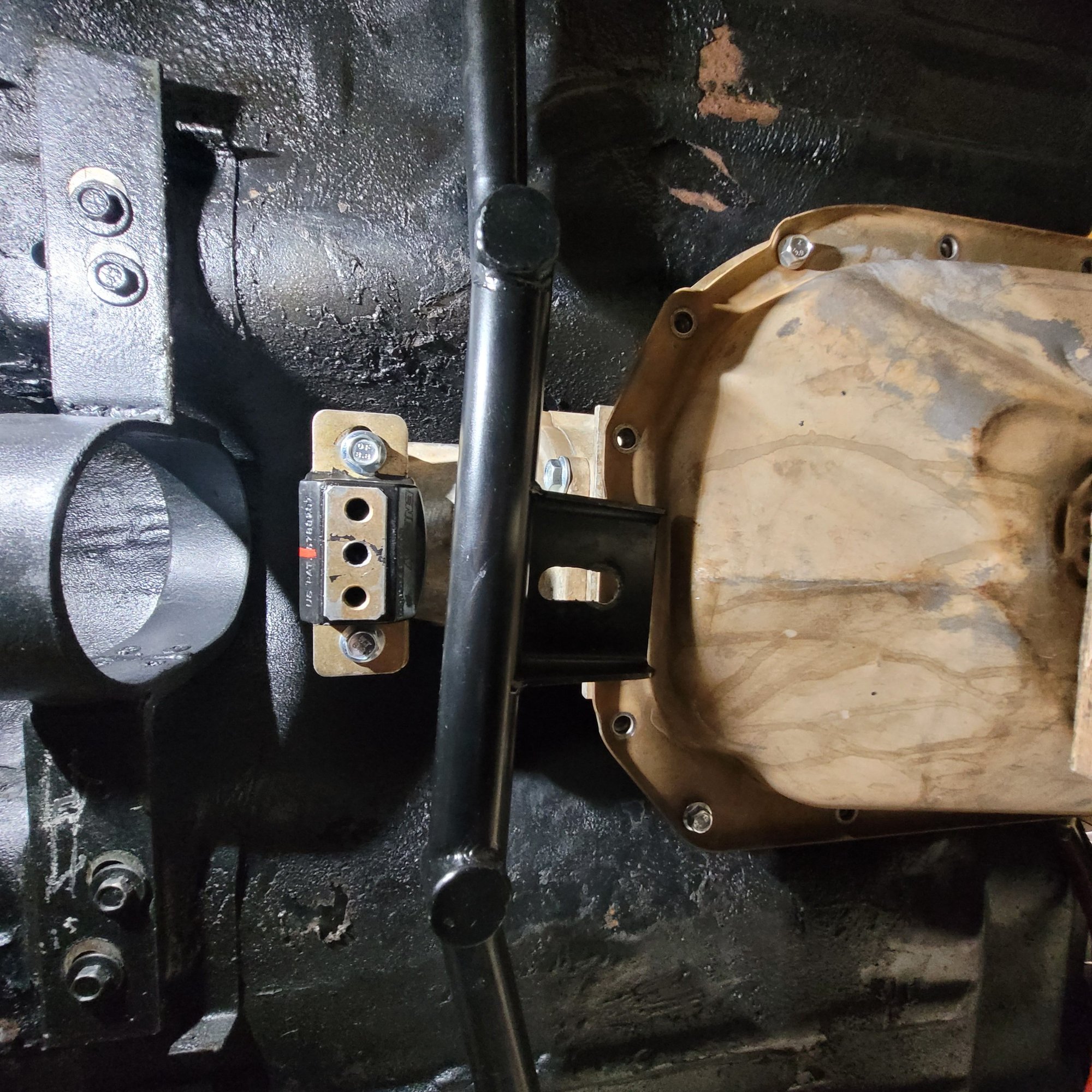

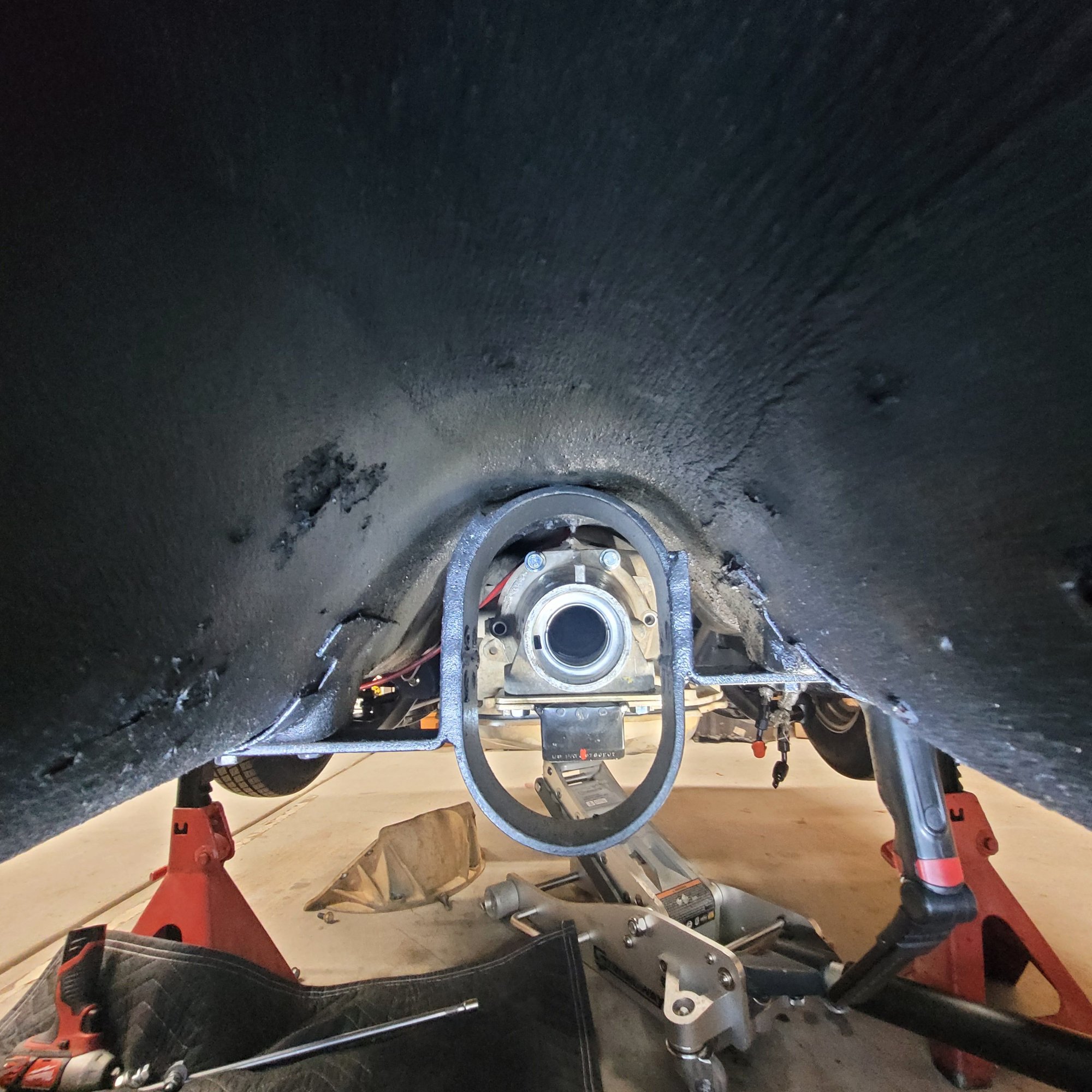

So after looking around and seeing what was available i spent some time laying under the car last night contemplating what life choices got me to this point... started playing around with the crossmember i already have and flipped it around. Looks like i could modify it to make it work by cutting the mounting pad off and welding it back on to the other side so i may try that this week.
Also, since i had them... i bolted the truck ac compressor and bracket on and it clears (i remeber on my blue malibu the f body stuff wouldnt fit due to the lines coming out the back). I dont plan to use it, but i figure it may help someone out.

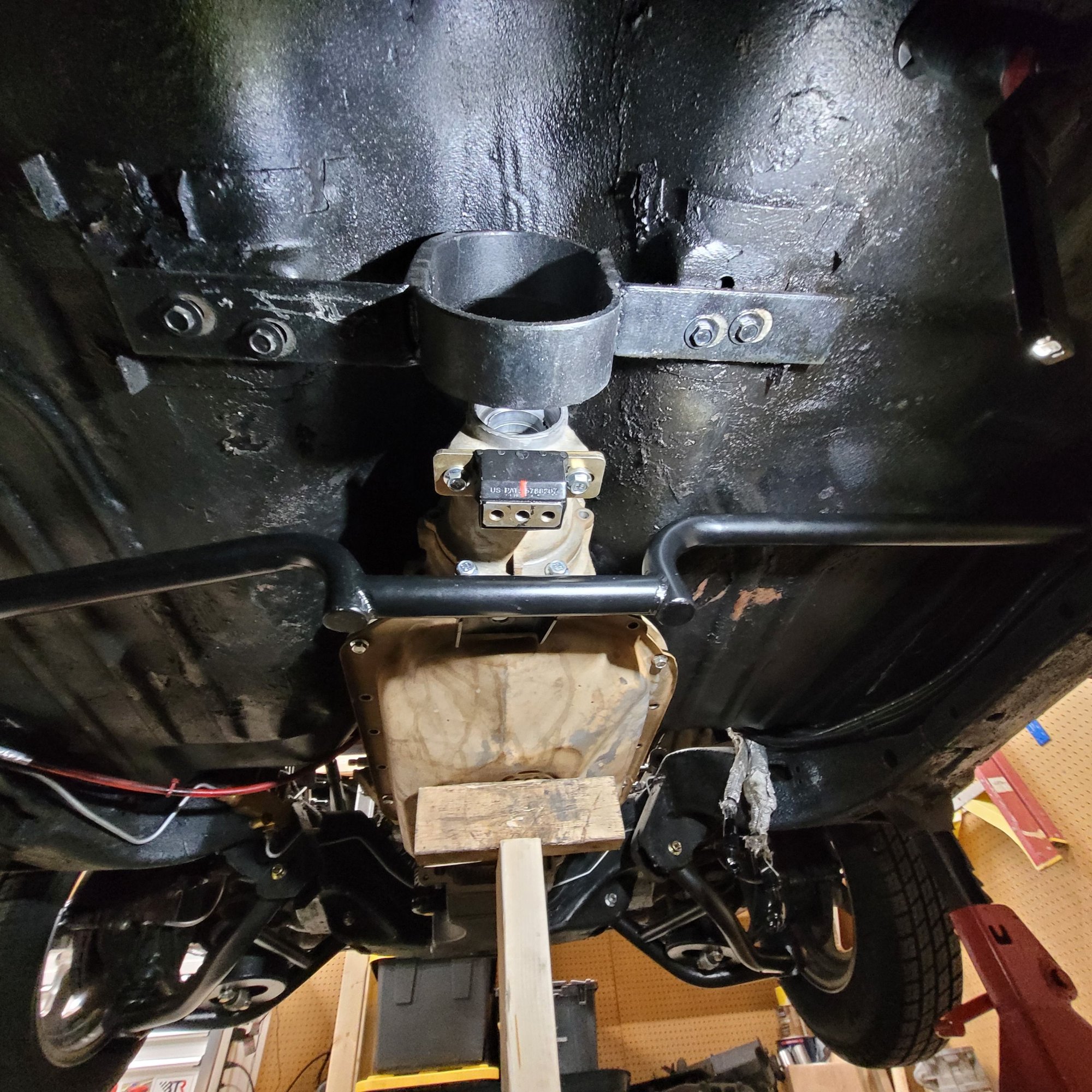

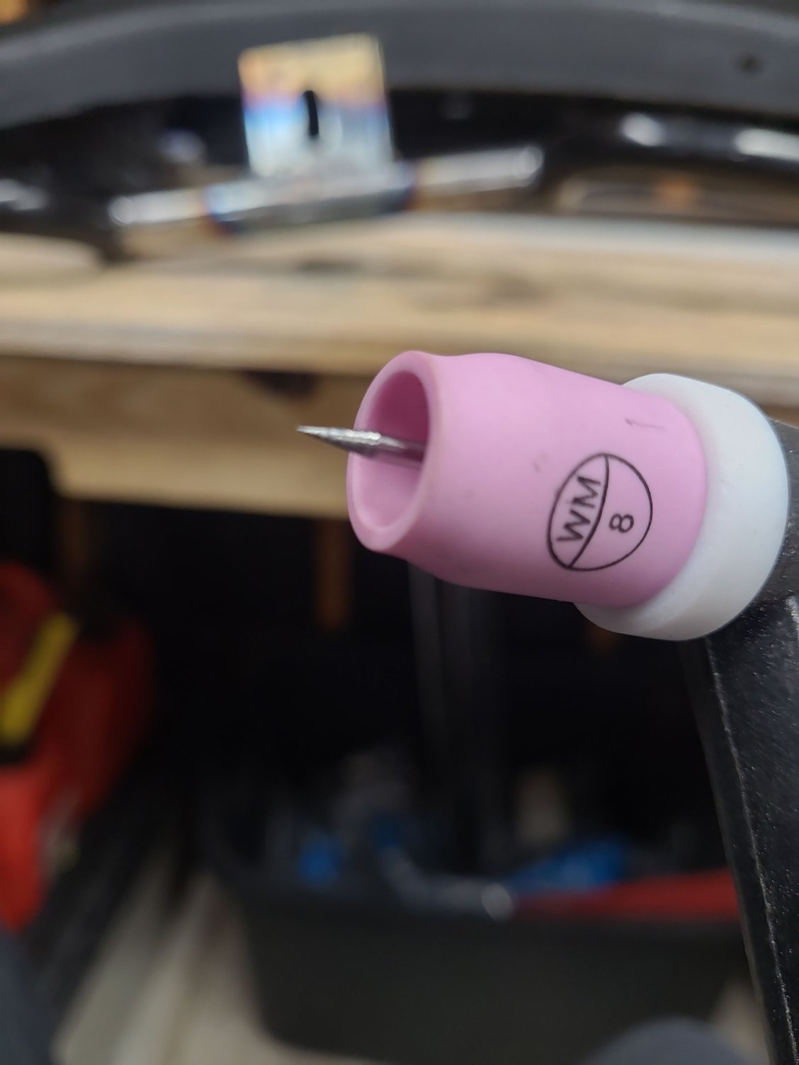

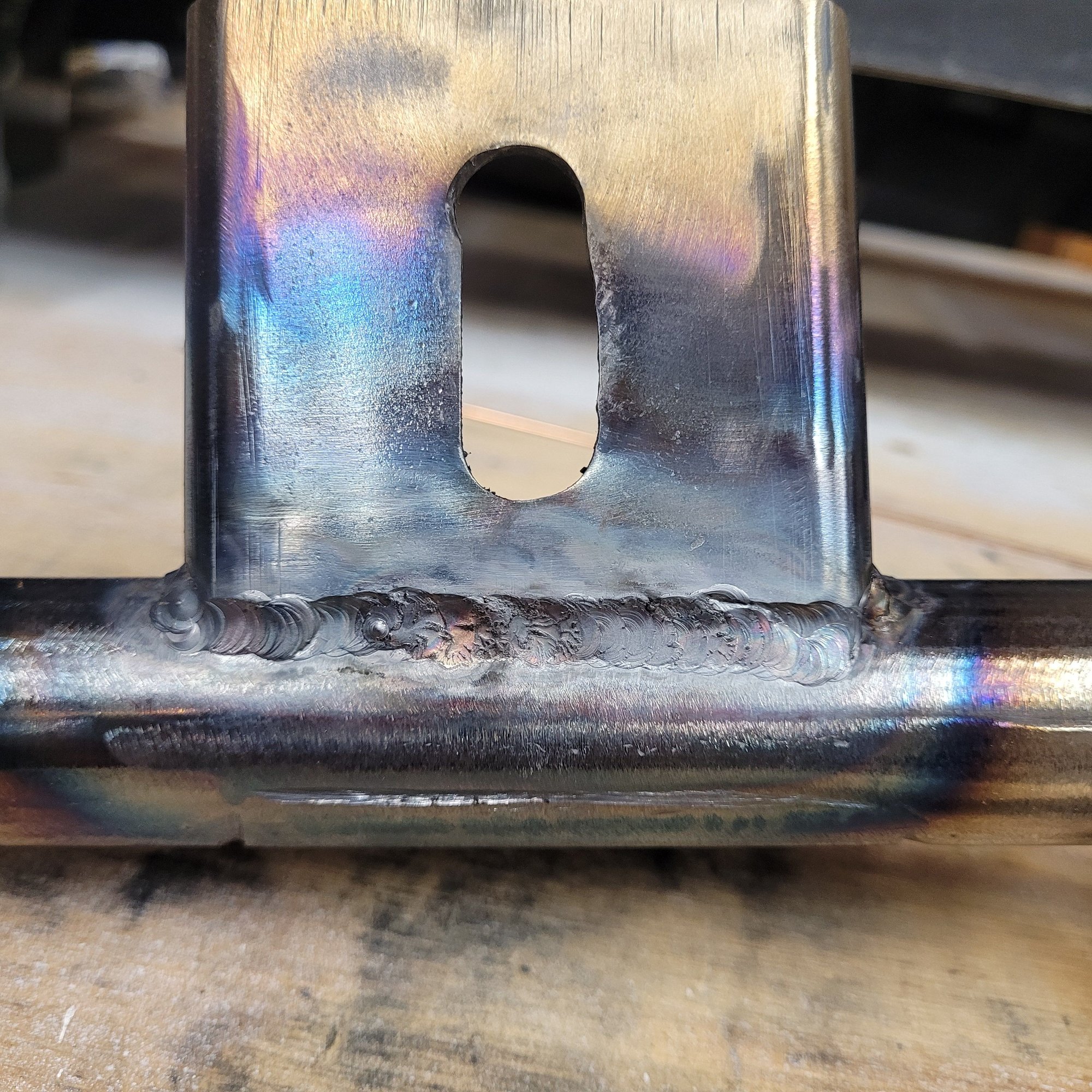

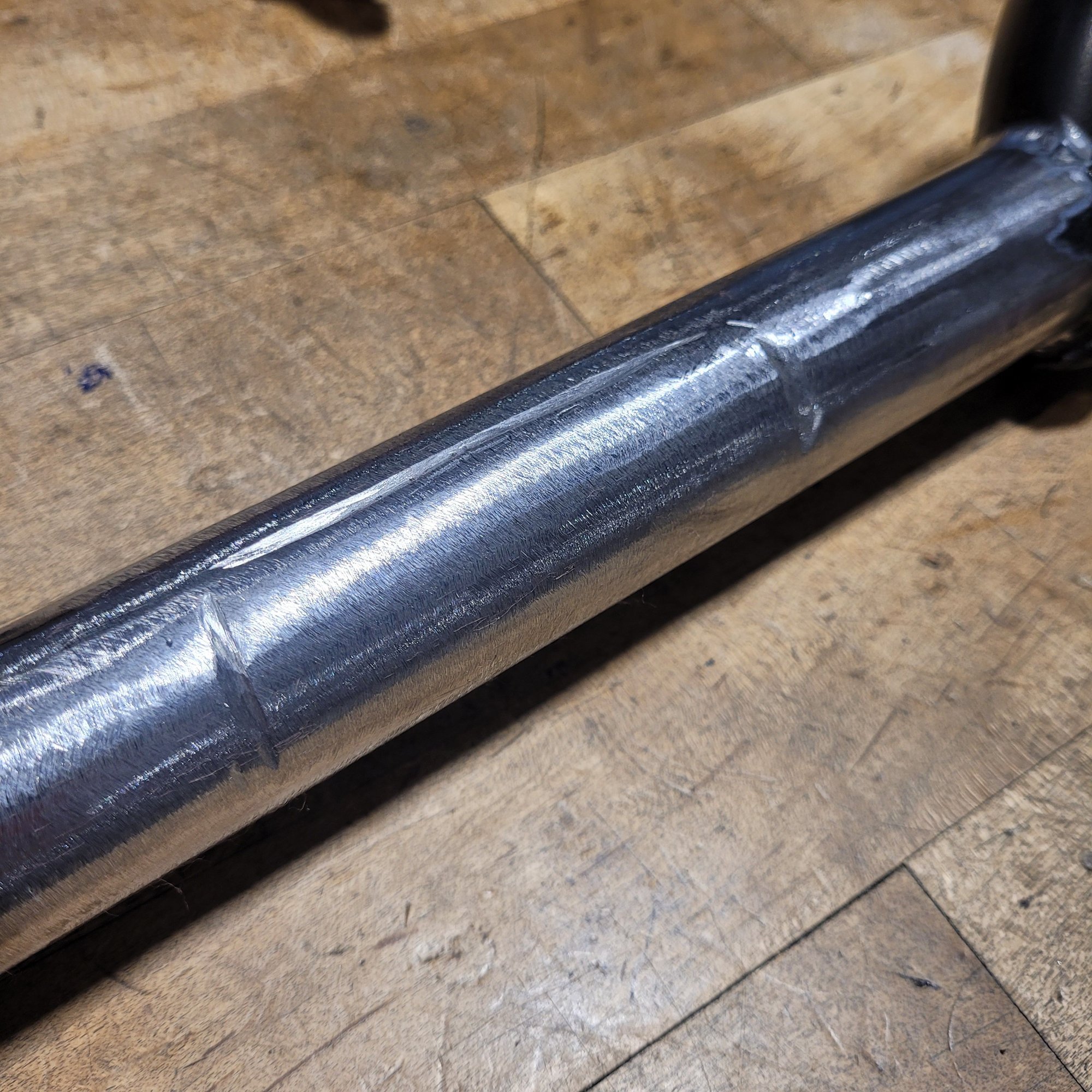

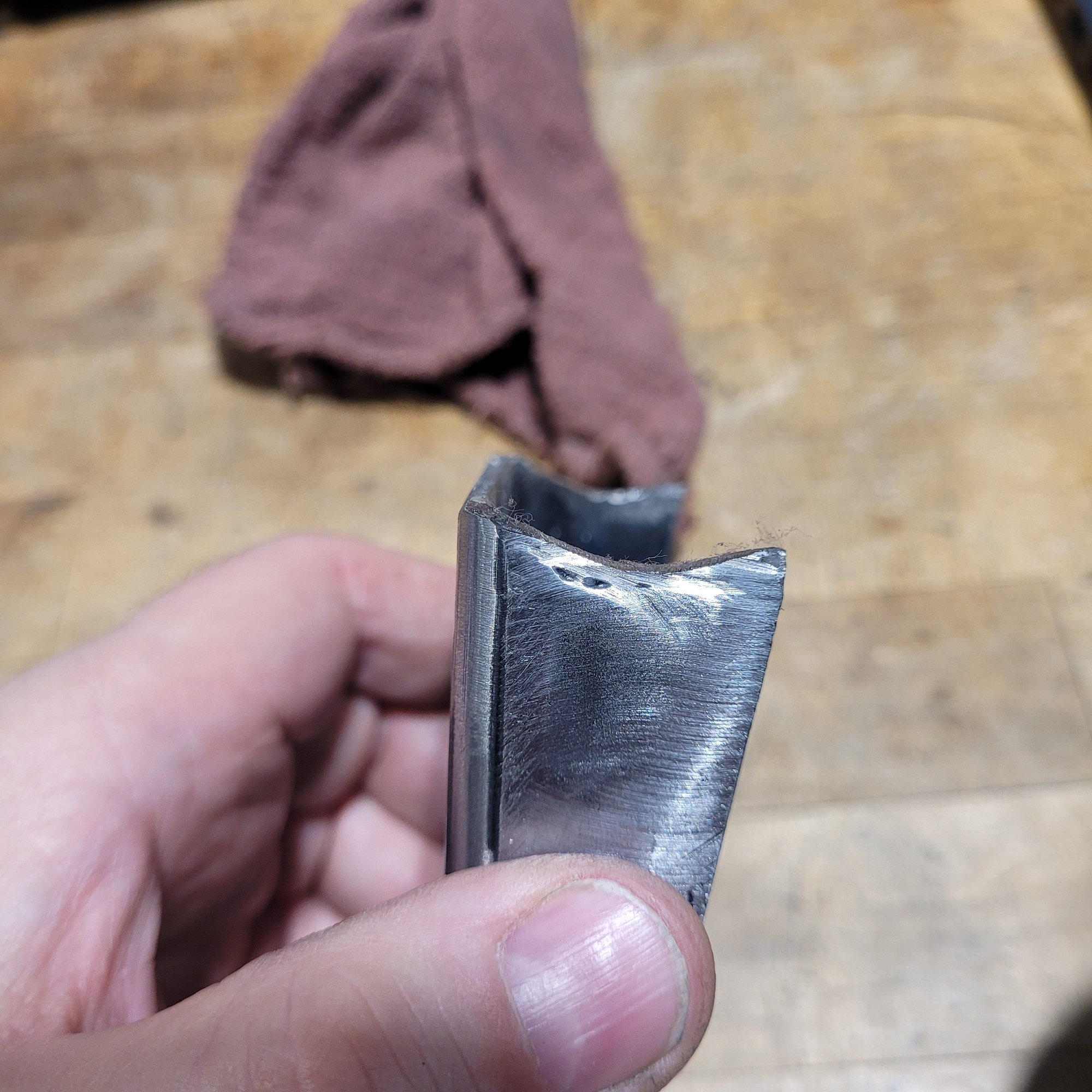

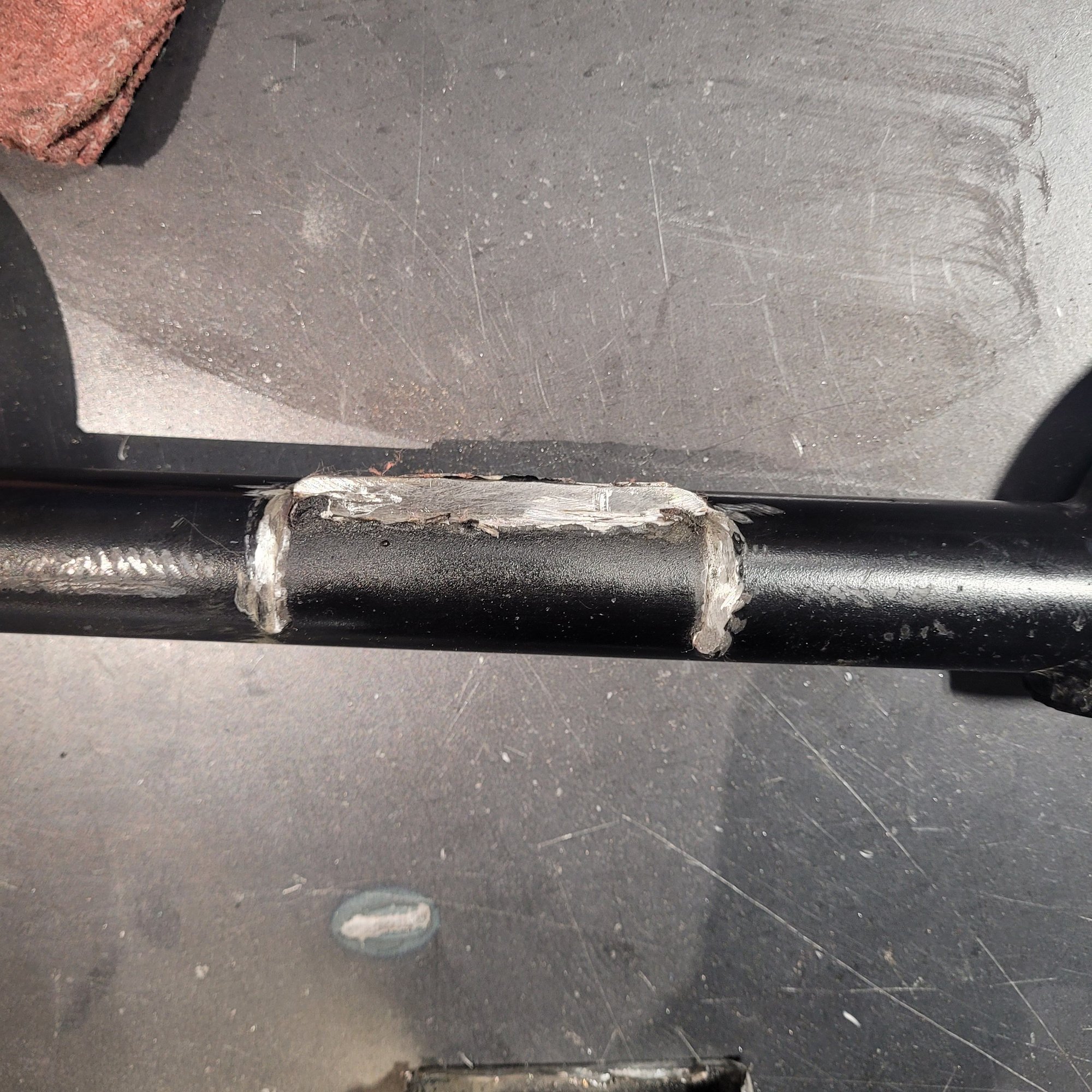

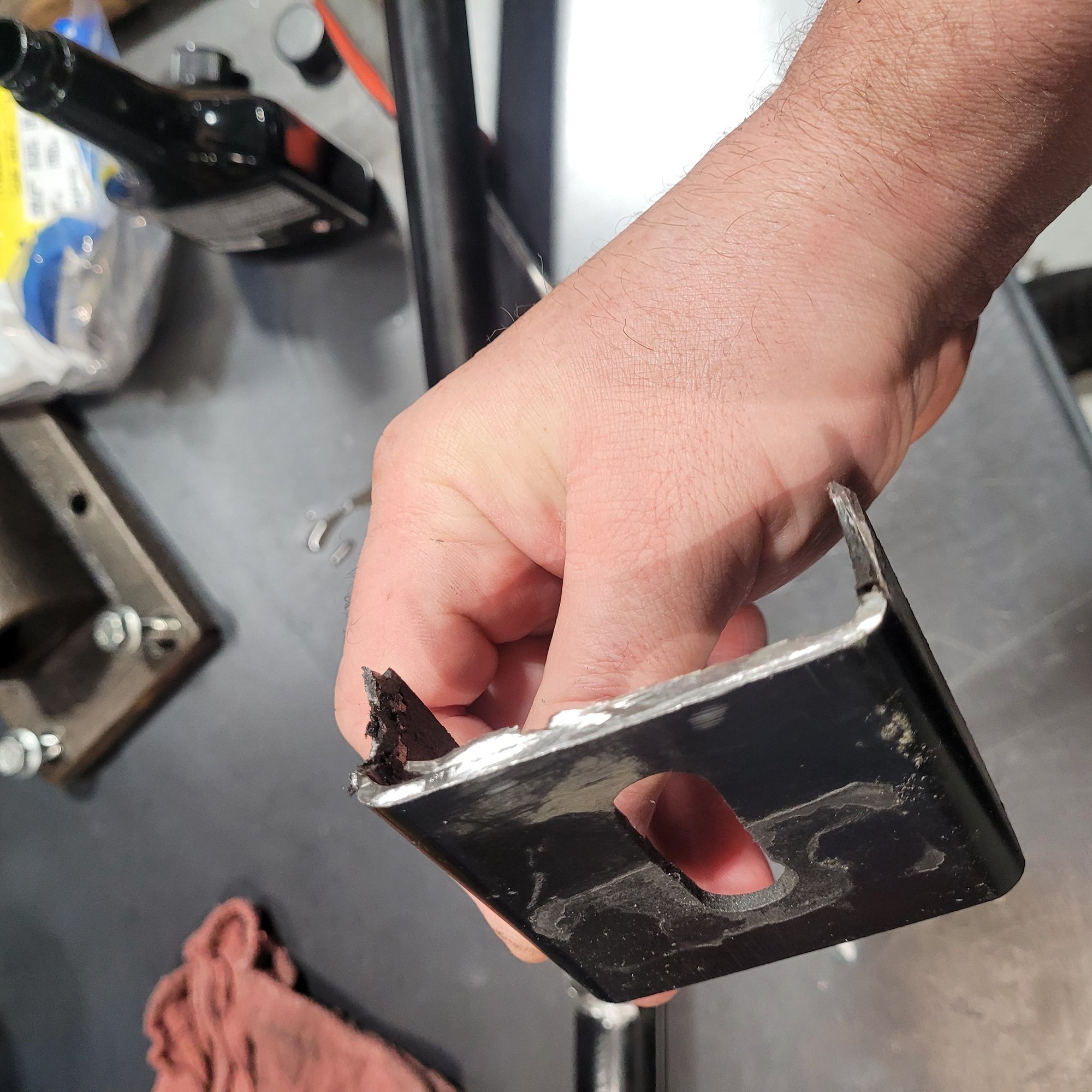

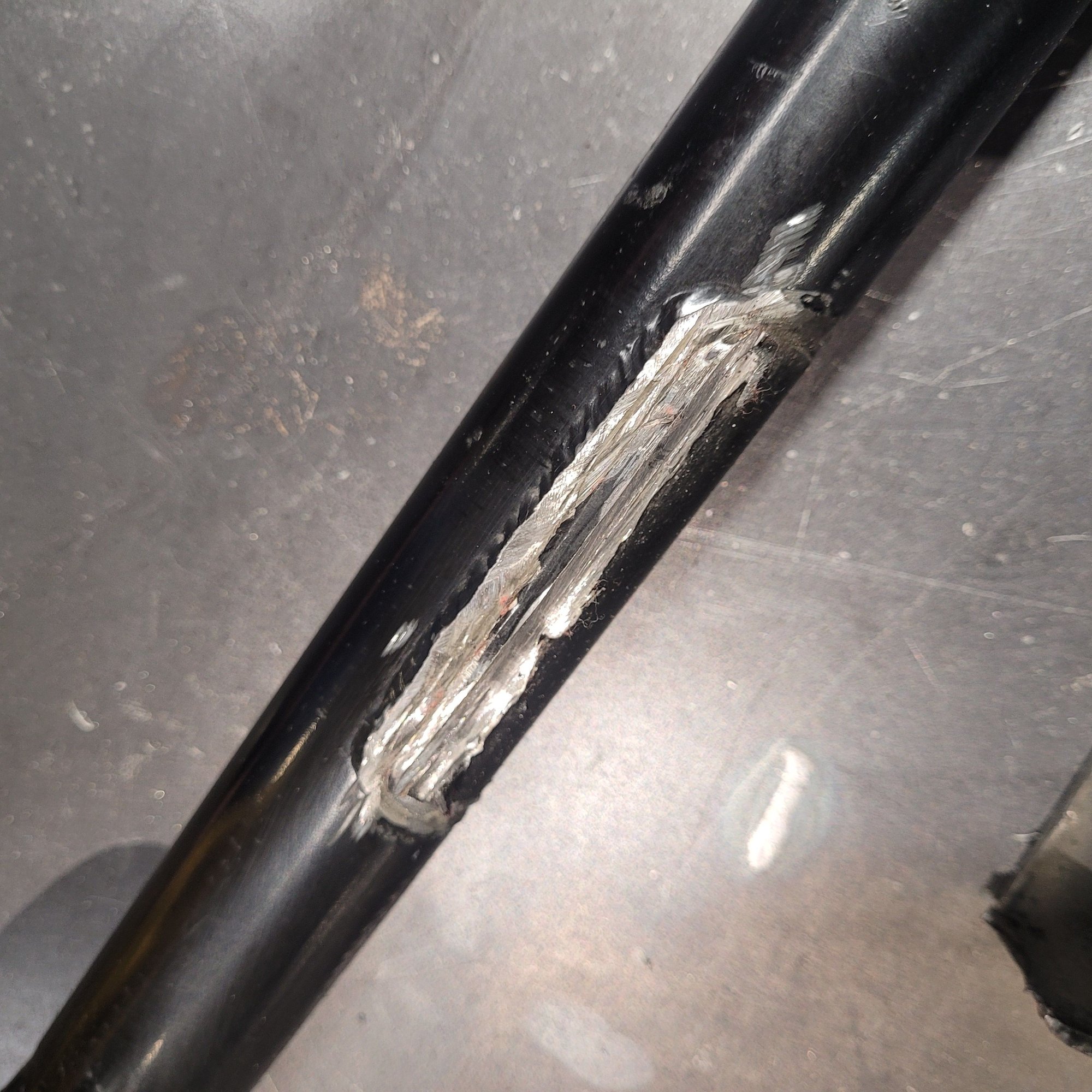

so instead of buying a new trans crossmember i just modified the one i had. cut the mounting tab off and just flipped it to the back side of the tube. this took me about a month to complete because of kids sports and other things. plus i never actually used a tig machine. but with the help of some friends and many youtube videos i was able to spend some time the past couple days messing around with my primeweld machine. I bought this thing on a black friday sale and it took me till about 2 weeks ago to get it unboxed, set up and useable.
Ill preface this by saying im by no means a pro, or even any good lol... but i was able to melt some metal together and i think itll hold. Its wild to think whats available for the average person to use at home these days compared to 10 years ago. This is on 110v in my very basic garage and its pretty cool. apparently i ran this pretty hot and too fast (according to my former boss whom i bother too often about this kind of stuff)

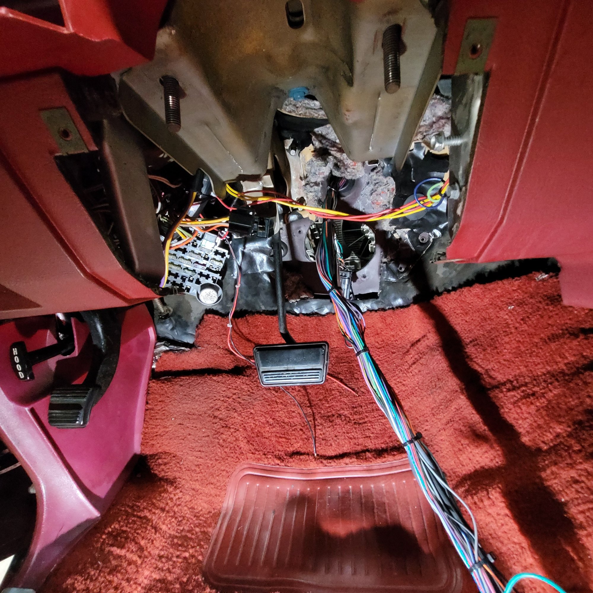

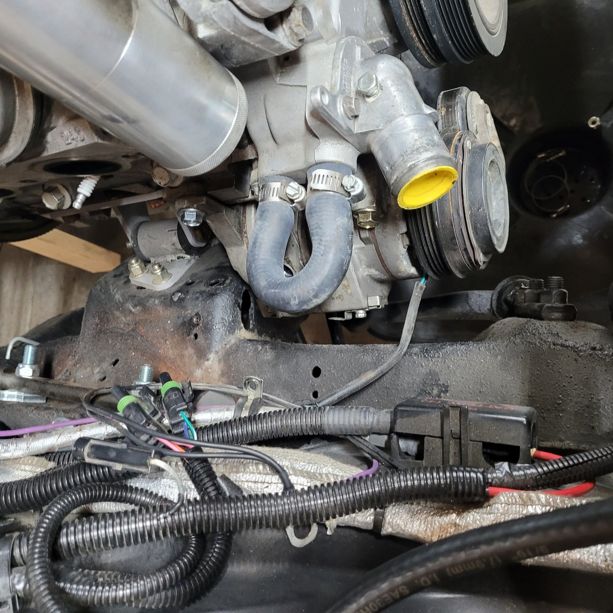

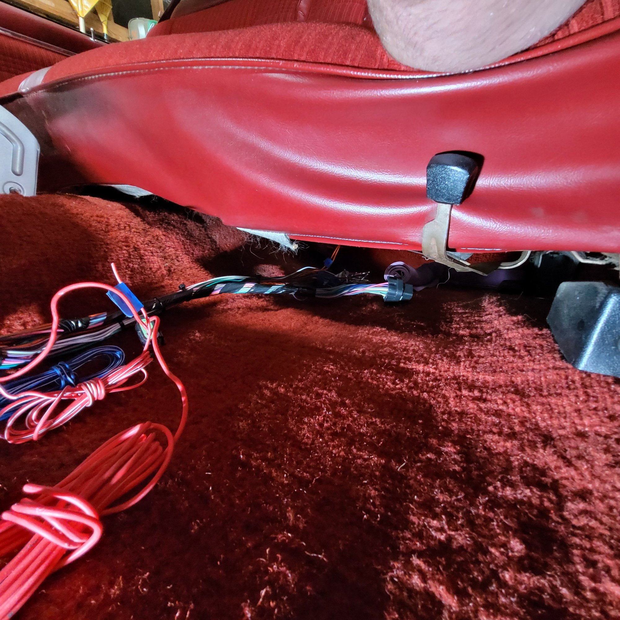

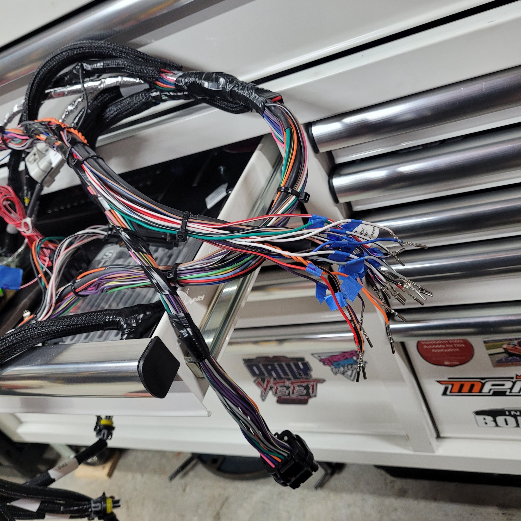

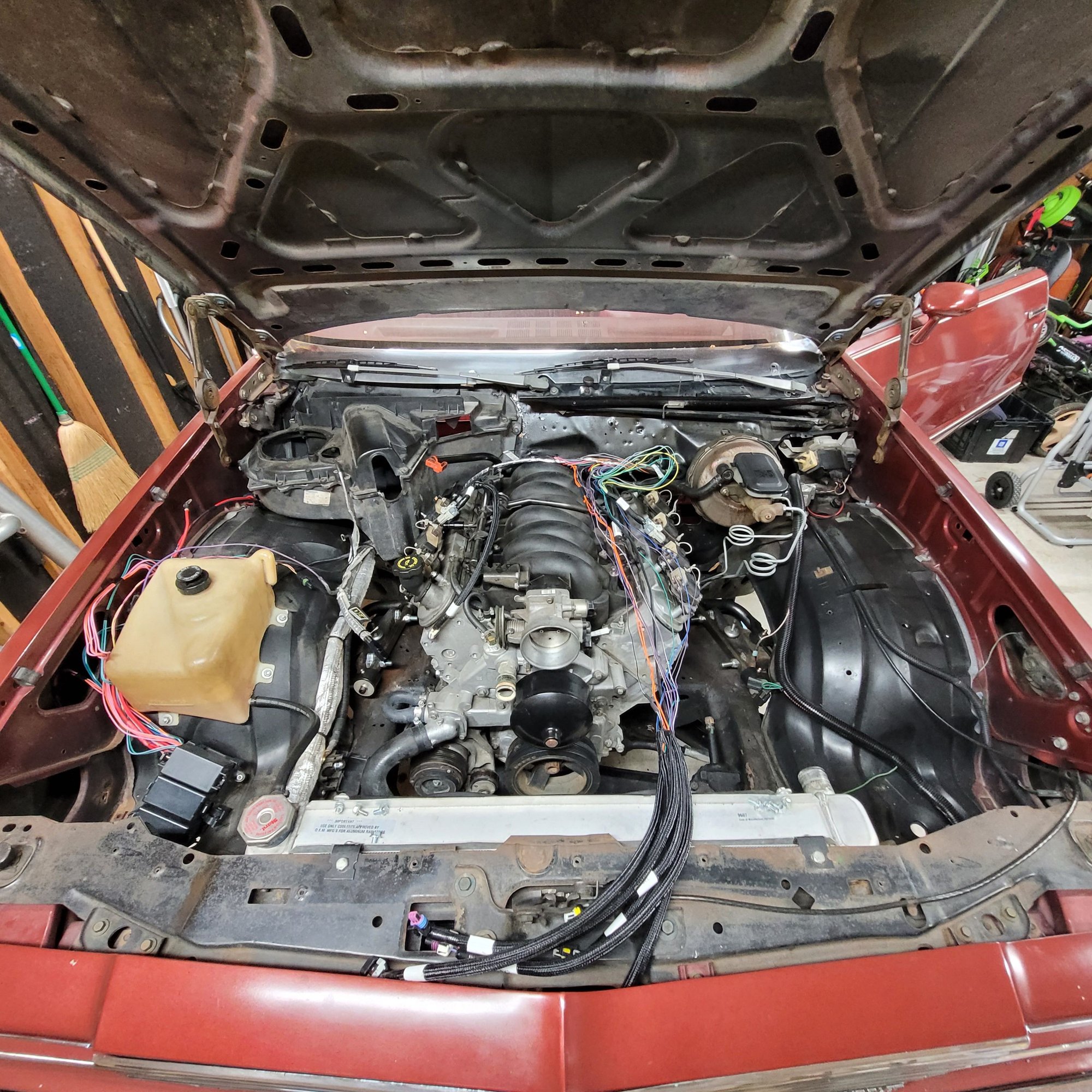

Started working on some if the engine management harness stuff this past week. I quickly figured out the way the holley harness was laid out was not going to work. So as we do with all new expensive parts we get, i started cutting it apart lol. Trying to put the ecu under the seat or behind the radio and i have miles of wire to do that. Feel like under the seat is a better choice in case later on i want to switch to a dominator.
also i need to decide if i want to keep the fuseblock i had in the car when i originally built it or do something else. It worked fine just looks kinda janky. Also need to make a bracket and mount it somewhere.
