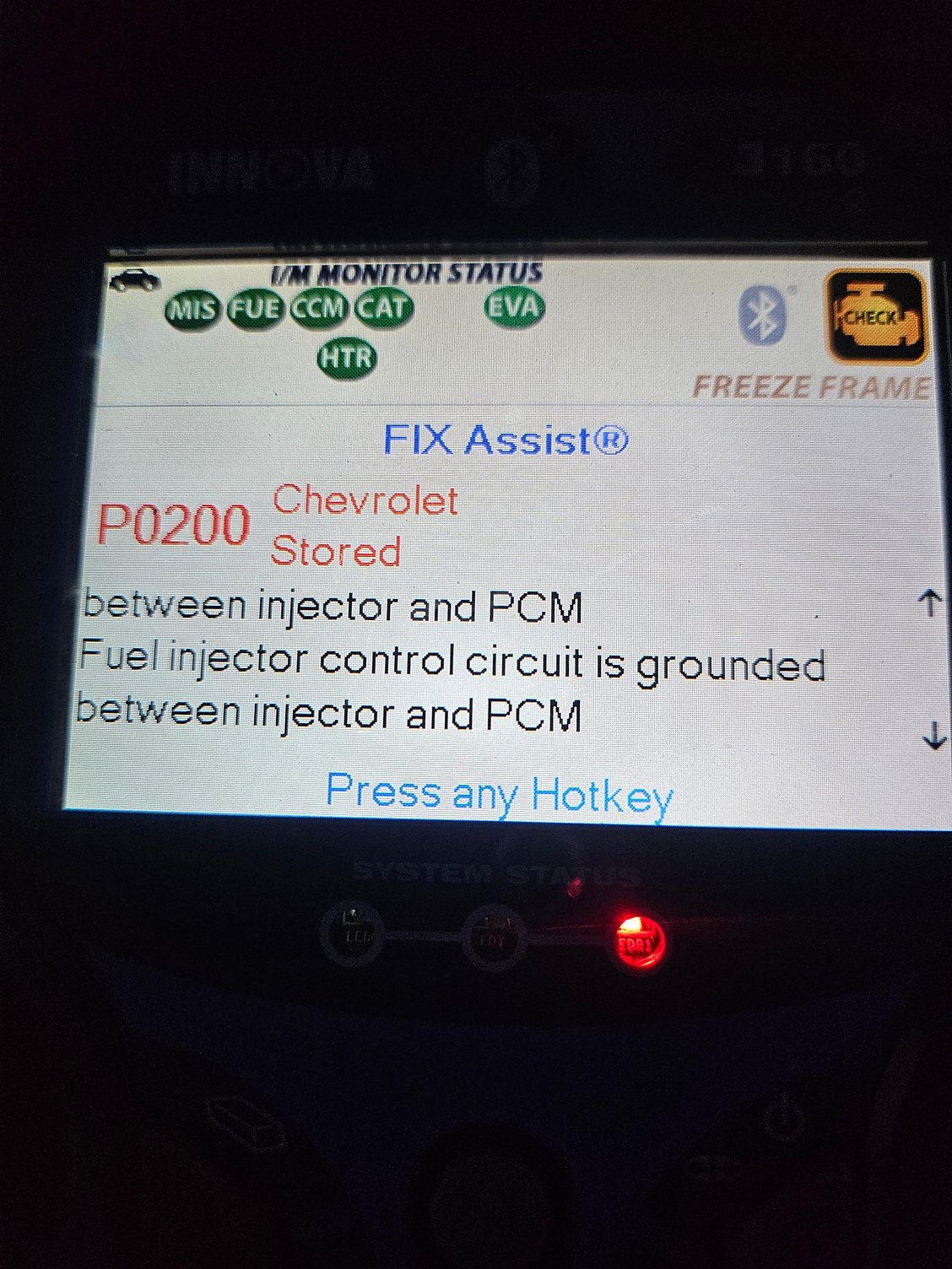

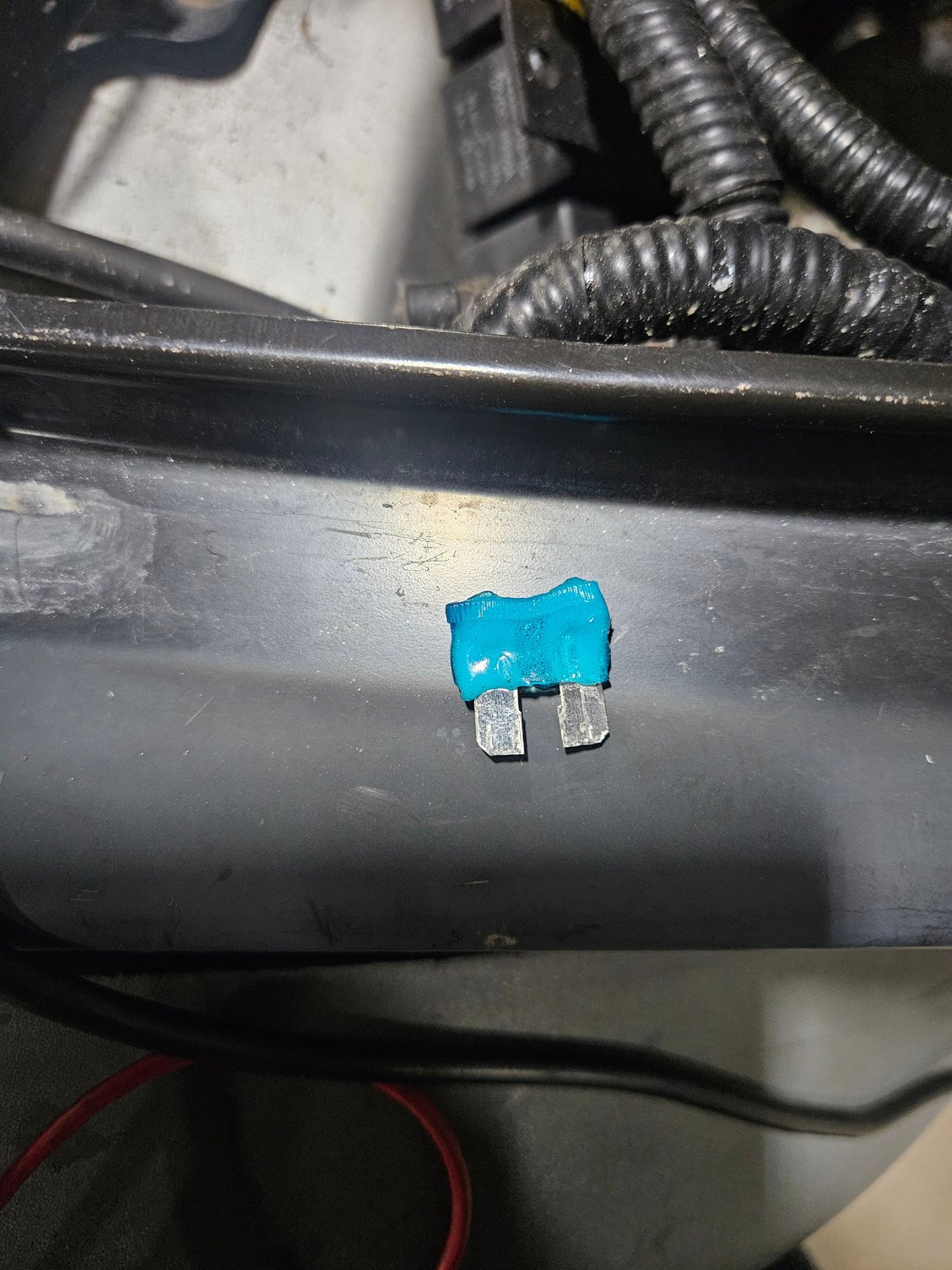

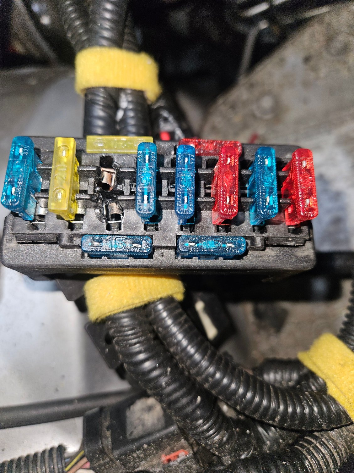

Not sure if this is related, but after doing that 12v check on those two wires, 20 and 57 at blue connector, I started to get code P0200, and truck runs bad. Checked the fuse box and found a melted injector fuse. Replaced it, seing 12v at that fuse, but P0200 won't go away.
Old Mar 23, 2025 | 10:50 PM
dixiebandit69's Avatar
Joined: Mar 2012
Posts: 862
Likes: 399
From: Texas
You've got a wire shorted to ground.

You need a new Fuse Box that thing is wasted. Whenever you see that you don't put a new Fuse in, that's melted because the wire is grounded out, as mentioned.
Whatever Bank that is, that power wire from that Fuse is pinched in something and now it's grounded out. Since the problem started recently that's what I'm thinking.
Time to strip wiring down and find the problem.
You get what you pay for when you buy that cheap bullshit. Saves you $50 so you can buy a fire extinguisher when it smokes the car.

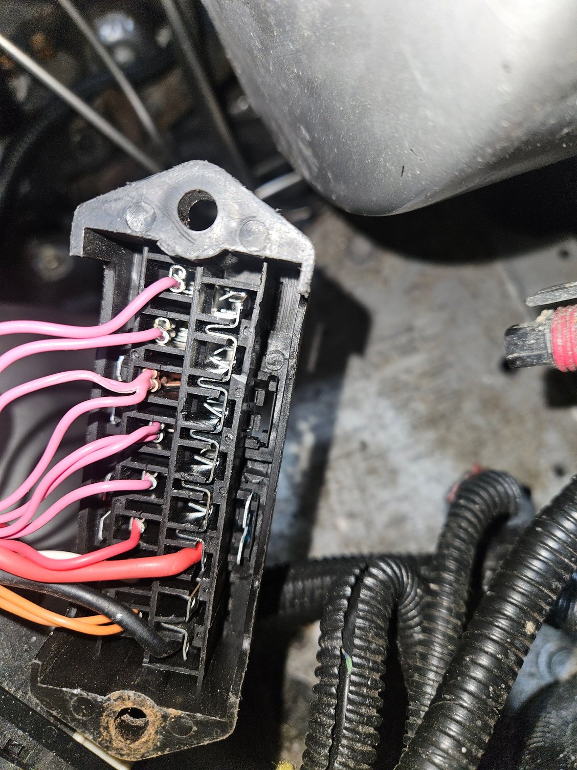

I check continuity between injectors pink wires and pink wire at the fuse box, nothing on both banks
Checked 12v at the injectors, nothing. Checked continuity between pink wire at the main connector on each bank to the pink wire at fuse box, it checks out good and this is on both bank.

Well that Harness is not made to what GM did with theirs, as we said there's a wire grounded out somewhere that shouldn't be.
You need to find that wire and a new Fuse holder.
Buy cheap low quality **** that's what happens.
