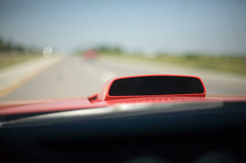

Here is a shot of the shaker from inside the car. This picture was taken in Iowa on the way to my stop in Lincoln, Nebraska.

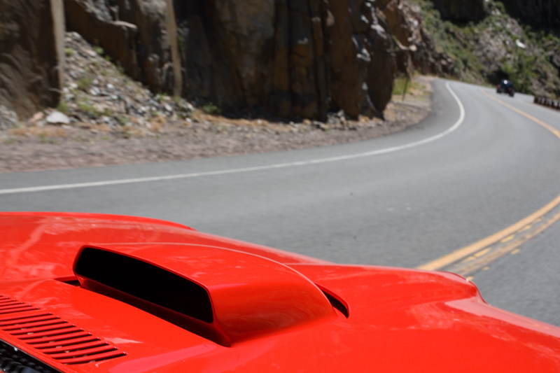

As I was pulling into Lincoln Nebraska, I could see some very interesting weather brewing to the west. Here are a couple of shots that were taken just as the sun was setting in the west. The clouds were truly spectacular and fortunately nothing came of it except a thunder storm.
I might have mentioned it before, but the next morning I installed the 550 lb/in springs that I got from Speedway Motors. I also cleaned approximately 1.2 million bugs off the front of the car and washed it down.
The following morning I headed west to Wyoming. This shot was taken in western Nebraska. I just thought it looked neat.

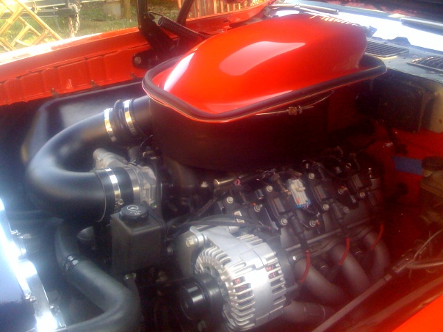

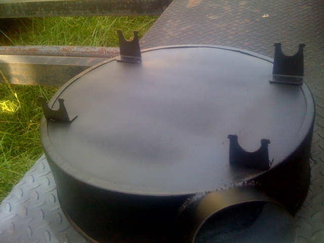

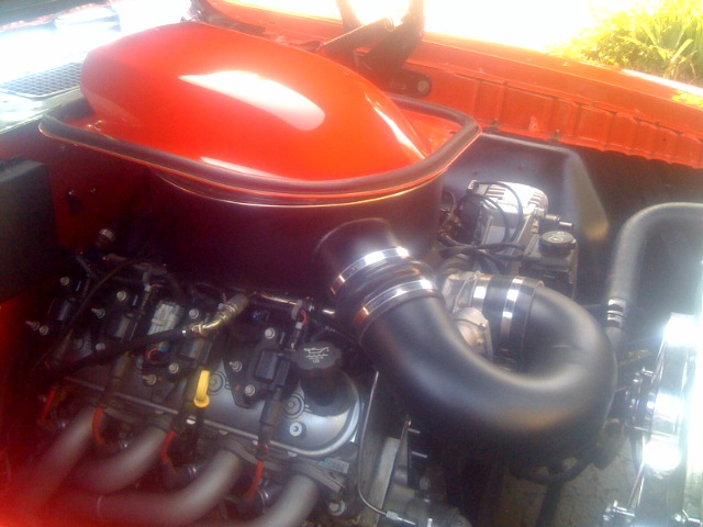

Some of you have asked how the shaker assembly is held to the engine. Here is how:
The tabs on the bottom of the base are shaped just like the tabs on LS7 coil covers. The grommets are available separately at your local Chevrolet dealership for under $3. At first I was a little concerned that the brackets would wear through the rubber from the vibration, but after 3600 miles everything looks good.
Andrew

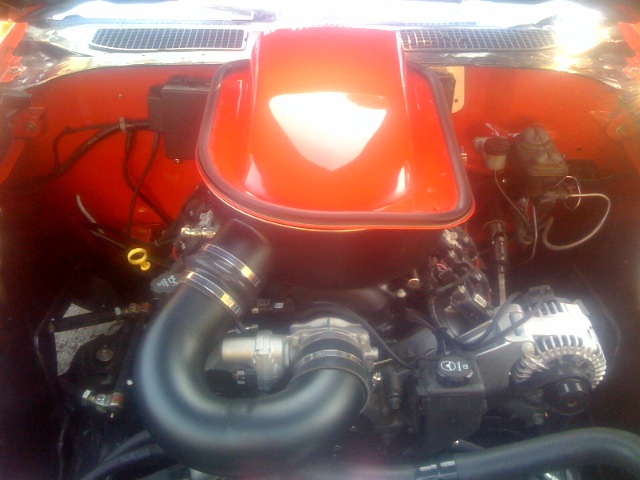

Yesterday I spent some time cleaning up the welds on the air intake tube and on the base. I gave it two coats of rattle can primer, follow by two coats of satin black. Turned out pretty good. I could have spent more time smoothing the welds but I am happy with the way it turned out.
Andrew

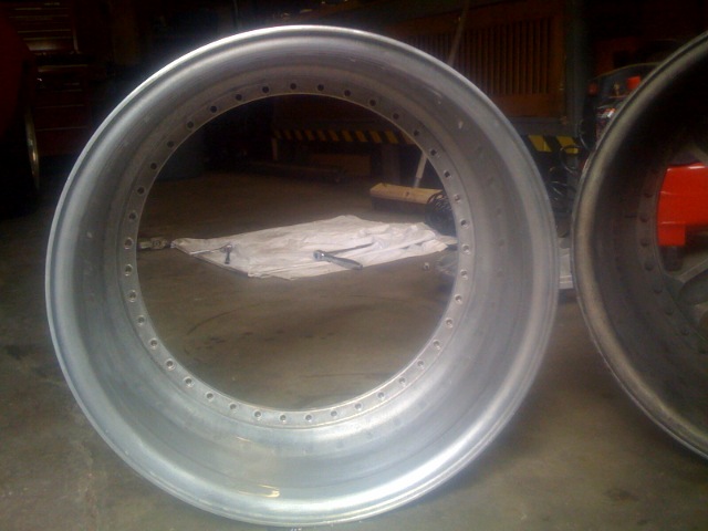

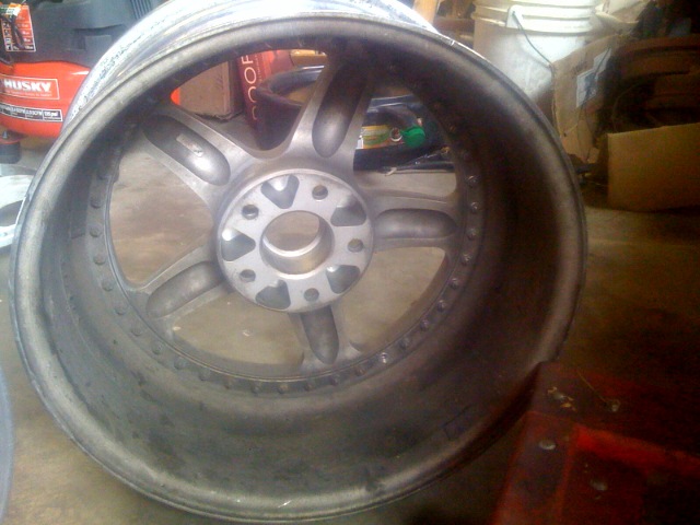

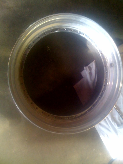

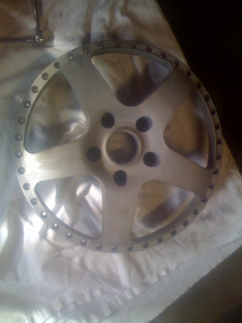

One of the things that I really want to do before RTTH (Run through the Hills) in September is to give the wheels a makeover. I have 3 piece Kinesis wheels that can be taken apart. The great thing about being able to take the wheels apart is that it makes it very easy to clean them or give them a new look. Here is the wheel taken off the car:
The outer lips were once polished but have since dulled. Not very pretty at all. The centers look OK but I want a slightly different look. There are 40 bolt around the circumference of the wheel. Once the bolts are taken out, the center separates from the inner and outer rim.
The wheels get very dirty on the inside from driving. Don't ask me how this happens, but there were actually dead bugs stuck to the inside rim. Here is a dirty rim:
Here is a rim after some time with Purple Power and a red scotch brite pad:
I am going to clean up all of the inside rims and paint them silver. The pain will make clean up much easier. The outer rims will get re-polished for a nice, bright finish. The centers are going to get hard anodized and Teflon coated for extra durability.

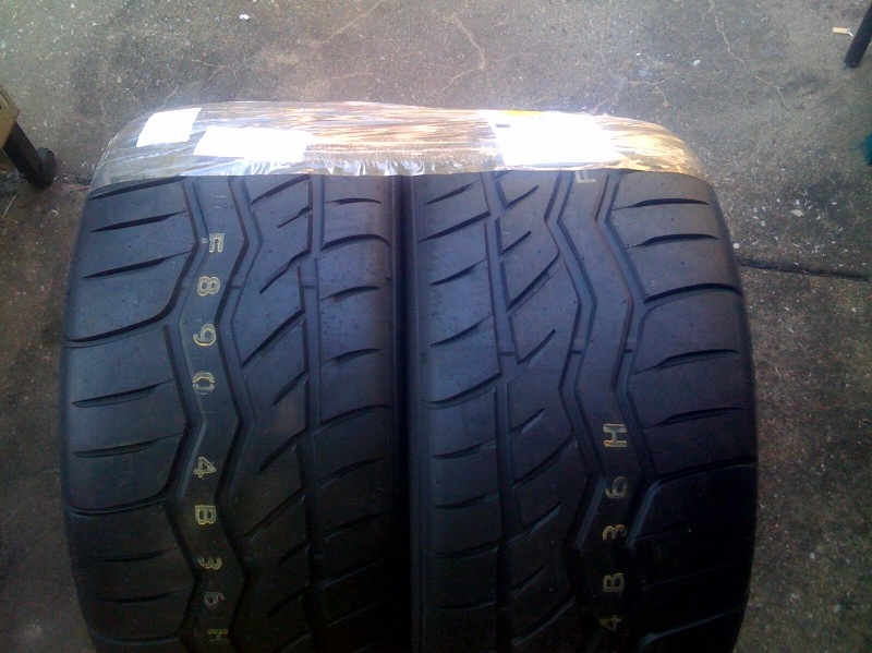

New tires should be here first part of next week. I decided to go with the Falken Azenis RT-615 tires. The tires will be slightly shorter both in the back and in the front. In the back I will be running 295/40-18 and in the front I will have 255/40-18s. So the rear tires are a hair over 27 inches tall and the fronts are right at 26 inches tall.
The Nittos were good tires and had plenty of tread but it was time for a change. They were pretty old. The date code on the tires was from 2002.

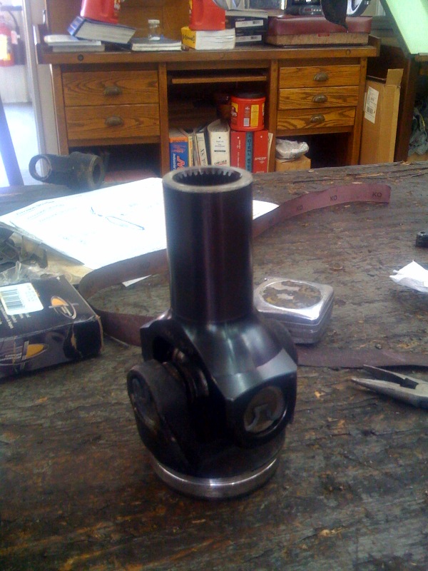

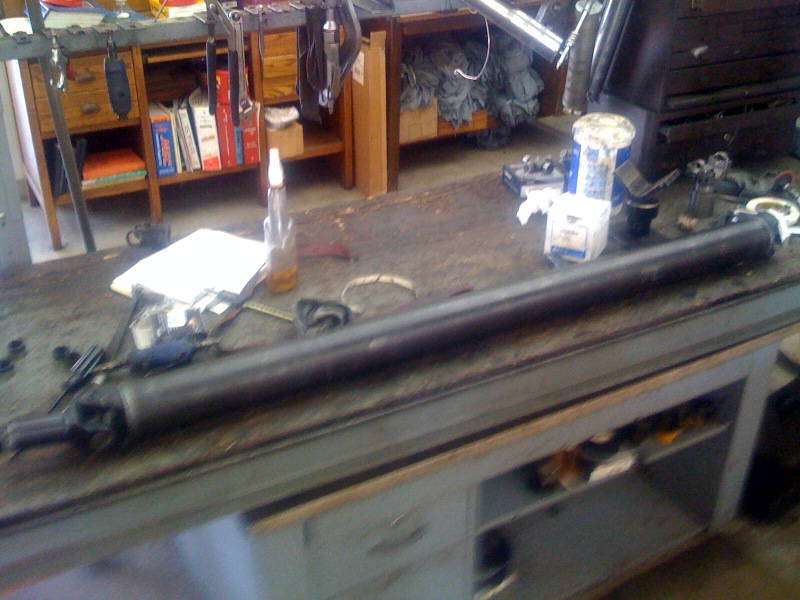

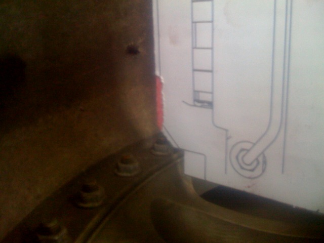

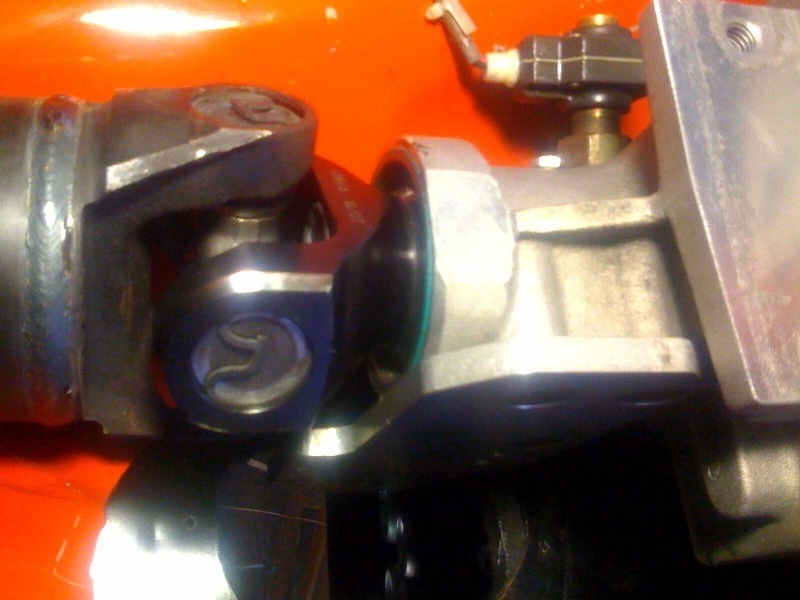

Some people have asked me to elaborate more on the driveshaft issue. Here is what the driveshaft looked like when installed into the transmission:
By the looks of it most people would say that it looks OK. I thought so too. Here is what it looked like "inside."
The seal sits at the edge of the shiny part of the yoke. The bushing is about 13/16" from the seal. My yoke was cut down some in order for it not to hit the speedometer gear. The gear is located exactly 3.5" from the end of the output shaft. My yoke as cut too much I think:
This is what it looked like with the driveshaft installed and the tailshaft housing removed. You can see there is plenty of room before the yoke hits the speedometer gear. I also wanted to see just how much the slip yoke actually moves with suspension travel. That is what the zip tie is for. I placed it firmly against the edge of the yoke and moved the car through about 7-8" of suspension travel. 3-4" up and 3-4" down. That is as far as the yoke moved. A whopping 1/8"!!!
So my new driveshaft will position my slip yoke much closer to the seal and it will give me barely enough room to install the driveshaft. I also installed 2 tailshaft bushings.
Andrew

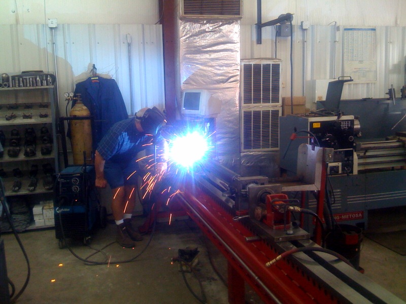

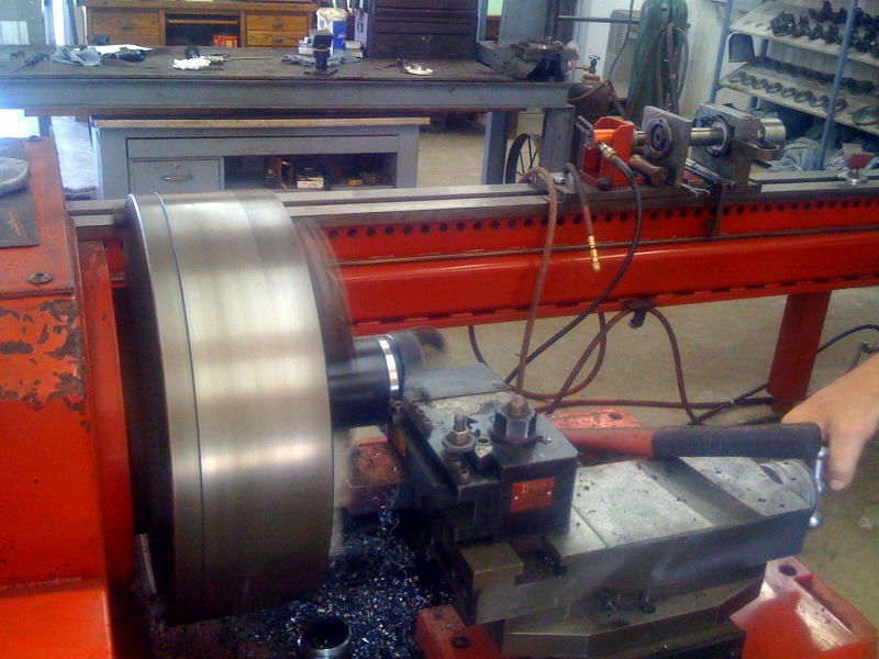

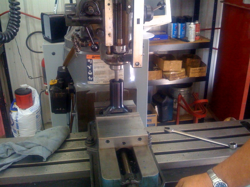

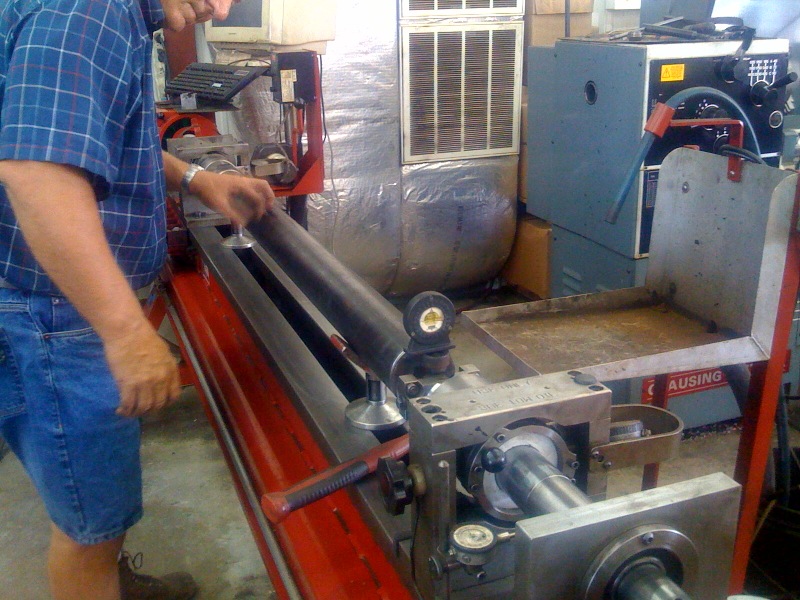

This morning I took my slip yoke to Precision Driveline in Glasgow, KY. This is a one man operation and Terry was kind enough to let me snap some pictures while he made a new driveshaft.
The first thing that Terry did was slide my old driveshaft into a big lathe and cut off the old weld yokes. This was not nearly as dramatic as I thought it might be.
I made some very careful measurements last night and the slip yoke needed to be trimmed just a little bit. Interestingly enough, the Strange yoke didn't have splines cut in it for the first 3/4" or so. According to my measurements that whole section without the splines needed to be trimmed off. Terry had a CNC Bridgeport that he used to mill the yoke.
After the yoke was trimmed a new Neapco solid u-joint was mated to the weld yoke.
Terry then measured and cut the tube, assembling it on his fixture, making sure that the ends of the shaft are indexed correctly.
Once he was happy with the alignment and the straightness of the tube is was time to MIG weld the yokes to the tube.
After the yokes were welded Terry allowed the shaft to cool down before balancing it. Here is the new finished shaft.
The careful measuring really paid off. I was able to slide the slip yoke inside the transmission and the rear u-joint BARELY slipped into the pinion yoke. This is about as long as the driveshaft can be without being TOO long.
After the driveshaft was installed there was no more noticeable lateral movement at the slip yoke. I don't know if this was my sole source of the driveline vibration, but I am 100% sure it was a contributing factor. I will know for sure once the car is back on the road in a couple of weeks.
Andrew
