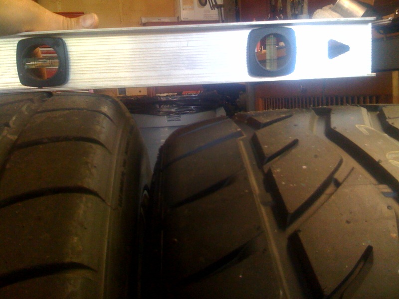

Here are the Falkens compared to the Nitto 555s. The Nitto 295/45 is about an inch bigger in diameter than the 295/40 Falken. This will translate to about a 1/2" drop in ride height, which is no big deal.
The more interesting part is that the Falkens have just over an inch more actual tread width! The advertised section width on the Falkens are stated to be about .4" wider than the Nittos. I can't wait to see how these tires work.

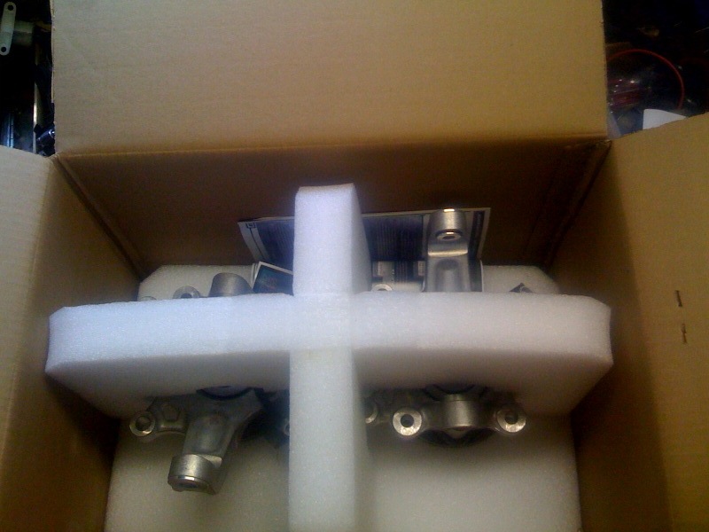

Today I got my ATS spindles:
ATS did an awesome job of packaging the spindles for safe shipping. I ordered mine with some new billet steel hubs from Vansteel. These use a tapered bearing design that is more durable and I also got the optional GM Racing wheel studs. These hubs are assemblies are being used on SCCA World Challenge cars with great success.

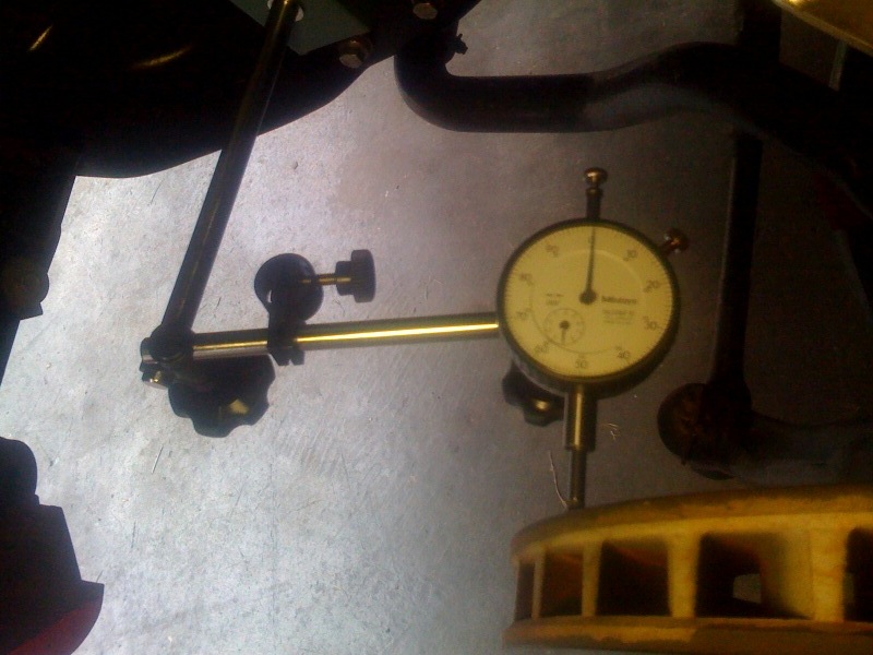

Before taking my spindles off I wanted to test for myself the bump steer that everyone has talked about with the b-body swap. I certainly felt it on my road trip. So I got my dial indicator out and attached the base to the frame and positioned the tip against the rotor. I made sure the rotor had a couple lug nuts on it to keep it steady.
This was a very limited test because I did not take the coilover off and run the suspension through its full range of travel. However, I was able to measure the bump steer from approximately ride height through 1.5" of travel in rebound. Here are the numbers.
Ride height-------dial indicator set to zero
1/2" rebound-----.1" toe in
1" rebound-------.2" toe in
1.5" rebound-----.320" toe in
I am no suspension expert, but I am pretty sure the above numbers suck ***. Once my brakes are here, I will do the same test with the ATS spindles installed.
On a side note, since the rear end was on jack stands I wanted to see if my vibration was gone. I started the engine, ran it up in 5th gear (1:1) and at about 3200 RPM I am still getting that buzzing vibration. I messed around with the pinion angle and nothing made any difference. I finally put a dial indicator on the driveshaft at the rear to measure the run-out. I watched Terry do this on his fixture and I knew the shaft was within .002". To my surprise I saw .038" on the dial indicator. I suspect that my pinion yoke is off. This is driving me insane. Tomorrow I may try the old "hang big hose clamps on the driveshaft test."
I am open to suggestions. :/
