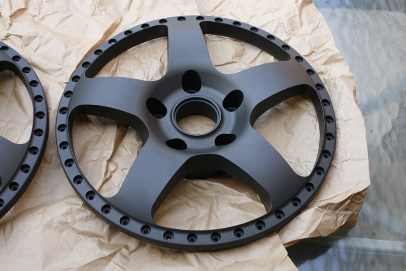

I got the wheel centers back today and they look pretty amazing.
I should have the polished rims tomorrow and then I can start on assembling the wheels.

Very nice Andrew, those were done down here in O-town, a JP recommended place, correct,
Old Aug 1, 2008 | 08:45 AM
  #238
Project GatTagO's Avatar
Joined: Mar 2003
Posts: 10,615
Likes: 1,883
From: Little Austin
Correct. Orlando Plating.
Andrew

Originally Posted by 1BadAction
what are those "plated" with and what was the cost?
Industrial hard anodizing. $200 for all 4. They charge "per rack." It took two racks to hold the wheels.
