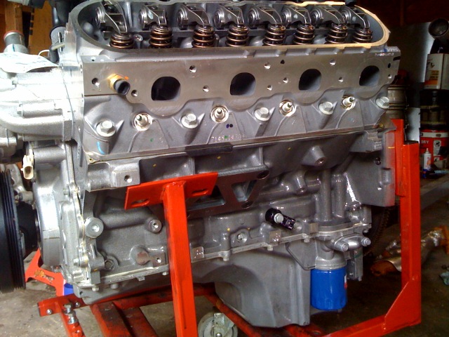

Here is the engine that I got from Shaun. Stock L92.
Andrew

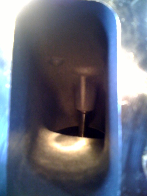

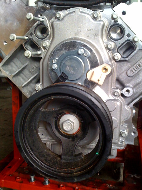

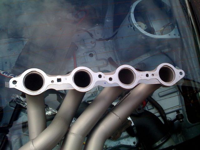

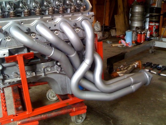

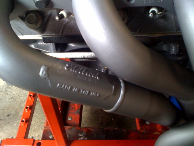

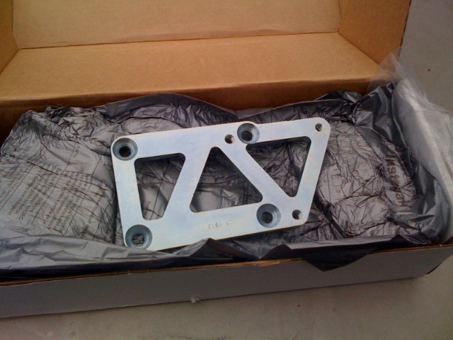

When I got home this afternoon I found some Edelbrock goodies waiting for me. Here are the engine mount plates:
Judging by the engine cradle these mounting plates will put the bellhousing in very close proximity to where it was before. This is critical for me since I am not changing anything rear of the engine.
The Edelbrock headers came with a complete gasket and bolt kit, but I am going to use the stock MLS exhaust gaskets and bolts. The stock gasket matches the headers well.
The headers are gorgeous!!!
The L92s feature variable valve timing. Since I am going to swap cams I will need a non VVT front cover. The balancer will also be swapped over to a C6 Corvette unit.
Shot down the intake port:
Andrew

The headers are just amazing. Here are some more details:
https://ls1tech.com/forums/conversions-swaps/812584-new-edelbrock-body-ls-conversion-package-coming-out-08-a.html
Stainless and coated!
Andrew
