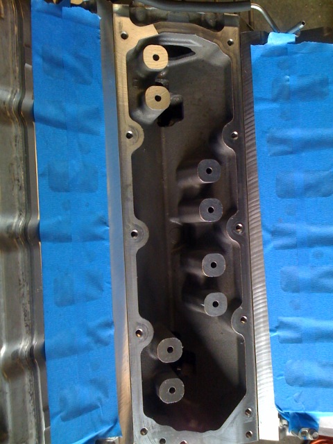

For the sake of my sanity, I removed the lifter valley cover just to double check that this engine does not have Displacement on Demand. It does not.

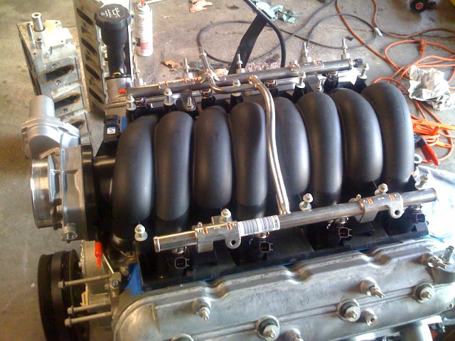

Lots of goodies showed up today including the L76 intake manifold kit:
Andrew

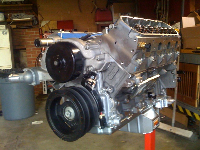

Old Mar 21, 2008 | 07:02 PM
  #35
Project GatTagO's Avatar
Joined: Mar 2003
Posts: 10,617
Likes: 1,883
From: Little Austin

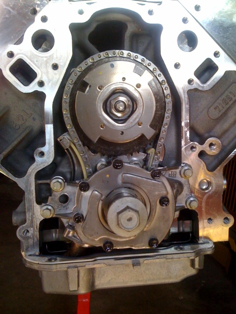

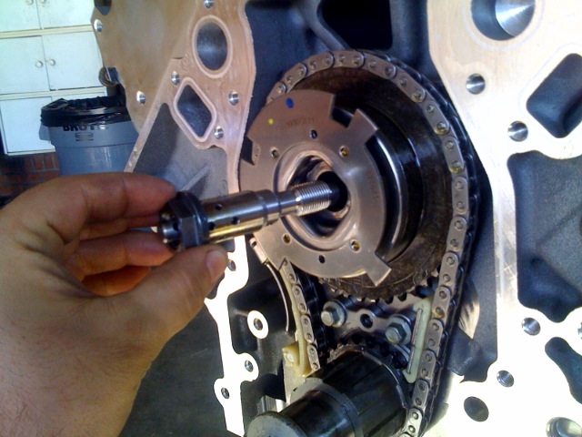

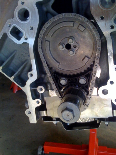

Today I took off the truck balancer and the front cover. This is what the VVT system looks like:
The VVT cam use a single bolt to attach the cam gear and VVT mechanism:
The LS7 cam uses the typical 3 bolt style cam gear. You just have to make sure to get the correct gear with the right pattern of bumps for the cam sensor. I got mine as a handy little kit from Lingenfelter.
Once the cam was installed I bolted on an LS2 from cover along with a C6 water pump and balancer. With the exception of the hollow stem valves, and of course the LS7 cam, this is pretty much an LS3 now.

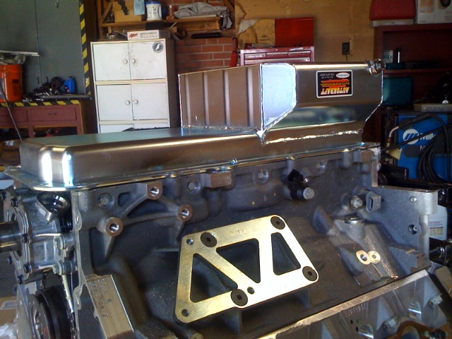

I also installed the AutoKraft oilpan. I really wanted to use an OEM style cast pan, but no one seems to agree what pan will work best. So I went with something that is proven to fit and retains the oil filter in the stock location.
Tomorrow I will be installing some Patriot Gold dual springs and doing some minor detailing.
Andrew

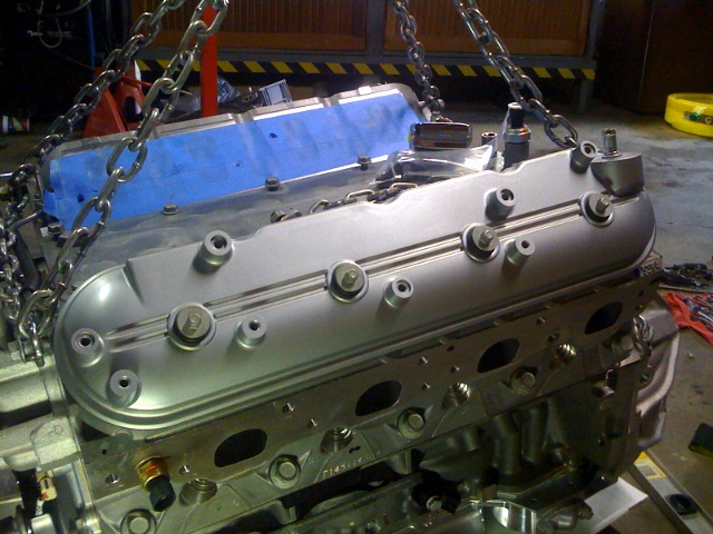

Old Mar 23, 2008 | 06:48 PM
  #36
Joined: Mar 2003
Posts: 10,617
Likes: 1,883
From: Little Austin
More progress over the weekend. I finished installing the Patriot Gold dual springs and hardened pushrods. I am pretty sure I went overkill on the springs, but I figure if I don't like this LS7 cam, I can just stab another one in it without having to worry about the springs.

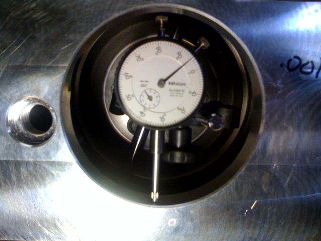

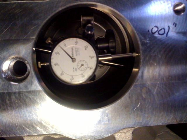

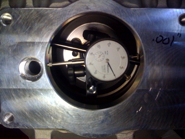

Next I wanted to check the alignment of the Keisler bellhousing. I took the engine off the stand and placed the bellhousing against the block. Tick, tick, tick, tick...it was rocking back and forth. No good. I inspected it and it looks like someone dropped the bellhousing after it was machined. It put a slight dent on the corner and didn't allow the bellhousing to sit flat against the block. Little work with the file and it was good to go. This is a perfect example of why parts should be mocked up before installing them in the car. I may not have noticed this if I was on my back, under the car, trying to install it.
Next I wanted to check the alignment. I first measured the flatness. Very impressive, at .001".

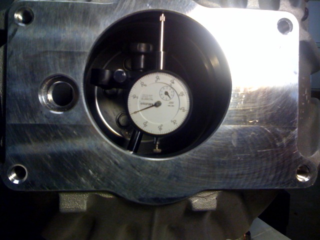

Next I wanted to check the runout. I installed the dial indicator so it would ride on the inside of the bearing retainer register. This is what centers the transmission in the bellhousing. I set the indicator to zero.
Rotated the engine 90 degrees. Still zero. Good.
Rotated another 90 degrees. .005". Not bad.
Rotated another 90 degrees. .004". Great.
So the most the needle moved was .005". Divide that by 2 and you get total runout of .0025". Well under the recommended .005". Other than the minor issue with the bellhousing, I am pretty impressed.
Next it was time to see how the input shaft engages the pilot bearing. I am using a stock LS7 pilot bearing. I am happy with the engagement.

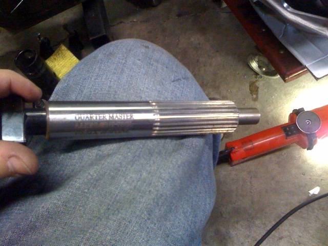

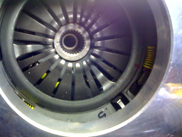

Then I wanted to install the clutch so that I can take some measurements for getting the right hydraulic throw out bearing. Everyone should have a nice clutch alignment took. This one is from Quarter Master and is way better than a plastic one.
There you have it, clutch and bellshousing installed. I am using a stock LS7 clutch on an LS2 flywheel. Heavy, but it will drive great. The distance from the clutch fingers to the outside of the bellhousing was 3.25". I will elaborate on why that's important later.
I used some high temp "cast aluminum" paint to add a little detail to the valve covers.
Time to start working on the car and get it ready for the engine. I want to redo some of the wiring as well as some of the fuel lines in the engine compartment.
Andrew

Sure, mock me for using a LS7 clutch and then go and use one yourself
That isn't a clutch alignment tool - it is an input shaft

I am mocking myself for using that damn thing. It's a ******* truck clutch. Then again my GTO is no lightweight. The heavy clutch, combined with a mild engine will make the car very easy to drive.
Anyone still using those plastic donkey dick alignment tools should really get one of these. It squares the disk perfectly and the transmission just slides in without hassles. Best 30 bucks you will ever spend.
