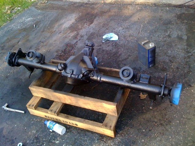

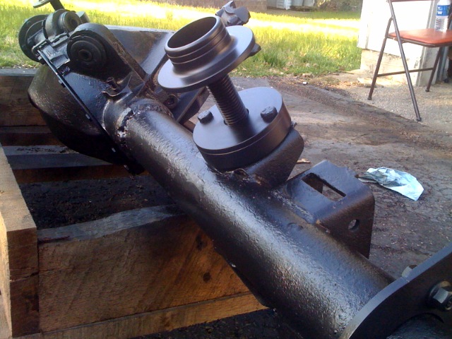

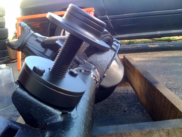

Today I worked on the rear end. I degreased it and gave it a rattle can make over. Along with the cosmetic touch up I installed new upper control arm bushings and finished up the installation of the weight jacks.
If anyone else is using these weight jacks, I would highly recommend painting them. They are steel with a black oxide coating. I already saw signs of surface rust after sitting in the garage for only 2 weeks.
Tomorrow the rear end will get plugged back in and I will start on the wiring. With any luck, the engine will be going in next weekend.

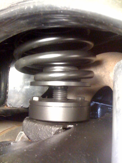

What height of rear springs are you planning on running?

I got some 9.5" tall springs, 175lb/inch.
This is what the spring looks like with the car on the ground at the new ride height:
Before, it was 28" from the top of the wheel well to the ground. Now it's at 26". Looks great.
I have to make some sort of rear axle retention strap. Since the car is lowered the shock is too long to keep tension on the spring when the suspension is extended.

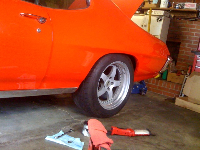

It is amazing what difference 2" in ride height makes. The rear seems to sit so much lower now. I am sure part of this is due to the fact that I have tall tires and now they looked tucked inside the wheel well.
