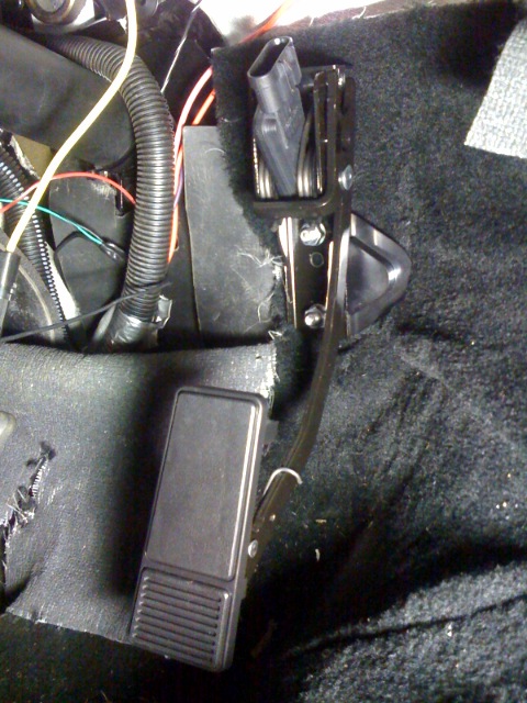

Sometimes one has to wonder, "WHAT THE F**K WERE THESE PEOPLE THINKING?" GMPP did a very nice job coming out with a harness and ECU combo that was priced right, fits well, and is easy to hook up. Then you realize that the engineer who speced the gas pedal has never turned a wrench in his (or her) life. The pedal that they send with the harness kit is on the right:
It is HUGE and looks like it belongs on a dump truck. I can't imagine that it would fit into any car or streetrod etc...
Thanks for Jeff Schwartz, I got an alternative. The pedal on the left is from a 2007 Monte Carlo SS.
Nice and tidy, with an easy to mount flange. I was able to position it exactly where the old gas pedal was. I even used one of the original holes, drilled an extra hole, and was done.
So with some luck, I hope to drop the engine in this weekend.

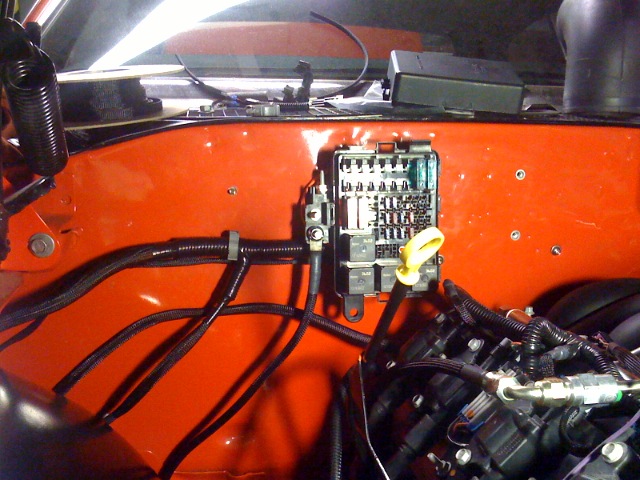

Today I finally got done with modifying the GMPP engine harness. There were a few things that I did not like about it and I also wanted to give it some custom touches. The thought crossed my mind to completely reloom the harness, but I decided against it. Once I got the harness all hooked up and routed, it was pretty obvious that most of the harness is not really visible. It tucks very nicely behind the engine. The most visible parts are the extremities. The little branches that go to the various sensors, throttle body, and injectors. So I addressed just those areas. Here you can see how I kept the main branch of the portion of the harness that tuns along the fuel rail. What I did reloom were all the little fuel injector sections. You can also see the fuel line. It is a smooth bore Teflon braided stainless line that I covered with the nylon loom material.
Here you can see a section of the harness that had several branches going to the coolant temp sensor, alternator, crank sensor and MAF. It looked like this:
I changed it to this:
Not a huge difference, but a small detail.

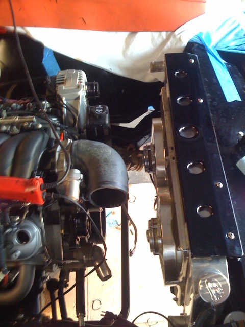

Look at all that room even with the radiator installed. I love the Corvette accessories. Plenty of room on the passenger side for a GT42R.
I would say 75% of the engine is behind the front axle centerline. With any luck this thing will have about a 50/50 weight distribution.

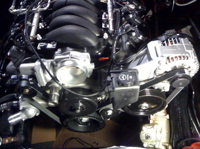

I am using a Katech tensioner. On my RX7 with the LS6 I had some issues with throwing the belt. Part of the problem might have been the fact that I was not running a power steering pump. Part of the problem might also been that I had a flywheel and clutch that was less than 20 pounds, total. So this time around I wanted something that would allow me to set the belt tension. It also adds a little bling.

So I am down to all of the little details that can take a long time to get done. Basically I am down to "connecting the dots." I got a small tube that goes from the power steering reservoir to the power steering pump. That allowed me to install the power steering pulley and finalize the accessory drive with a belt. I really like the Katech belt tensioner. I had some belt throwing issues on the RX7 and I am sure that this will cure any potential issues.
I also mounted the fuse and relay panel that came with the GMPP harness. Originally I thought I wanted to mount it on the radiator support. This would have made it less obvious. The downside to that is that all of the wires would need to be lengthened. I really didn't feel like doing that. Having it on the firewall gives me quick access to all of the fuses and the relays. There is also a "check engine" LED installed in the fuse panel. Having it on the firewall will allow me to quickly glance and see if there are any trouble codes. The number one reason for putting it on the firewall is that it allowed me to cover up some of the holes that were there from the coil and ignition box.

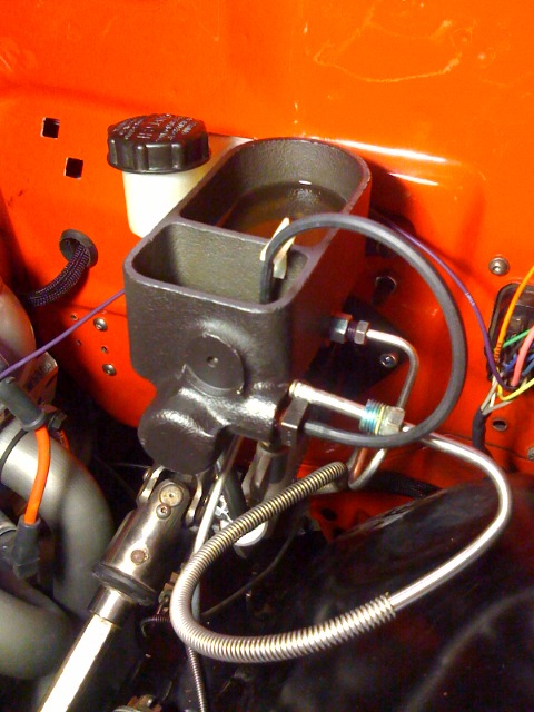

I also installed and bled the new, .700" bore clutch MC. The Keisler kit came with a .750" bore but I wanted a softer pedal and less bearing travel. You can see the hardline going from the MC down along the frame rail. It then mates with the braided line coming off the throw out bearing.
Speaking of MCs. I also changed the brake MC. This one is a 15/16" bore MC from a 1979 Malibu. While I had no issues with my S10 quick take up MC, I was a little concerned about the shallow pushrod dimple. This MC has a very deep pushrod hole as well as a little snap ring that keep the pushrod retained inside the MC.
