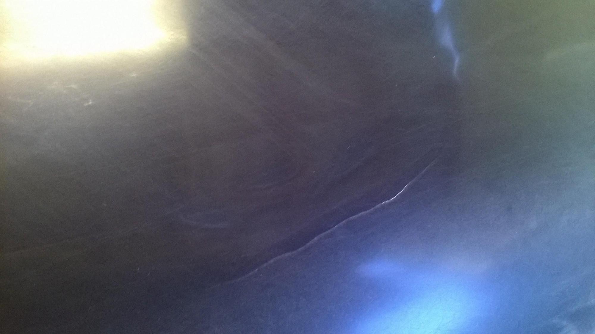

Progress has been slow since work has taken most of my time. I decided to repaint the car while it was pretty well stripped down to nothing. The color is Electric blue pearl from a 07 Dodge Ram.
