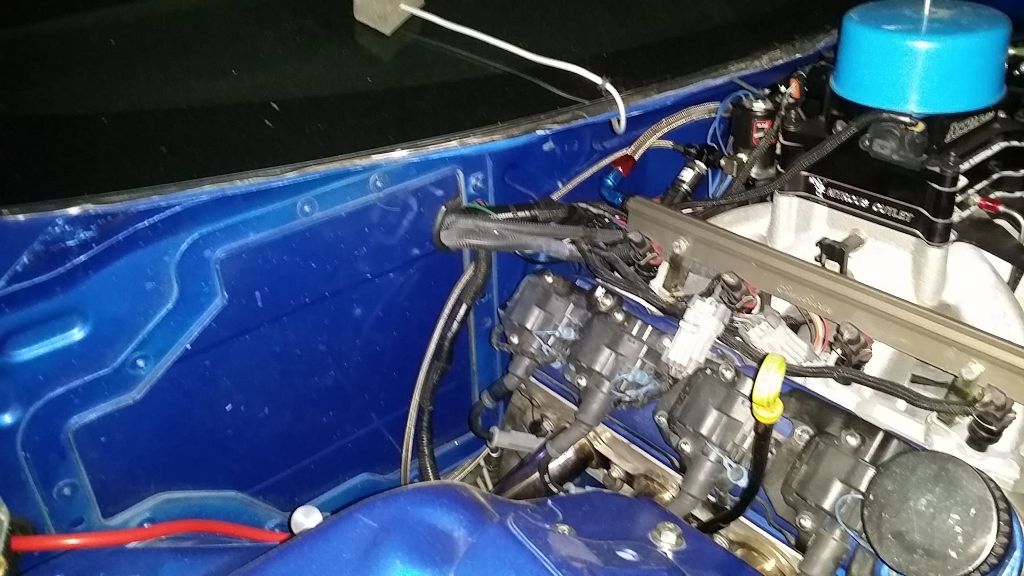

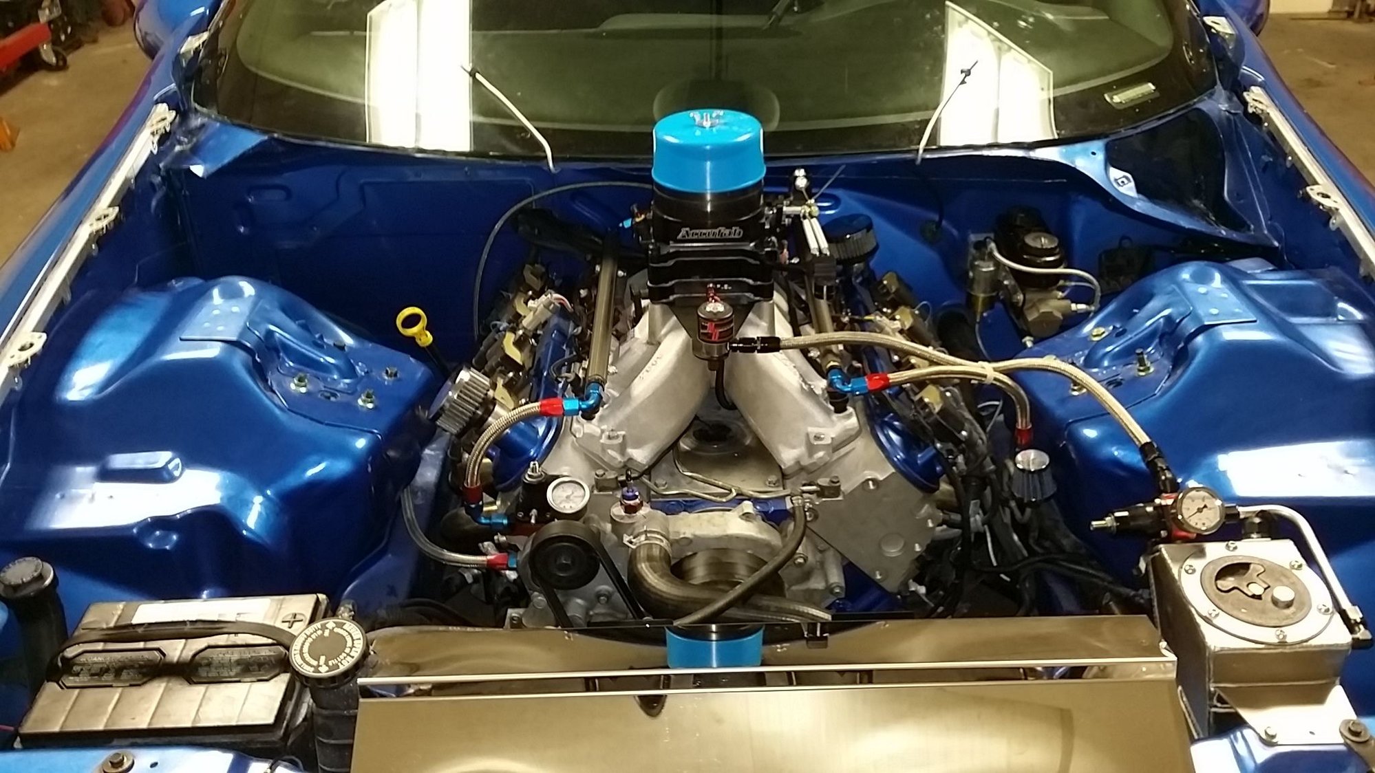

Do you have any pics from the engine bay side?
Old Jan 31, 2016 | 02:51 PM
RobsZ28's Avatar
Joined: Sep 2010
Posts: 411
From: Mesa, AZ
Here are a couple
Wires aren't very noticeable for the most part.

Thanks. Man all the room is that bay is great

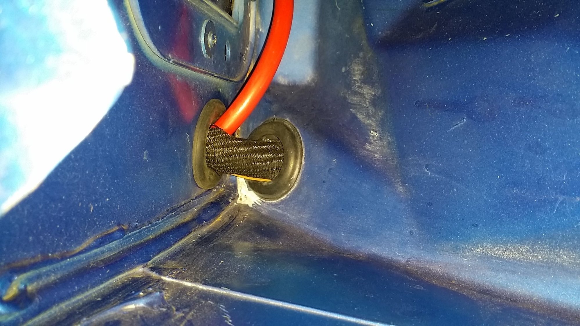

awesome guys thank you. RobsZ28, where did you hide the wires that run along the strut tower?
Old Feb 3, 2016 | 12:05 AM
RobsZ28's Avatar
Joined: Sep 2010
Posts: 411
From: Mesa, AZ
They run through the underside of the passenger fender, just like the regular wire tuck mod.
