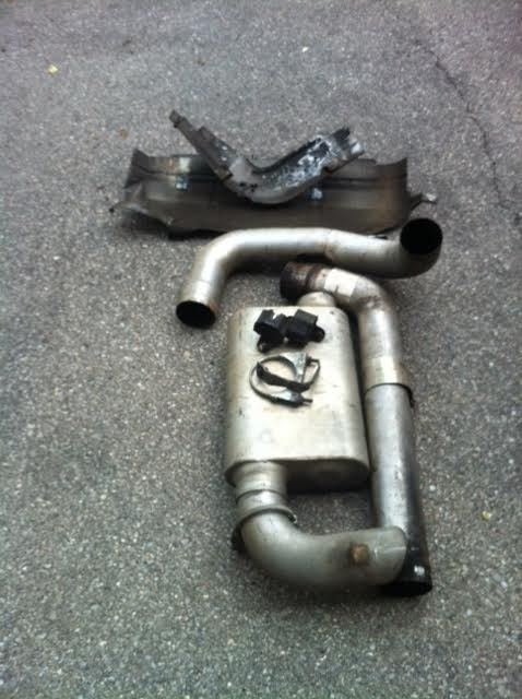

45 lbs Mufflex 4" cat back with flowmaster
5 lbs exhaust heat sheilds
