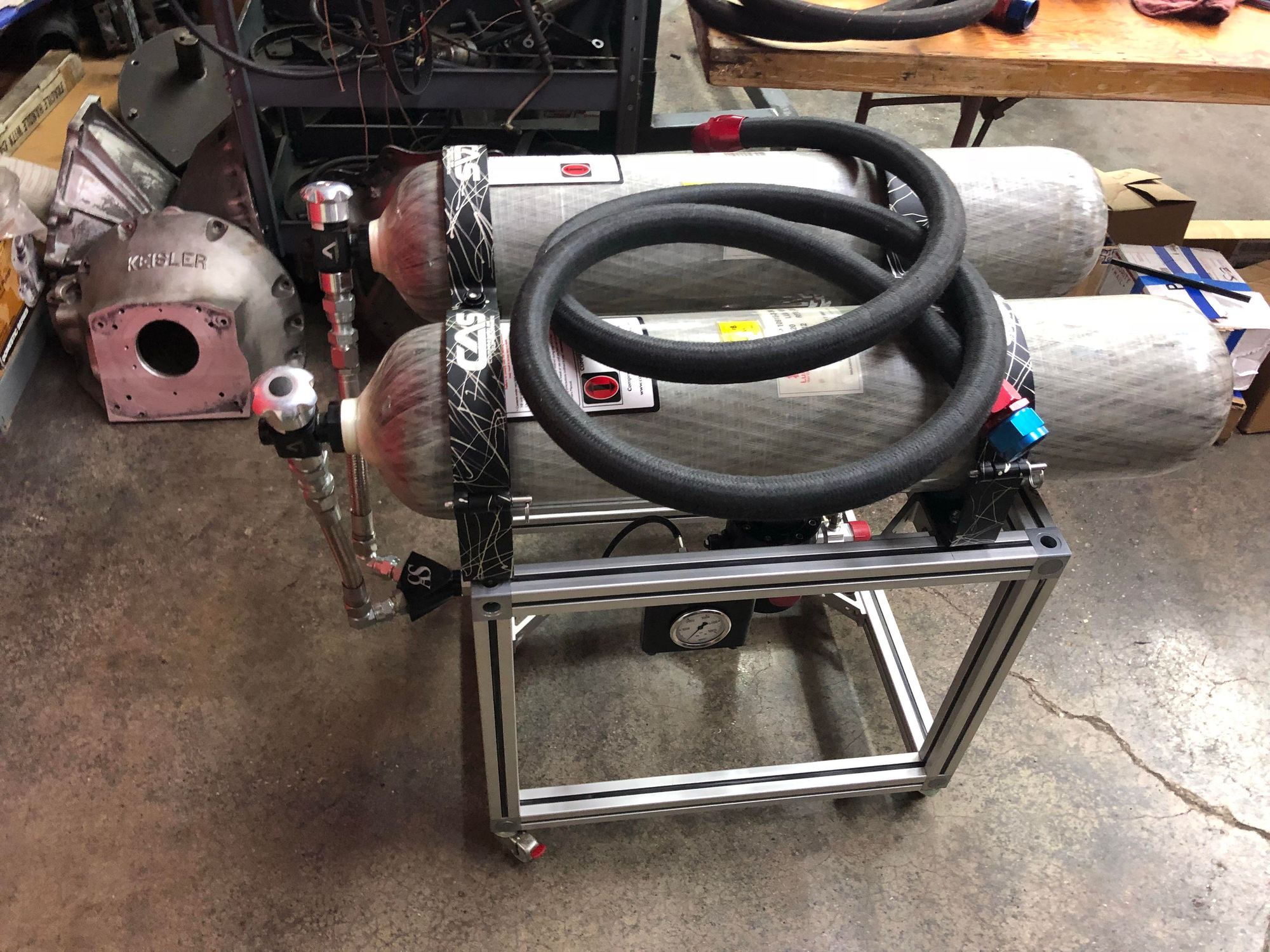

We had the pleasure of tuning and doing testing on a unique Nickens 565 big block chevy at Nickens Brothers Racing Engines using Holley EFI with the guys from Compressed Air Supercharging. Their compressed supercharger system (CAS) doubled the horsepower and tq of the 565 at 5-6 lbs of boost by 6,000 rpm from the compressed air. It was an awesome experience working with the crew from Nickens and CAS on this project. We will try to post some video's of the dyno runs.

Are those pressure-activated one-way valves in the intake tubes?
How many quarter-mile passes are they expecting with those two bottles feeding that engine? I mean, do you recharge after each pass, or can you do a few passes, or...?

The valve at the very end of the intake closes completely when the system turns on and the motor runs on compressed air only. The next valve done the intake is a DBW TB that that control what % the intake is open, its how they control the compressed air. We were running it 100% wide open one system and could only do one dyno run on 2 full bottles. On that motor it would not make it through the 1/4 on 2 bottles.

A few really dumb questions:
How do you fill the bottles up at the track?
Will a standard portable air compressor work?
Optimal PSI of the bottles?
Weight of the whole kit?
Do you run a filter to keep water out of the lines?
need 4 mother bottles
no
3200 psi
not sure
didnt see one
see replies above

UHP (32'000 PSI) Bottles will fill a 3200PSI bottle multiple times..
Straight compressed air bottles are relatively cheap for welding suppliers,, You can get real really big ones too..
The bottle need regular hydrotesting if they are dumping from full to zero ,,, the expansion and sudden compression of the bottle ages them.
The caveat,, Most tracks would not if they had any common sense allow a bottle in a car without some pretty extreme containment.. At least for the valve..
I dont do this on a car but I used abuse the bottles in a similar fashion in construction..

The tanks they use in the car arent normal welding supply store tanks.
They have had the camaro tech'd at a track and contacted NHRA about it and havent been told no yet.
