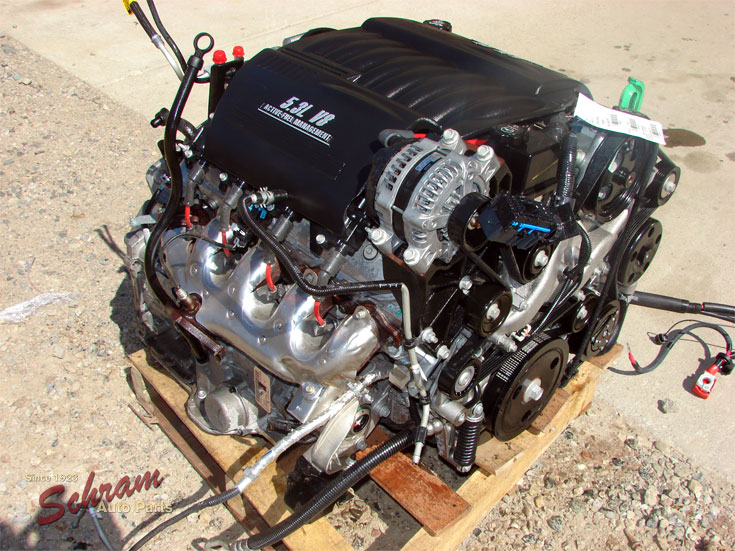

im turboing a 5.3 ls motor in a thirdgen. and i have tried the truck maniflods.. they just dont work... i need the maniflods to be closer to the motor. the bow in the truck maniflods kills me from using them on my 86 camaro... would the f-body manifolds or the Monte Carlo SS manifolds work better?

Originally Posted by 87silverbullet
I think you need the front wheel drive manifolds because they hug the block better.
anyone have pics??

nastychevelle's Avatar
Joined: Jul 2008
Posts: 934
From: troy, IL
Old Mar 1, 2009 | 09:07 PM
1nasty86's Avatar
Turd Gen Guy
iTrader: (63)
Joined: Dec 2008
Posts: 1,532
From: andalusia, alabama
the other maniflod looks like it wouldnt work???
Old Mar 1, 2009 | 09:08 PM
Joined: Jul 2008
Posts: 934
From: troy, IL
cant get much closer

im wanting to use the maniflods for the turbo.. on the ls4 there is a crossover tube that connects one maniflod to the other and then the exhaust goes out the other manifold... i would have to cut this off and weld it back... on the manifold closest to the firewall... im thinking the f-body maniflods would be best... i have clearance issues with the 03' truck manifolds i have now...

if you can find 2 of the front LS4 manifolds it would be best they snug up real tight and then just make yourself a crossover

this could work... but who has two front ls4 maniflods??? lol
Old Mar 1, 2009 | 09:42 PM
Joined: Jul 2008
Posts: 934
From: troy, IL
ebay my friend lol or car-part.com or a junk yard
