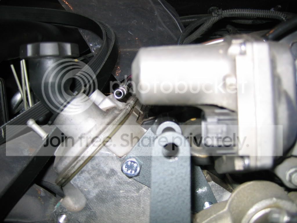

Just a heads up to others, these do not work with a DBW throttle body. I'm going to flip the TB and see if it hits the PS pump on the other side or not yet.
Old Aug 1, 2011 | 08:07 AM
  #179
ModularTurbo's Avatar
FormerVendor
Joined: Jun 2008
Posts: 1,765
From: Homestead, FL
If you don't mind taking a few measurements and working with Chris and I, Chris will build you a bracket that will be DBW friendly.
Old Aug 1, 2011 | 08:49 AM
  #180
Adam 442's Avatar
Joined: Dec 2004
Posts: 14
From: Saskatchewan Canada
That would be awesome! What do you need for measurements? I won't be able to get them until next Sunday, but will get what ever you need. I hope you didn't think I was saying anything bad about the product, it looks great and I took the chance it would work for my GTO.
