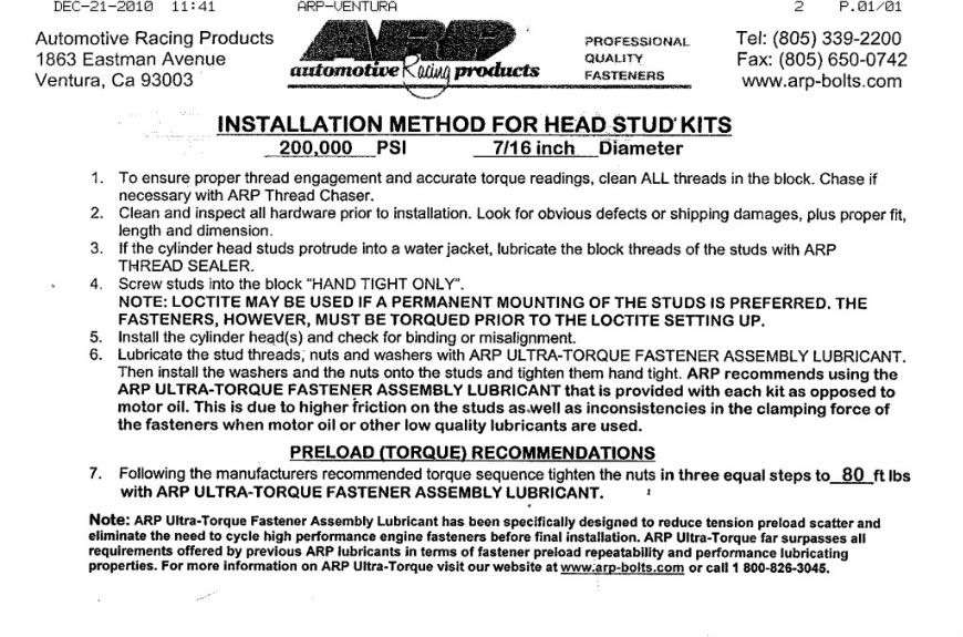

Originally Posted by 67Firebird455
Wow, I'm surprised 80ft lbs isn't distorting the block.
Do you have examples of LS blocks distorting from this?
80ftlbs is the ARP spec.
