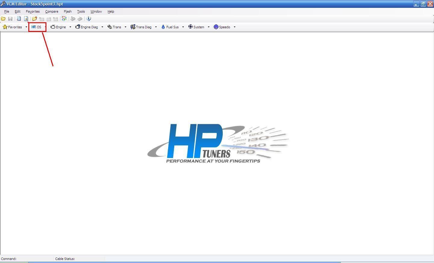

Starting out from a stock file and going to a 2 bar Speed density. This is not complete yet!
I'm just starting out but as I go along, I'll get to all the elements of setup , then using histograms and Real Time Tuning...
Reminder before you start:
Save your stock initial flash file with a unique name and save it to two or three different locations so you have a recourse if you ever need to start over or refresh some table(s). I save mine to my laptops harddrive in a specific subfolder, then again on a thumbdrive and lastly, I email it as an attachment to myself. Use a COPY of the original file to start your tuning.
Opening up the Operating system...
Viewing to see current OS...

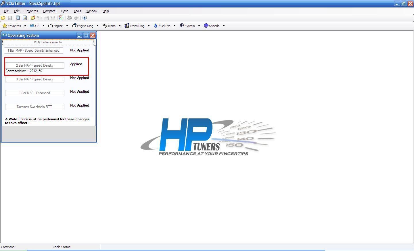

Select 2 bar Speed Density...
Selected...
Save changed flash file with new name...
Write the 2 bar SD to the PCM now...

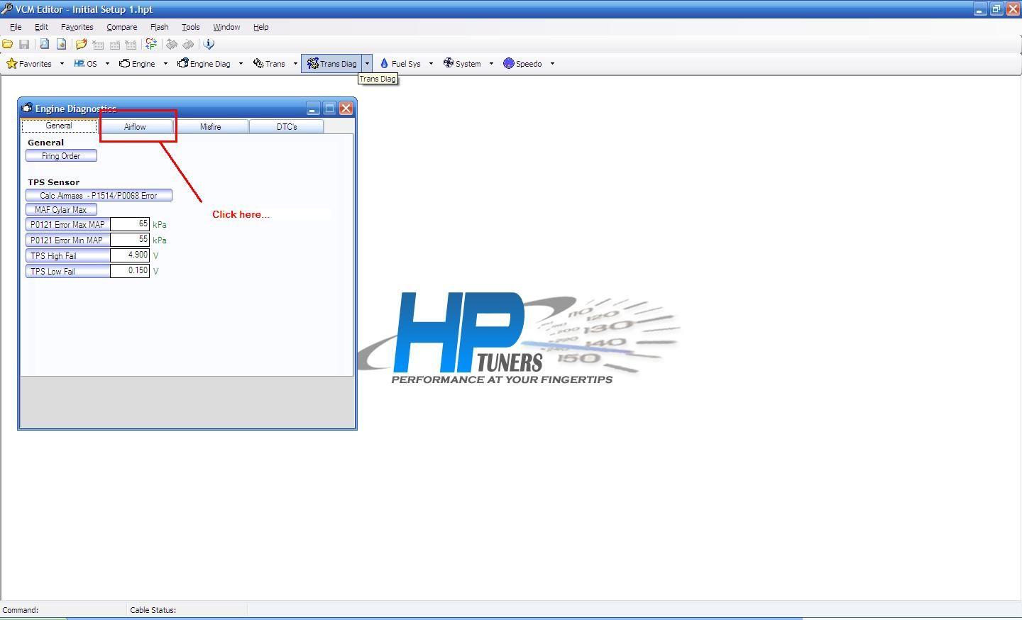

Now, lets disable the MAF Sensor ...
Select the Airflow tab....

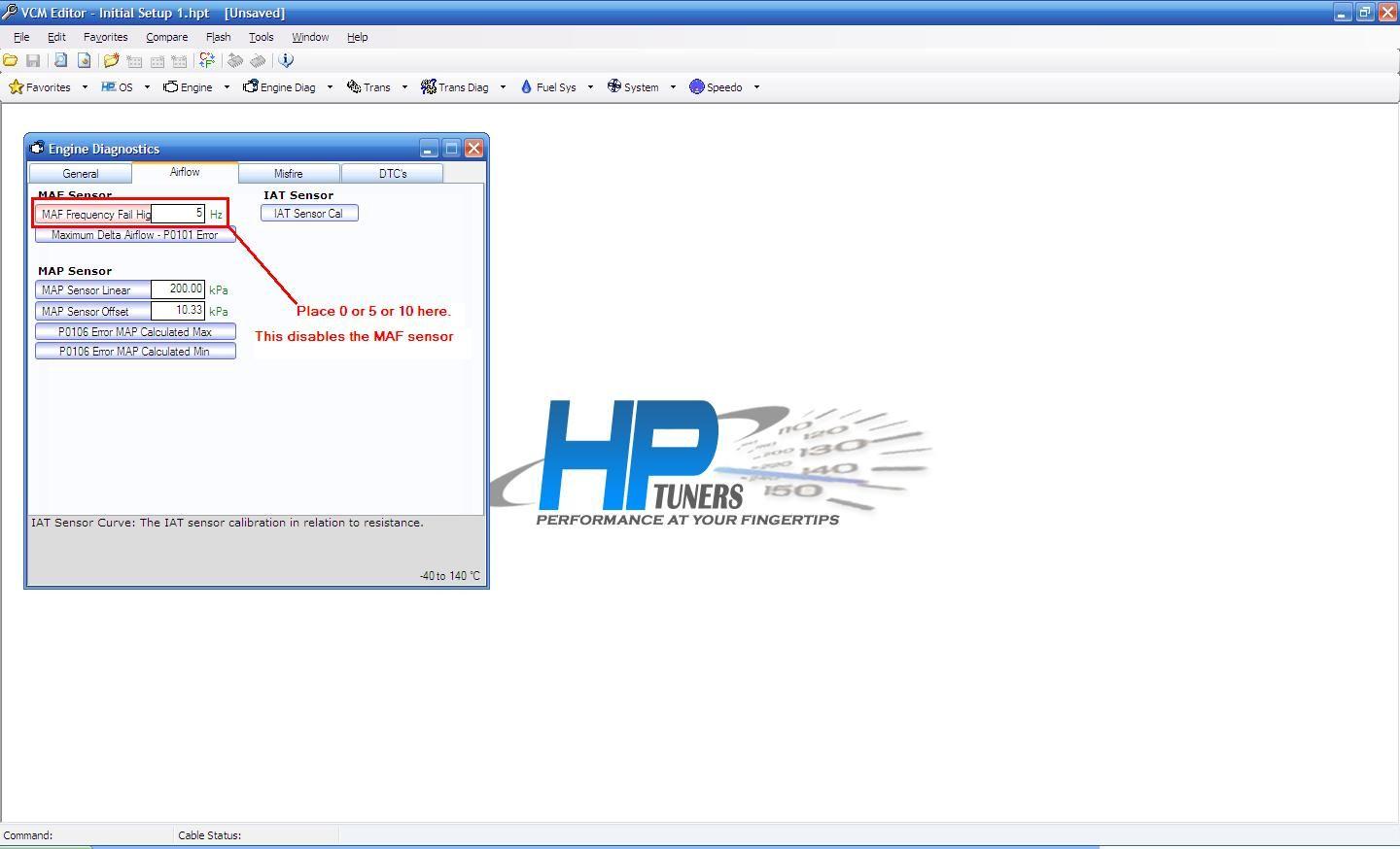

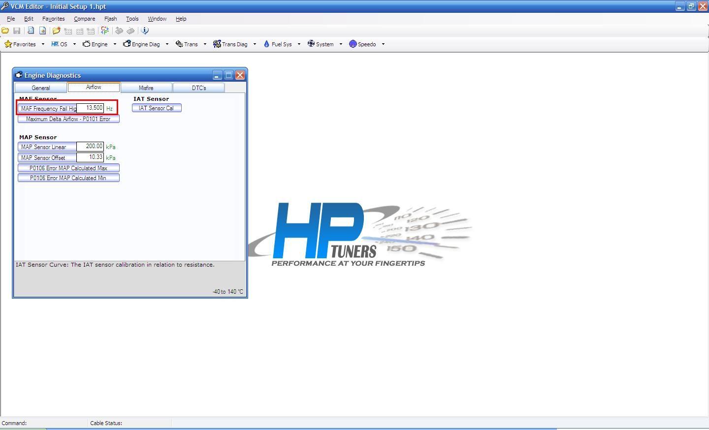

The MAF setting before...
The MAF setting after (disabled)...
