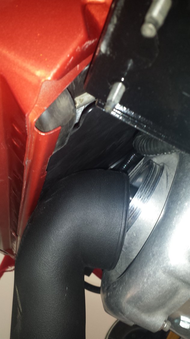

As the title says I need help with my Procharger Truck Hat installation. I have a 02 ta with Procharger F1A with stock rad and procharger shroud and Spal 9" an 16" fans.
With rad in the factory location in the front rad support I can't get the truck hat on the supercharger. The hat is tight up against the procharger fan shround. Anyone have any ideas.

You might need to just give up and move the radiator.

Wish I could help, because I'm going to be doing the same exact thing. What about cutting out a spot there in the radiator fan shroud for the hat to sit there? I think I'm going to try that.

Simple fix, trim about 1/2 inch off where it connects to the procharger. I just went through all this about 2 months ago! I used a pair of Wiss Aviation snips, I think that was the name. Use whatever you got to trim it down and tighten it down with a T-Bar clamp.
Clamp size is 4.25 or so, Vibrant Performance. The 4.05 size will be too small!

A belt sander would make quick work of trimming it down and it would be a straight cut all the way around.

This is exactly what I did when I had an F1a on my car. I ran into the same problem. I removed the fan shroud and used a die grinder to cut a square out of the shroud so that the hat would clear. Chances are u will have to cut and reinstall the shroud a couple of times to get it perfect. I wanted to leave as much of the shroud intact as possible.
I then came to realize that the hat also contacted the lower radiator support in that same area so I used a grinder to clearance the support where the hat was contacting it. With a little trimming it will fit in there but it is very tight.

You want to remove that metal ring regardless. There is no way it will fit on the blower with that ring in place. Even after removing it i had to cut a slit in the hat so that it would fit onto the inlet. Used a t bolt clamp to secure it once i finally got it on there.

The metal ring has to be removed regardless if it is a D-1SC or an F-1A. Bob

Good point and it is way to dusty where I live to run no air filter. My car is a summer time cruiser and not a drag car. Seems like notching the fan shroud might be the easiest after all.
