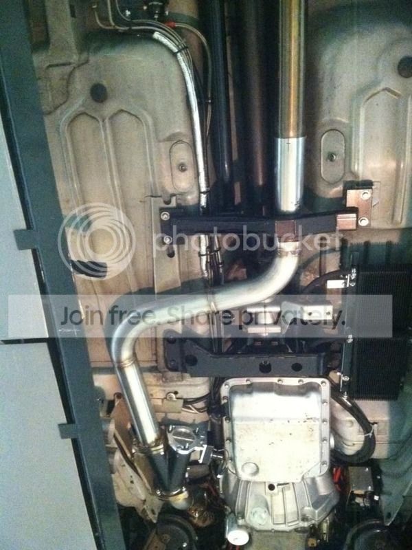

While I'm waiting, i have been doing some research on my exhaust setup. Right now, its open downpipe. I do have the corsa catback on the car but I need a custom intermediate pipe made. I found this, which is pretty much what I need:
My question is, should I get a cutout also? Am I leaving power on the table by NOT getting a cutout? Whats everyone's thought on that?
Not only are you leaving power on the table, by not having a cutout.... it will spool slower.

how big is your catback? im debating leaving the stock exhaust on and running just a Ecutout because there will be too much back pressure with the stock exhaust in boost im guessing.... my cats are deleted and i have a magnaflow muffler though

You will want a cutout for sure. When I had a 7875 turbo on my car I had 3" exhaust all the way out but had a 3.5" cutout under the passenger seat. With it closed it would make 10 psi on spring pressure and opened it would make 14 psi. Even if I turned the controller on with the cutout closed to make 14 psi it would still feel a lot better with the cutout open on the same boost level.

Welp, that answers that! Thanks guys.
Its the Corsa so it is a 3" catback as well as my downpipe.
