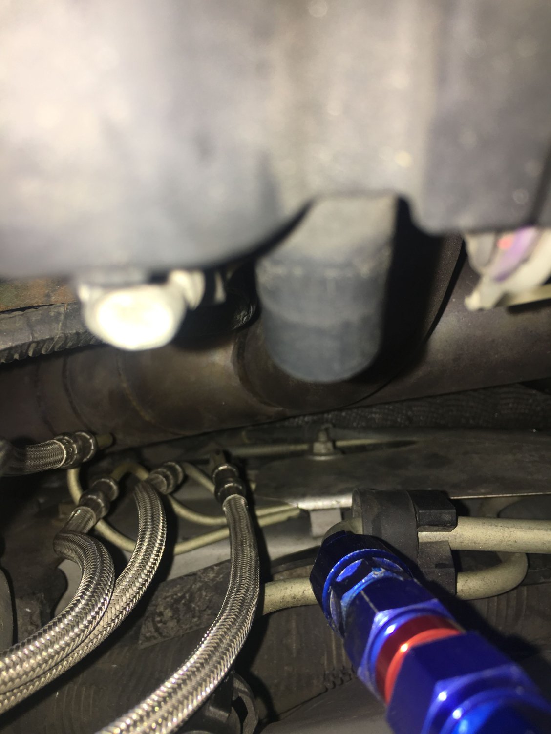

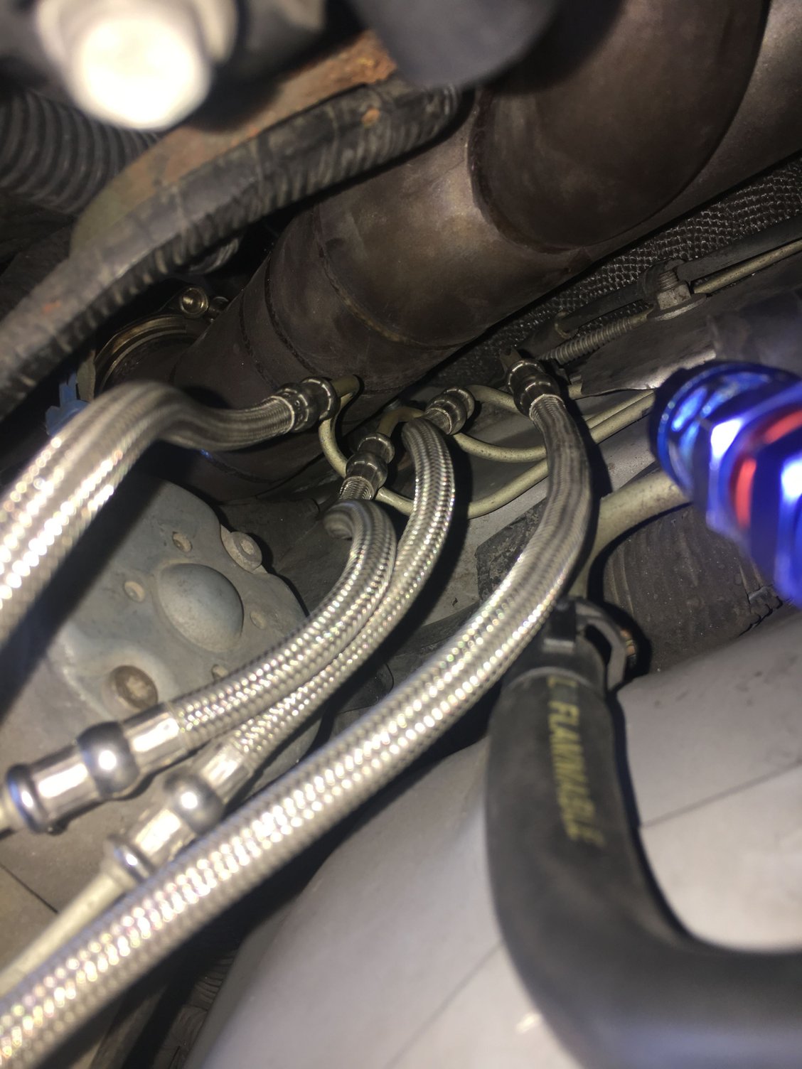

Didn't feel like going through your whole thread again so forgive me lol but did you have any issues fitting the driver side header around the hard brake lines running to the abs block? I bent mine as far away as I could and wrapped it and still burned through the hard line 😠

There is a plenty of room to move those out of the way for proper clearance. If you burned through a hard line my best guess was it was resting on the exhaust, need to gain a gap there which we have never had an issue doing. Shoot me an email, some photos, etc and I would be happy to assist you! Always willing to help customers!

Pretty sure he just posted that he DID move the brake lines, so obviously there wasn't enough room.

You definitely have to bend them out of the way but it's not a big deal. There's no way to burn through a line without them sitting on the actual manifold. Even a slight air gap would prevent that from happening much less wrapping them. It's easy to miss and then let them sit there for a bit and then when you try to rebend them after they've sat there for a while they crack. Hard to see in the pictures, but I bent mine and they all have at least a finger widths gap and I haven't had a problem with them at all. The pictures make them look much closer than they actually are.

Is boiling brake fluid a concern given the close proximity even if it doesn't touch?
