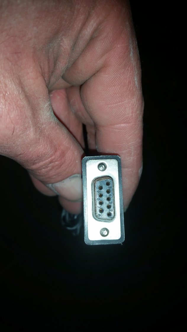

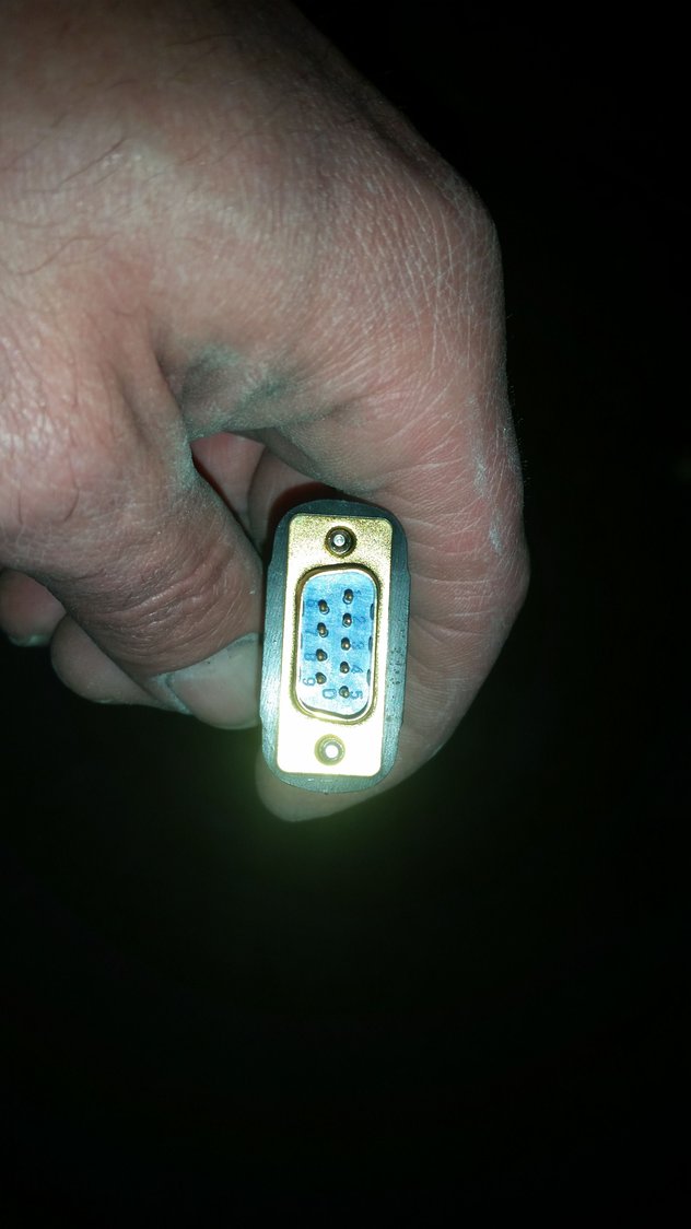

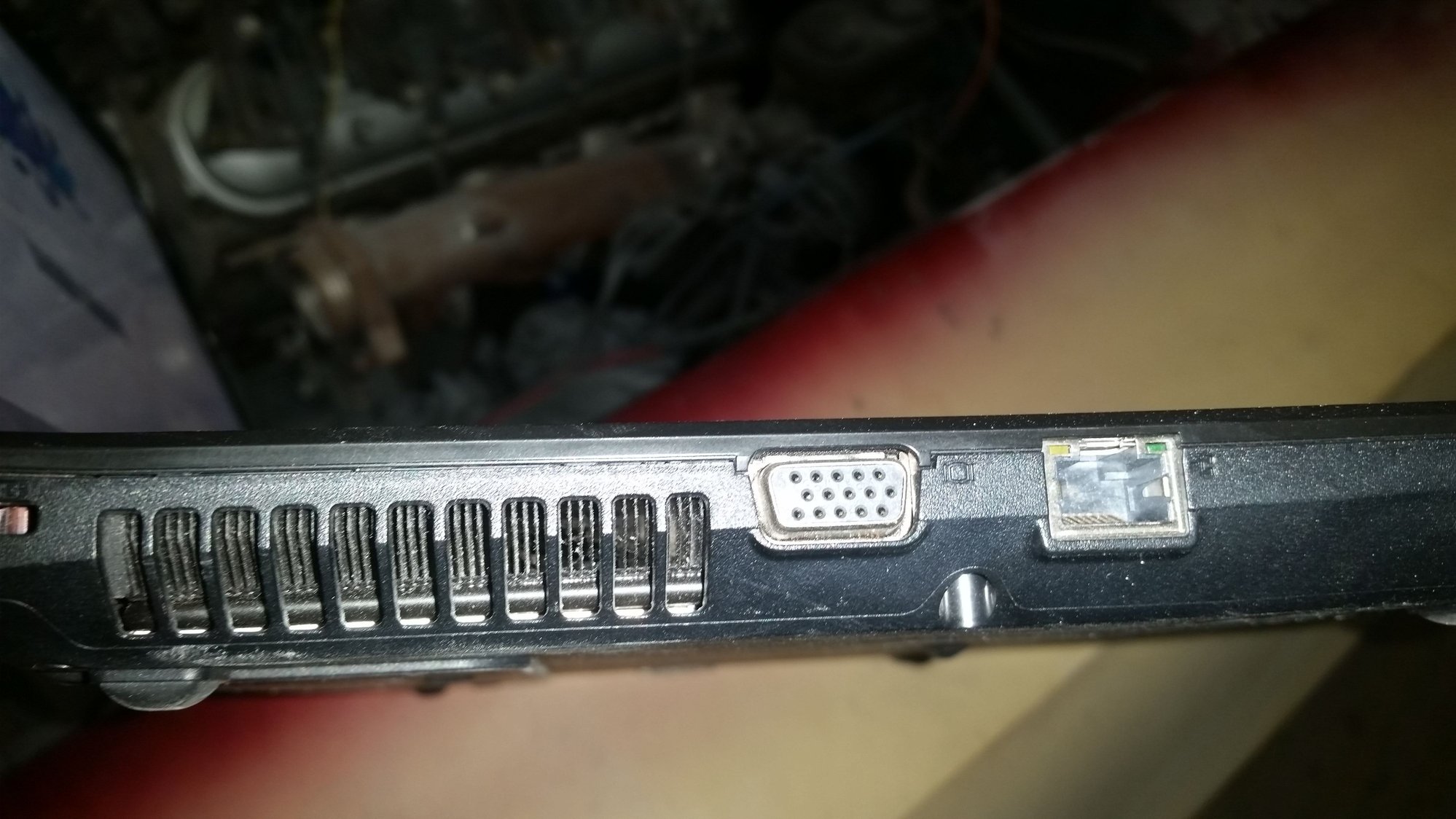

The problem I am having is the microsquirt comes with a POS cord that doesn't connect to any computer so I bought the adapter cord from radio shack and now no communication with the microsquirt the adapter plugs into to the USB port does this thing have to plug into the serial port?what a piece of sh##t

You need a usb to serial adapter. I recommend the Belkin brand.
The MS stuff has always used this setup. It is not a POS. It is all a learning curve and this is just part of it.

you can not just hook it up and it will work . you need to hook up the cord open tunerstudio, power up your microsquirt then on your laptop go to file in the top left corner and open project it will ask you to detect . once it detects the micro it will prompt you thru a few questions and you will be able to tune the current tune.
if you have one of denmahs tunes in your desktop you can go to file and open new project and load that tune from the desktop then go to communications and set all of your calibrations. you need to set
tps calibration,at the minimum. if you are running a denmah tune the rest should be set about right except setting your o2/wideband .
if you do some looking denmah has a video of connecting a laptop to your micro and getting up to speed. helped me a ton there is also some good reading on the msextra forum about setting up and connectiong. I did some google searching on how to connect laptop to microsquirt and found a bunch of stuff that helps.
I was confused at first but after taking the time to learn what I was trying to do it was a snap. good luck.

You're best buying an old laptop that has a serial port. Adaptors can work, but they can also be a pain in the hole.
Most ecu's have moved away from serial comms, which makes sense given few laptops over the last 10 years or so have them !

ok finally made it work with the USB adapter and have communication with the computer part of the problems were the back of my microsquirt label says microsquirt v3 so I loaded microsquirt 3 software from the website that made a mess so once I found out I needed microsquirt 2 firmware it usually has communication to the computer and loaded denmah fairmont 2 gas tune on it to start
