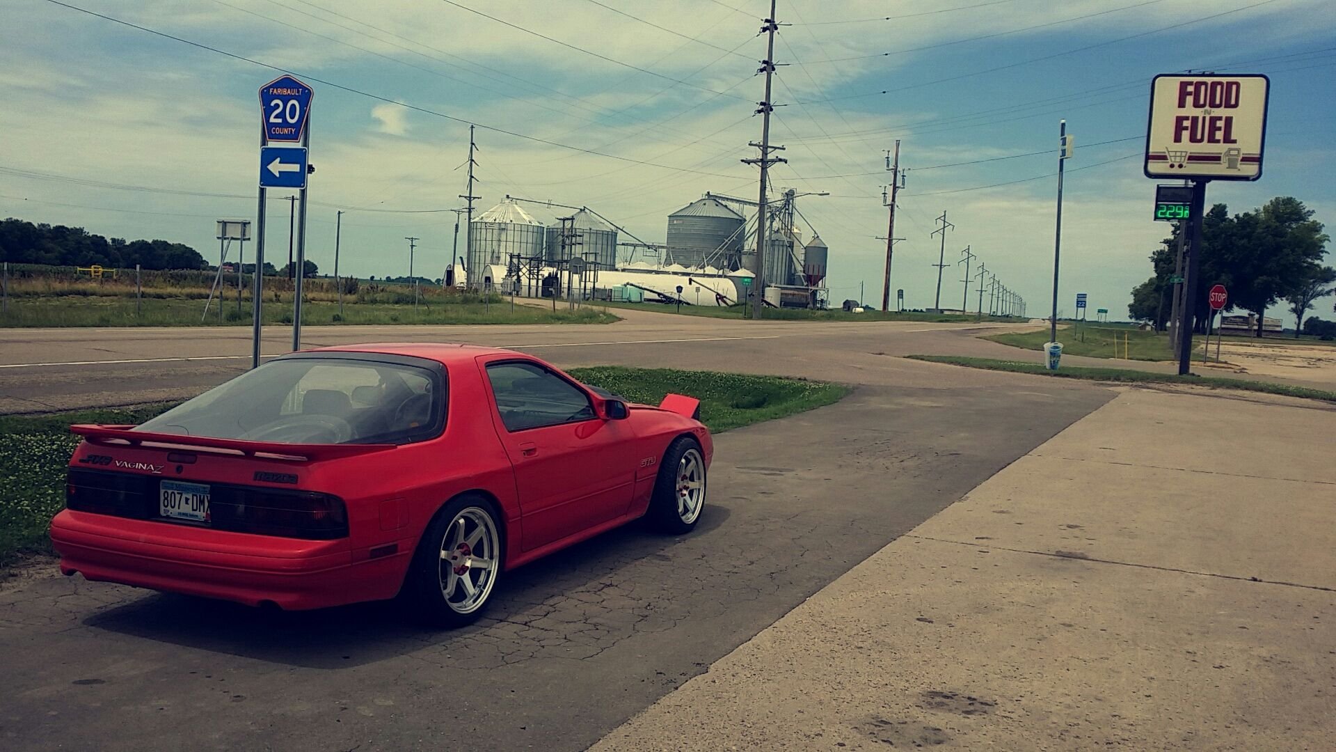

Car
1990 Rx7 FC T2
6.0L / T56 4.10 gear LSD 24in tire
FA500 coil overs
Poly bushings in front
Spherical in rear
Tehls suspension angle kit (70° of steering lock it's nuts)
Completely stock bottom end on the 6.0 I just found out it is a gen 3 motor with gen 4 internals so ..... it sounds like I should EASILY hit my goal of 600whp with everyday reliability and decant longevity I know nothing lasts for ever but if I can get 2 years out of it I'll be happy

that car looks pissed
