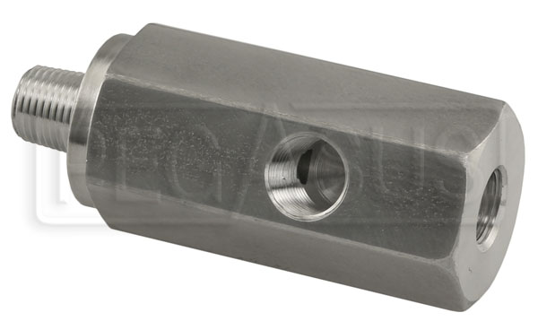

I plan on running an oil feed line off of a oil cooler line block off plate adapter above the oil filter but I am having a hard time figuring out the parts needed to also include an oil temp sensor as well. all of the adapters appear to not be able to fit the length of the temp sensor . With T fittings I feel like the sensor would block a lot of the oil flow to the feed line.

the best option i have found is something like this but i can not find it with only 1/8NPT i only see BSPT threads. i still have a concern with the temp sensor blocking the port for the oil feed....
thoughts? anyone using this setup?

http://www.holden.co.uk/displayprodu...?pCode=070.255 Is what I used. The oil sending unit goes on top but it's got a 1/8 npt hole for filtered oil feed/aftermarket oil pressure gauge.

did you use yours with temp sensor or just a pressure sensor? the temp sensor is a bit longer and i am concerned it will block oil flow to the feed lines
Old Sep 1, 2016 | 01:56 PM
rworcester's Avatar
Joined: Aug 2016
Posts: 92
From: Florida
I'm using the stock oil pressure sensor. Then on the npt hole, I'm using a T for both turbo oil feed and pressure gauge on the dash.
