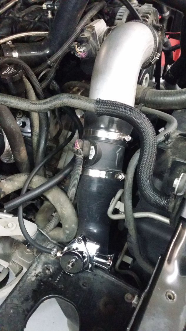

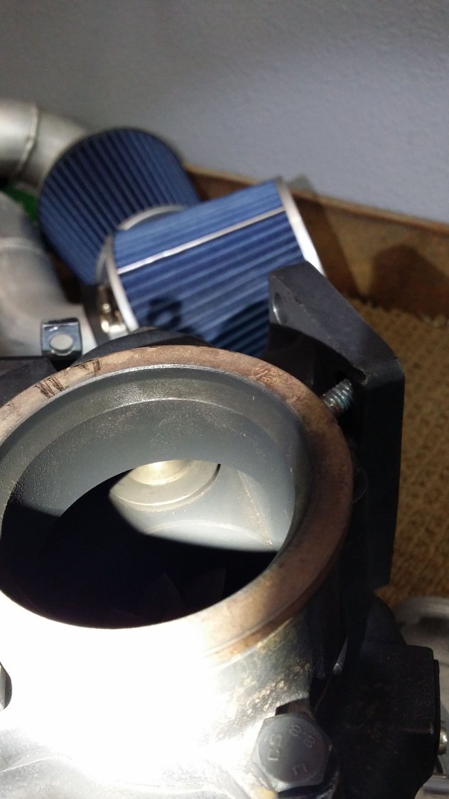

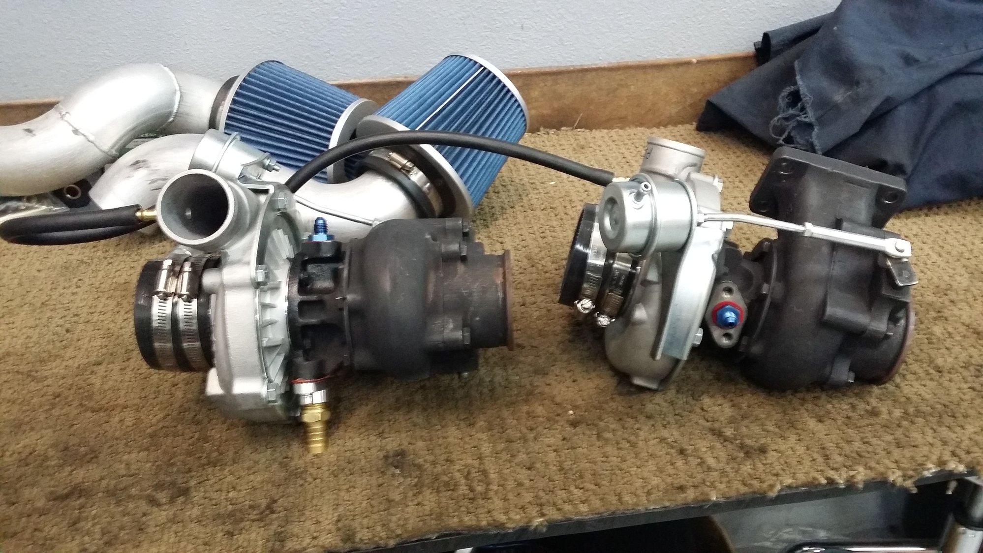

Turbos with the waste gates
inside turbo flapper
BOV configuration

Originally Posted by dannyj661
Im not using a boost guage the dyno guy told me. Had boost chart. only did 287rwh which is stock. Any body know why it blowss off 3 times im sure that is a big problem too
You still haven't given any info about how all of your vacuum lines are ran, so we can't give an answer.
Blowing off multiple times isn't typically an issue.

turbos goes from intake to waste gate direct. BOV goes to passenger side mid manifold vacuum port. valve covers to the intake port tubing just before the air filter

I normally use compressed air from my air compressor to check waste gate function. It's not bang on, but is pretty close. Maybe they are opening on very little boost, or the pressure on the exhaust side is pushing them open?. IMO there are only 3 things that could be causing this problem. 1) incorrect turbo waste gate function, 2) the turbos are damaged, and not spinning up, or 3) the intake tract from the turbos to the intake manifold is leaking somewhere, bleeding off boost, possibly the BOV leaking?
1 and 2 can be verified with compressed air on the bench. I plump a line from my air compressor onto my waste gate actuator, then begin increasing pressure on my regulator to see where it pushes the waste gate open. To check turbine function I normally just shoot a little air into the exhaust, where the t4 flange bolts up, and they should spool up. On a smaller BB turbo you can do this just by blowing in there with a big breath. Number 3 can be more difficult, but if you eliminate 1 and 2, then just focusing on 3 should be manageable.
