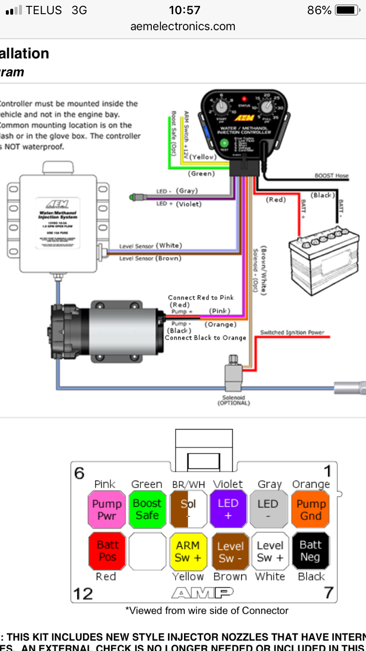

Hey guys,
so I just install an AEM 30-3300 boost meth kit and have a couple questions. I ran the two wires to the battery, two wires to the LED light, two wires to the pump, two wires to the tank float then the yellow wire to an ignition switch wire under the hood. When I turn the key to accessory, I can hear the pump running. When I push the test button on the controller the pump gets louder, the fluid comes out of the nozzle.. After that I take my finger off the test button, the status light flashes red. Is this normal? The car is not running and I have both dials are set to 0 for now.

So start PSI is set to 0, so with the car off, the START PSI will be triggered since MAP is 0psi, and the pump will kick on at partial speed. When you press test, it should kick the pump on at full speed, as it would when the FULL PSI is triggered, which explains why the pump gets louder.
You cant have both dials set to 0 because the Full PSI dial starts at 6PSI
As for the error, there are 3 different ones.
Pump Driver Shorted
Trigger Condition: Current exceeding 15A on the driver output. The status LED will flash a count of three and repeat. The pump driver will turn off to protect itself and automatically retry every second. If the short is removed the controller will function normally. Fluid flow is lost in this condition.
Pump Driver Open
Trigger Condition: Open circuit between pump drive and battery voltage. The status LED will flash a count of two and repeat. The pump driver will continue to drive the pump. If the open is repaired the controller will function normally. Fluid flow may be lost in this condition.
Battery Voltage Out Of Range
Trigger Condition: Battery voltage is below 8.5V or above 16V. The status LED will flash a count of four and repeat. The pump driver will turn off to protect itself and automatically restart when the voltage returns to the normal range. Fluid flow is lost in this condition.
I cant see it being the first 2 considering the pump is working. My guess would be low or high battery voltage. But as stated above, you should count the flashes and get back.

ok so I tried it again. I turned on the ignition to accessory. The red light automatically started flashing. From there I hit the test button, everything seemed good. Fluid came out etc. once I released the test button it started flashing conintously for 10 blinks until I shut the ignition off. Any ideas?

So I called AEM. They said since I’m running straight meth, the float doesn’t pick up the level, hence the single flashing light. I guesss this is common when guys run straight meth. I just have to connect the two wires and run it without a level sensor!

sorry if I'm hijacking this thread. I'm working on installing my aem kit as well. Is anyone connecting the blue wire(0-5v maf), the boost safe wire(yellow) or the solenoid (green) wire.
I wasnt planning on. Running the solenoid or the boost fail safe. I do need to find an external maf source that supports 0-5v. I have no idea what that means. Anyone enlighten me.

You might have different instructions then me. This is what I used. I did not hook up the green wire (boost safe) or the brown/white solenoid wire. I hooked up the 12v arm switches wire to a powered by ignition source to turn on and off with the keyed ignition.
