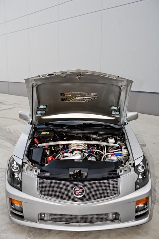

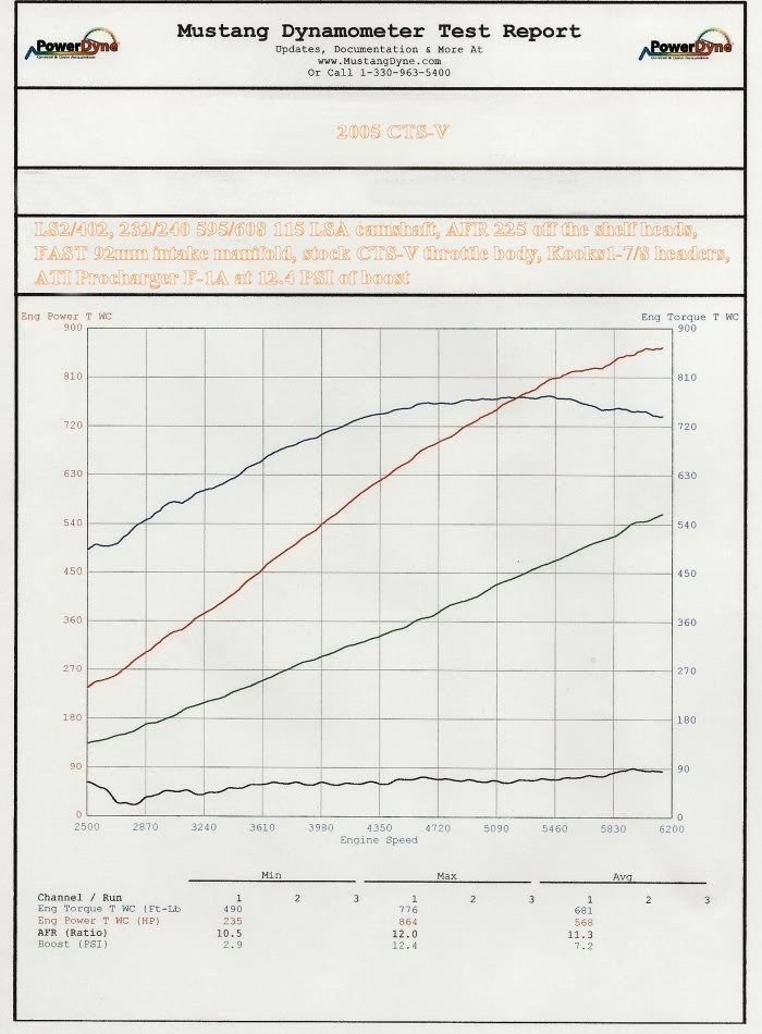

Boost will comes in sooner and it is smaller. The F-1A is a great all around blower. We built this CTS-V at the old EPP shop and used an F-1A. http://www.superchevy.com/features/0...cadillac-ctsv/ Once we swapped the LS2 intake for a FAST 90 the whp went from 809 to 864.
We used to camshaft https://shop.brutespeed.com/Brute-Sp...d-Camshaft.htm and as you can see from the graph below, it makes almost 400 ft lbs of torque at just 2000 rpm. Bob
