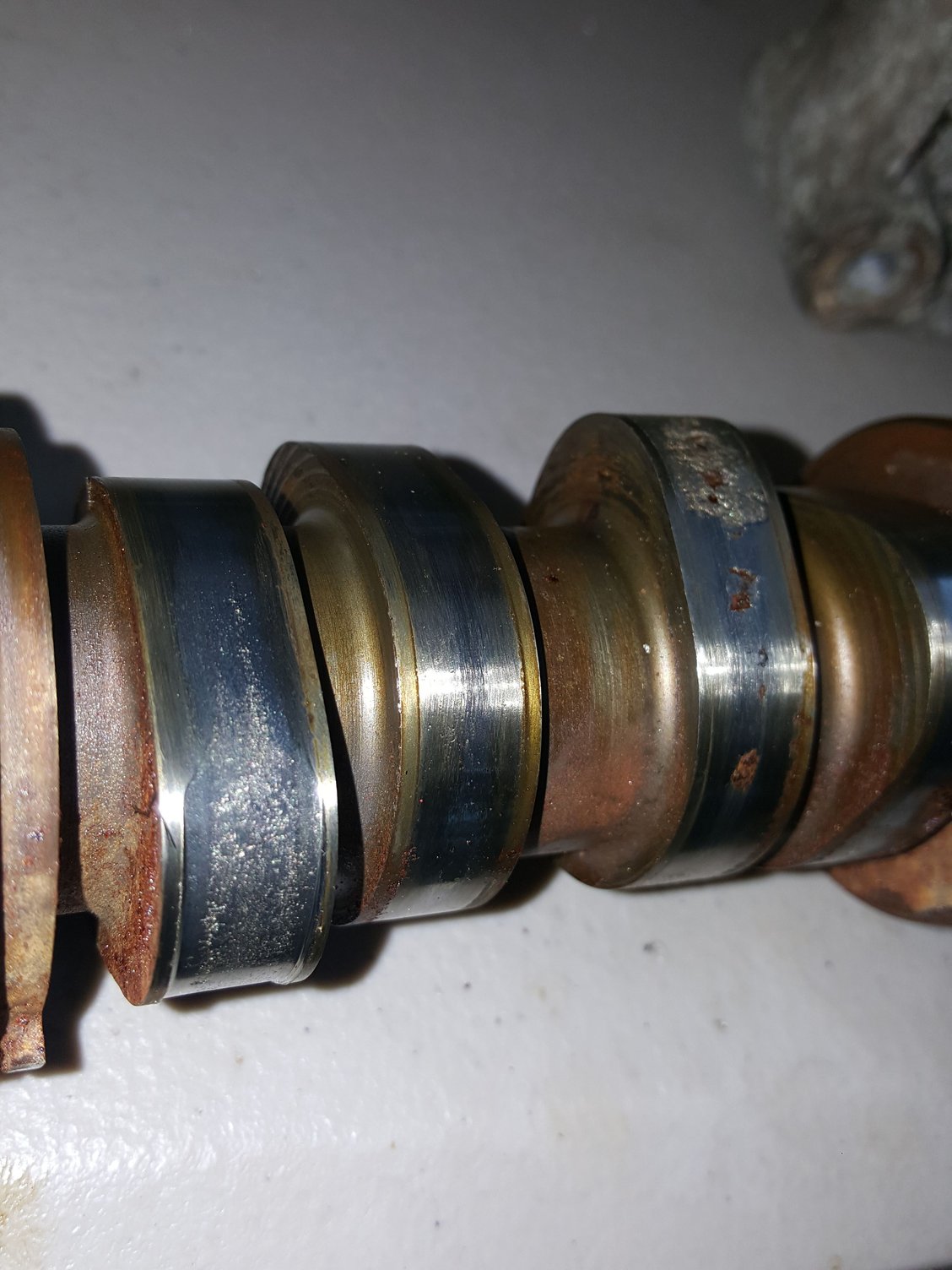

well when i pulled the cam i found this....couple of the last few lobes wiped out on the cam. any one had one like this?
is it a few bad lifters or due to a low oil pressure situation?
i had no intentions of taking the lower end apart....looks like im gonna have to now...

Could be bad springs, looks like the lifters were jumping around on the lobes.

You were going to pull the heads anyways so once you pull the lifters you will have more answers.... This would lead me to at least want to check out the rod bearings which I would see when gapping the rings anyways so now you can gap your rings , lol

I would say one problem was lack of oil, then go after why was there a lack of oil.
Anymore I pull the engine down, bearings are cheap, and my luck at a good engine
has not been very good, lol.

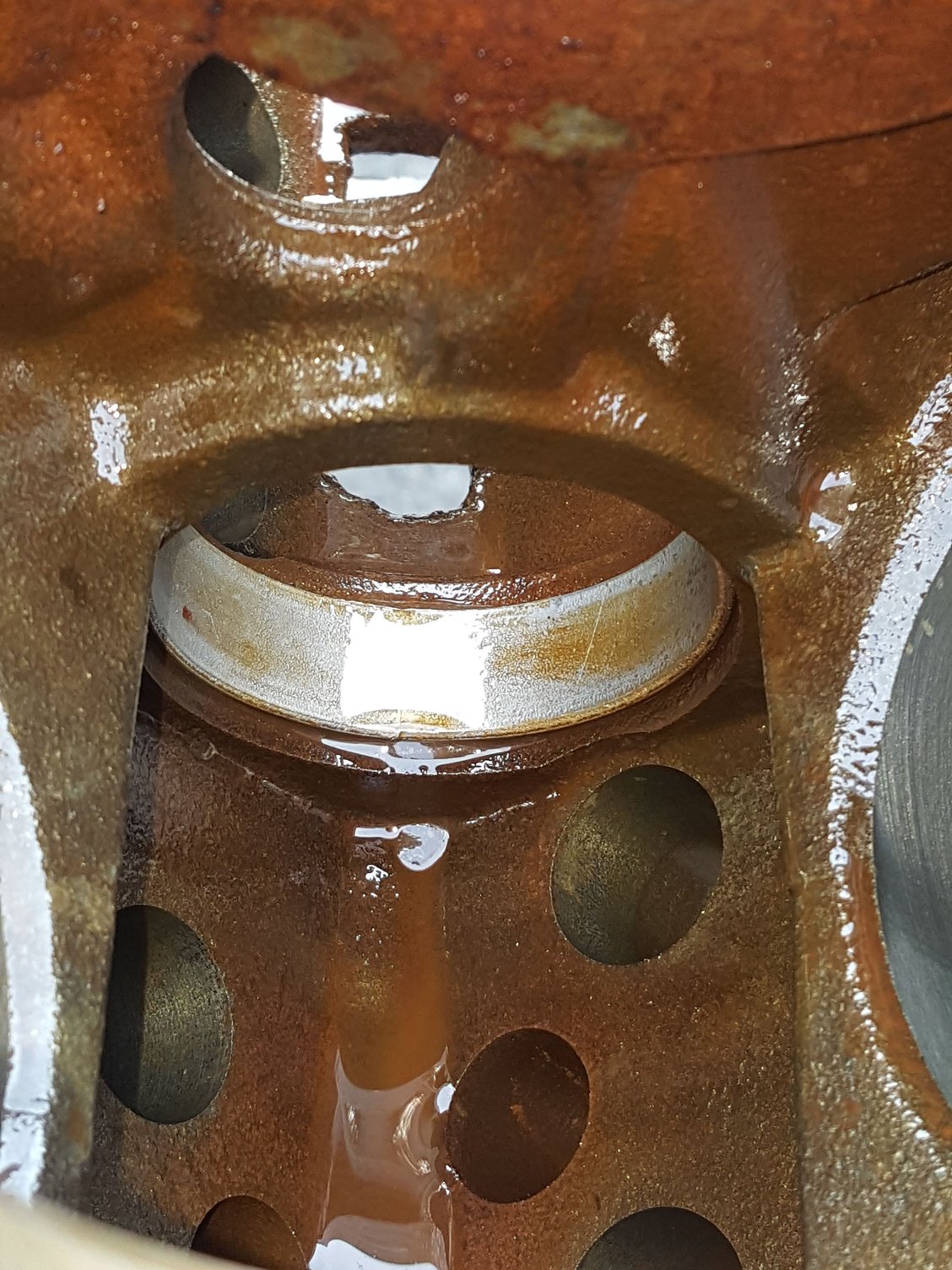

well disassembled the engine....cam bearings are shot . mains look ok , rods look ok ish.
so looks like its gonna need a new set of lifters, pushrods,oil pump, timing chain, new cam bearings ,pribally rods , regap rings and back together......uhg

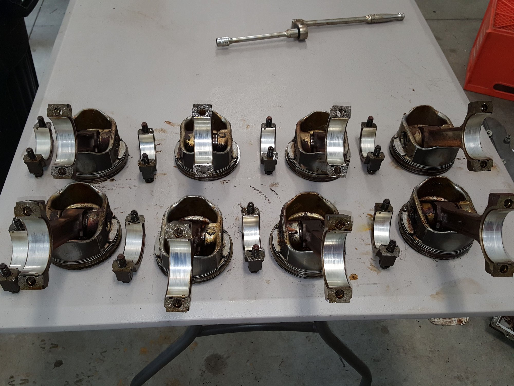

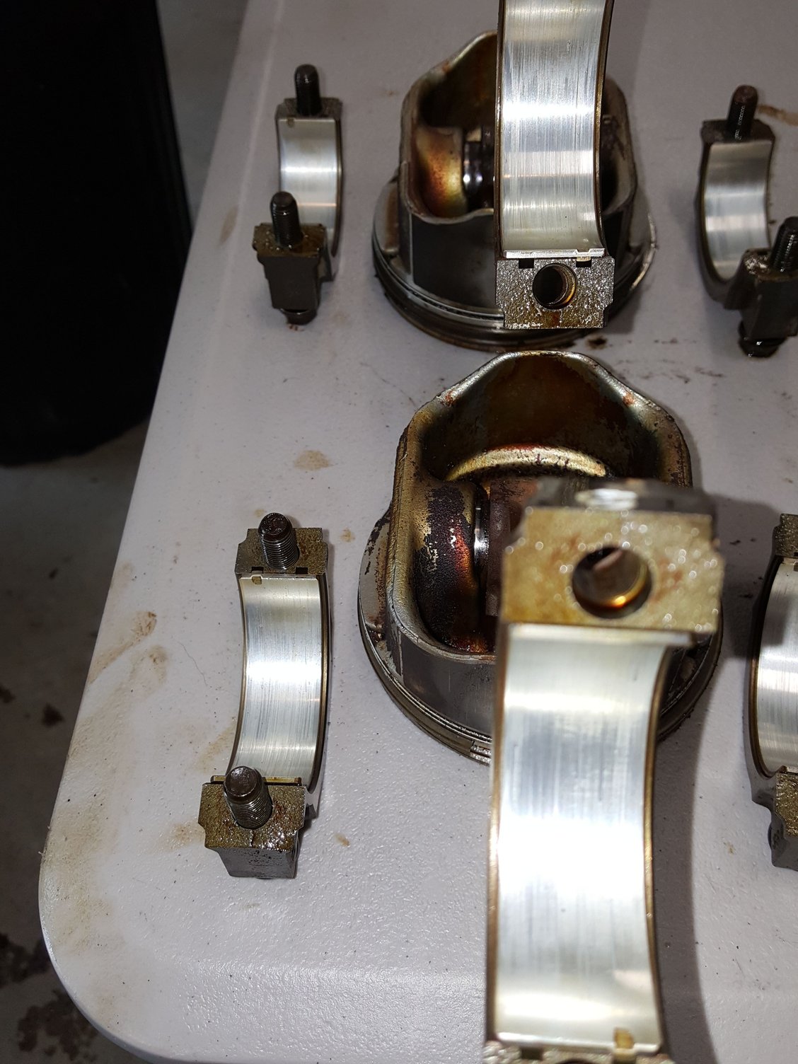

what do you guys think about these rod bearings? reuse or replace?

gap the rings new cam and lifters reuse the rest

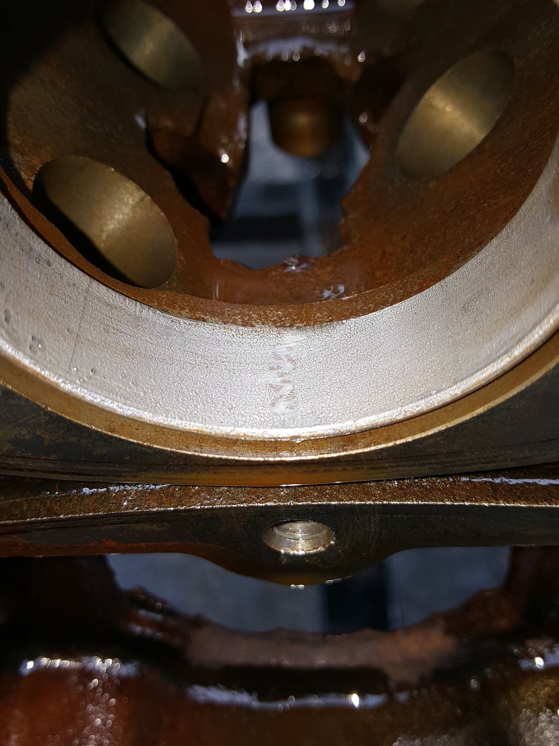

Jason - those rod bearings look fine... I am working on an L33 with similar look, but 1 had some copper showing so I got some Clevite standard replacements on amazon for 18 bucks...
CAM bearing isn't even showing copper so send it....

the top pic is all copper....as a matter of fact all the cam bearing are showing copper.
i dropped block off today to get new cam bearings and gonna have heads surfaced.....rest is going back together
