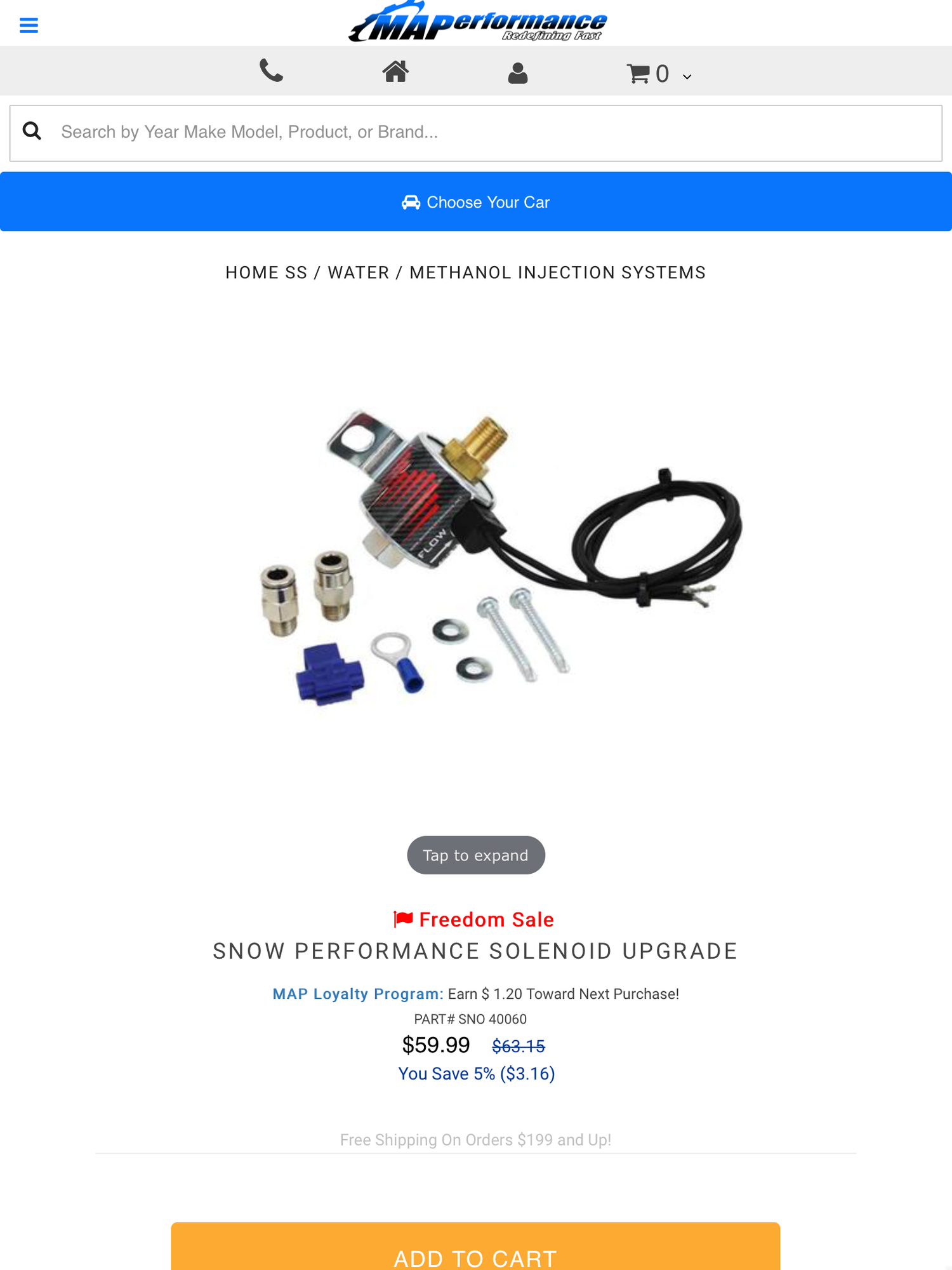

You can get a solenoid that will stop flow unless the pumps on. I did this to avoid this issue. It's like $50 summit racing
Thanks. That may be easier than moving the nozzle.

Old Jul 1, 2018 | 07:30 AM
jimmyg's Avatar
Joined: Jun 2014
Posts: 1,533
Likes: 12
Cheap insurance
Old Jul 1, 2018 | 08:56 AM
NitrOmm's Avatar
Joined: Apr 2009
Posts: 567
From: Wellington, FL
Thanks JimmyG, that was my next question.
As as a precaution I dropped the reservoir lower than the nozzle. I intend to give it try in a few hours. This is just a bandaid. That is the 1/2 assed way to deal with this ... but I’m truly not in the mood to drill a new hole, plug the old & move the nozzle.
Ultimatly a $60 precaution such as this can save me some agrivation.
Can you give me any advise on the wiring & instal.
-What triggers the solenoid ? ( same MAP sensor wire ?).
- is it positioned on the high pressure side (just before the nozzle) or between tank & pump.
