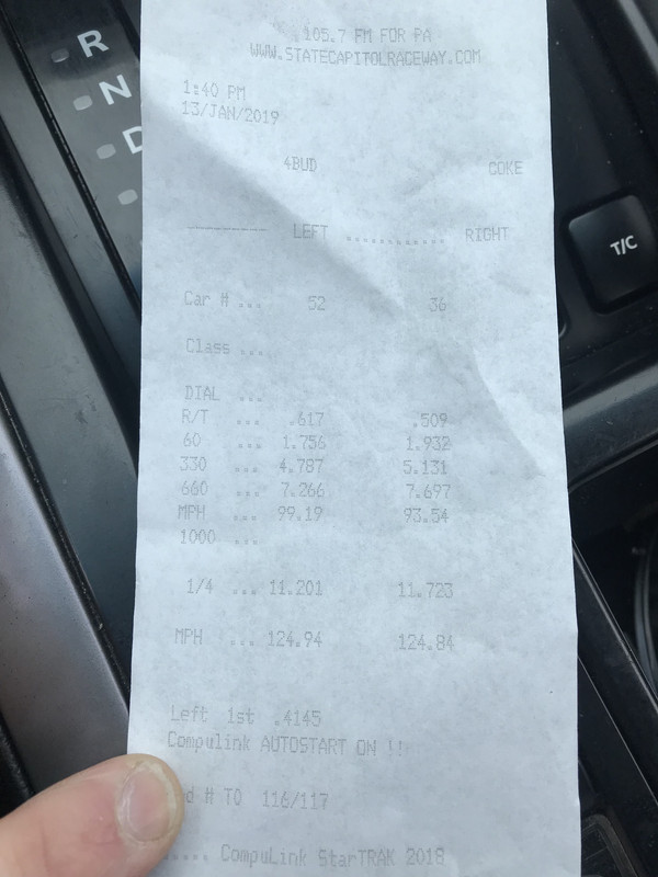

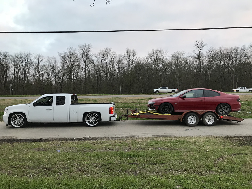

So here’s a little bit of story. You can call it excuses, but it is what it is, and I don’t like to lie.....you guys can probably tell I’m pretty stand up fella. At least I like to think I am. Anyways. My goal for today was 10.90 at least at 127 ish. I didn’t get there. And a few people predicted I’d run low 11’s at mid 120’s. Well they were right, to an extent. I did break the car but I was having some laptop issues the whole time. For some reason my backup laptop (had to send my good one off for warranty repair) kept on not reading my data from my logs correctly. It wouldn’t display them in the histogram correctly so I was having to guess what I needed to do. The fueling was working right so I got that pretty close and my spark adavance was too. I was getting 8 to 11 degrees of spark even tho I was commanding 13-14 degrees. I mixed my fuel to be 100 octane so it should be good with that timing. One of my passes was a doozy, it made 12lbs and went slower. My guess is it was way rich because I never hit 12lbs before and I had it set to dump fuel for a safety if it ever went over 12lbs. I forgot to remove that, and I only saw a max of 11.2 lbs on the street. So after trying to figure out why it was pulling timing and fixed the fueling, I max another pass and it breaks. I’m now leaning more towards the driveshaft broke. I’ll have more info later. But for now, here’s some pics for you.This above is what I was referring to. My map sensor appeared to be reading incorrectly. Later found out the v band broke and I really wasnt getting the boost pressure i normally do)
Best pass. I only got three chances so it is what it is. Left lane
And my buddy had to come get me.

Not by any means a truck guy, but you buddy's truck is COLD. Id rock that as a daily.

yea it is a nice truck. I did a tune for him the other day. He has a 4.8, said it pulled my car way better than it normally pulls. And he picked up 2mpg from the highest he ever averaged. Plus it’s way more peppy, I didn’t even notice on the hour ride home that the car was back there.

custom made Raceline 24x9 and 24x10
truck rides extremely well too.
