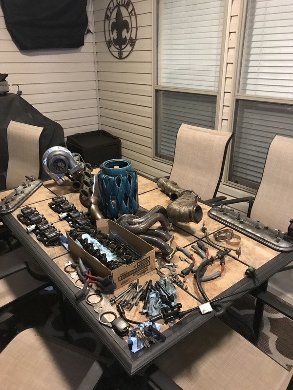

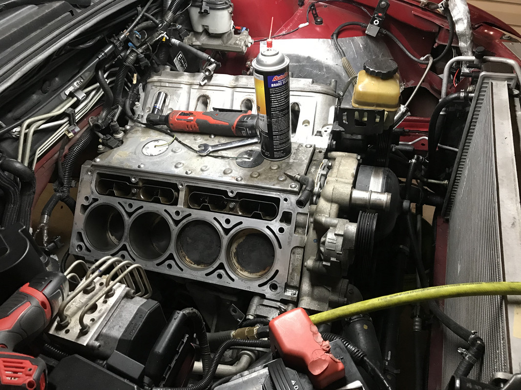

Little update. After consulting with my buddy who builds ls cars for a living, I decided not to pull the engine out. I didn’t feel like messing with the ac anyways. He told me that if I take the rod bolts out that he wouldn’t reuse them. And he wouldn’t reuse the bearings either. He said they have a small amount of crush to them. So i did some research and it can go both ways. Some people had no issues, some spun a rod bearing in a short time and some had a window in the block. So I decided to leave it alone. I did pull the heads today and put ls9 head gaskets on it. He told me the ls1 gaskets would last for a while but the ls9 would likely last longer. So I picked up a set of those. I also figured if have the coolant out of it and the thing half apart, why not put a milder turbo cam in it? I scored a summit racing ghost cam from Mavn so I figured why not do it now? I also bought arp rocker arm bolts a while back so those will be going on too. I should have the engine back together tomorrow, I got a late start today and I finished the heads and called it a night. Now for a couple pics.
the wife wasn’t happy about this when she walked outside lmao!!

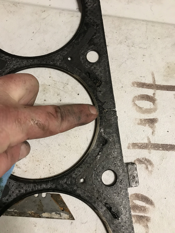

Can you see how the coolant was escaping? That sucks. I’ll never use a graphite gasket again.

What’s nice about the graphite gaskets is they let go before you torch a head. Think of them as the fuse in a shorted wire. MLS are very unforgiving as it’s basically solid metal and thus harder than the aluminum it’s clamped to. So the head goes or the piston before the gasket does.

the thing is, I don’t think the combustion part of the gasket let go. There was just a trace that the coolant was blowing out of. Look real close and you can see in the pic that bolt right next to that area felt a bit looser. And look, I take the blame for this no doubt. I was supposed to go back and retorque the head gaskets but I didn’t feel like it. I called the company (sce I think) panda they recommended me retorquing but I probably could get away with not doing it as long as the motor wasn’t boosted or nitroused. Well, I see how that turned out!
