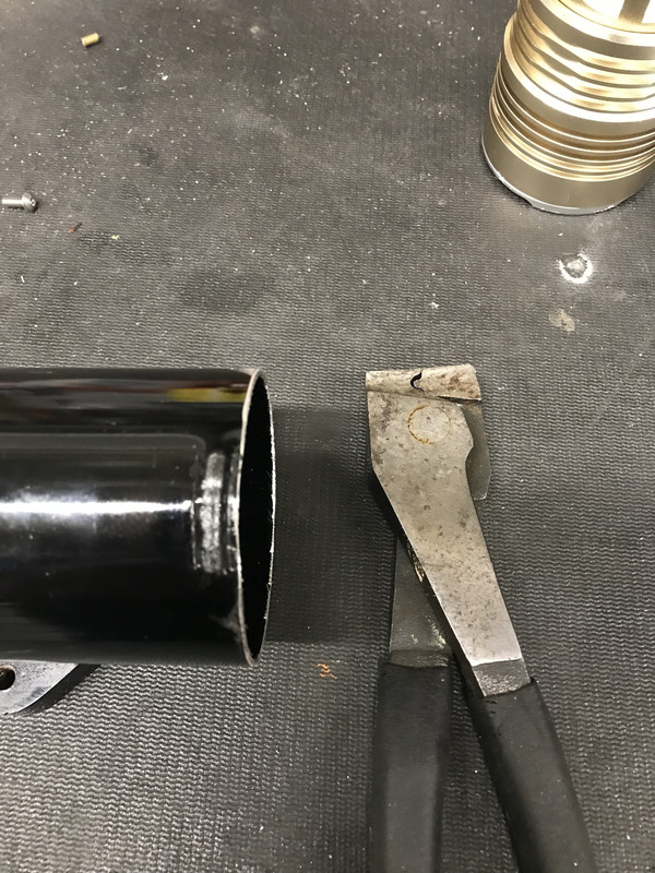

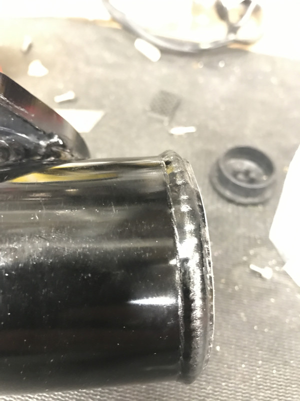

So anyways. I had a few more parts I needed arrive. I wasn’t happy with the 3” pipe clearance on my cold side so I ordered 2.5” parts. Mainly just some silicon couplers and a bov tube. I didn’t like how long the bov tube was so I had to shorten it. Now there’s no bead left on the pipe so boost may blow the pipe off. So after looking for bead rollers and seeing they were $200 or more, I decided to make one. Only cost me $0.00 lol. Took maybe 2 minutes too. I cut the snout off some crimpers. Made no other changes. It crimps a perfect bead on the pipe like it was welded. Check it out....
Here’s the start. Tool shown.
Little more
Here’s half way around. You can tell it rolls the front too so the couplers slide over easy.
Side view. It actually looks like a welded bead. Looks better in person than pics.

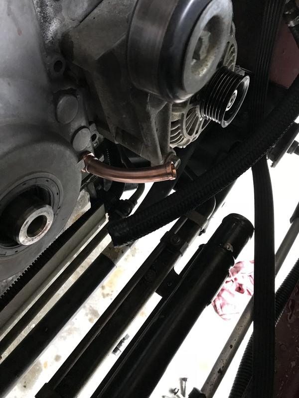

I need you guys opinion. I’m working on my drain right now. I ordered an aluminum fitting but I made this one up today just to see if it may work better. The only downfall I can think of is its copper. Not sure if that matters. I plan on powder coating it black. Any drawbacks to doing this? It would be jb welded in but the cover is threaded for it too. Jb weld as a precaution.
