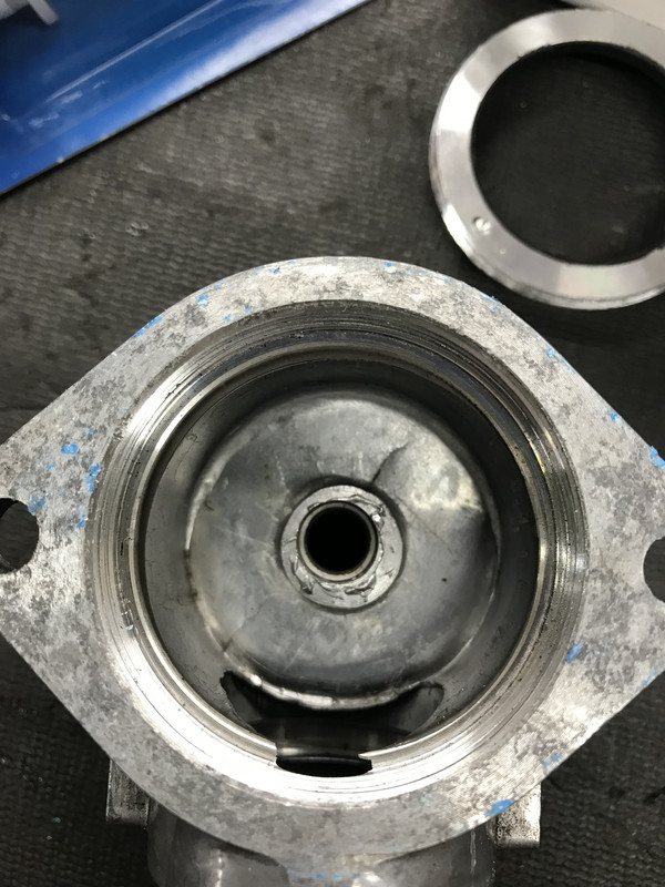

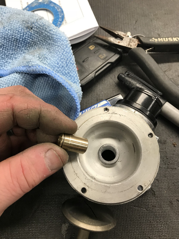

Here’s some more info and pics on the BOV. I rebuilt mine last night. Seals perfectly now. And should last a very long time.
Look how this crap was off center.
I center drilled it in my mill. Then I machined a bronze valve guide for it. I drilled it out .001 smaller than the valve stem and honed it to size.
And Check this video out real quick. Only a couple seconds long, but shows you the precision (lmao) machining of the valve.

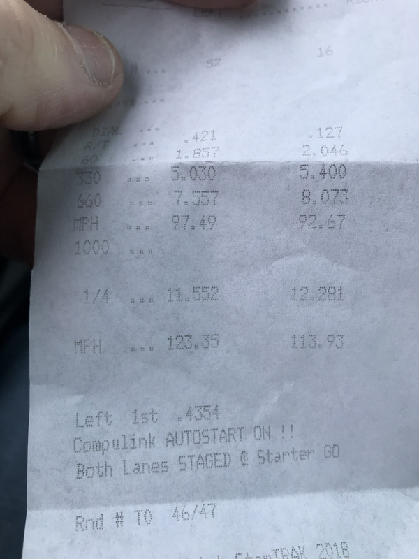

First pass. Neutered street tune. Low boost. 11.55 @ 123.35mph. It’s got a lot left in in. I ran it on low boost so I would make sure I at least get one pass not spinning. They done shut the track down twice since I been here and I’ve only been able to make one pass so far
Nice pass. What exactly is low boost? If I remember correctly, you were around 12psi?
