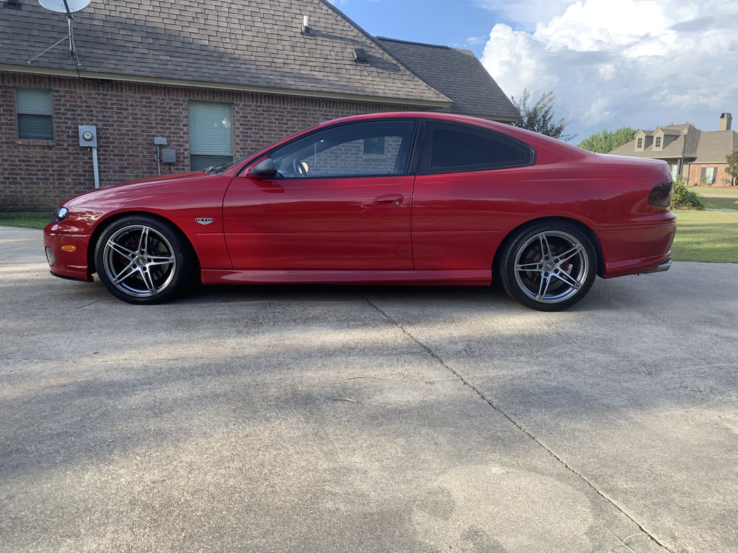

hello fellows. I wanted to update how things were going with this. First off, its still doing well. I drive the car a good bit. I think i've put over 4000 miles on the car since the turbo. I broke the trans twice earlier this year but once i went ahead and realized I cant be cheap about it.Since then it hasnt skipped a beat or slipped at all. Honestly I'm pretty impressed with how the trans is taking this.
Lately I've just been improving things. I put an Cold Case aluminum radiator in it. I Changed out the trans cooler and added a fan to it. Temps dropped over 30 degrees on my trans fluid because of this. I've heat reflective wrapped my intercooler pipes. Seems to help with heat at idle, I mean it dont make a huge difference by any means....but every little thing adds up.
I was running out of fuel supply as I moved up in boost. Once i got below half a tank, it would lean out. Did some research and found that after a certain point, the bucket, which acts like a sump, runs out of fuel because the volume is small. The fix? A hummer or big block fuel bucket, which is named the 8.1 bucket mod. Its not a direct bolt on, but the way i did it, was as close to factory like as I could. instead of using worm clamps, i used factory style stainless steel pinch clamps. instead of using rubber hose, I used the plastic high pressure flexible hose like the factory uses. This mod was well worth it and i've run it to 1/4 tank and it now holds pressure.

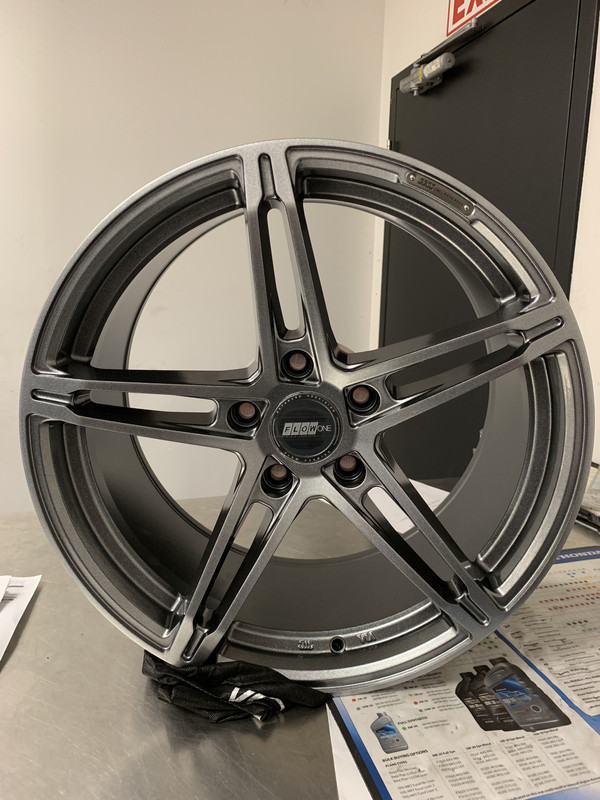

I put some new wheels on it for daily duties. These wheels are much lighter and are now staggered. I have a 275 wide tire on the rear now. 18x8 and 18 x 9 Flow One race spec F1's. 18lbs each. I'll include some pics below.
I've been concentrating on cleaning the car up lately. I buffed it, polished it and then ceramic coated it. It looks so good now. I'm having the front bumper painted next week because I have a bunch of rock chips that bother the crap out of me.
I'm now on 12-13psi on third gear and 11 psi in second. My very near future plans are:
-install my meth injection i already have
-new better looking tail lights
-build a single exhaust and use a Varex dual mode muffler sometimes I might be in the mood for it to be loud)
I have a bunch of other little things to do not performance oriented like install my remote start and my stereo system. and a few cosmetic items.
p.s. I CANT BELIEVE THIS MOTOR IS STILL TOGETHER! Lol

New wheels look good. What tires are you running on them?
nankang as-25's
245/40/18
275/35/18
super cheap tires but work surprisingly well! I'm not trying to autocross or drag race with them although they hook up pretty decent from a roll. I highly recommend them if you looking for a cheap daily tire. quiet and ride good too

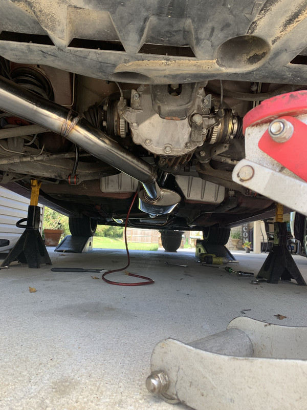

I wanted to update you guys.
Redid the exhaust. Turned out pretty damn good except the welds. They aren’t bad but they look like three or four different people welded it lol. Why? Well my shop is a wreck and I couldn’t get comfortable while trying to weld. And I hadn’t welded since I built this turbo setup which was shockingly over a year ago. Time flies I tell ya. Damn.
anyways. I’m in the middle of a break, eating lunch. Finished exhaust earlier and now I took it and the downpipe off. I shouldn’t have been looking, but I have an intermittent squeak/rattle and I noticed the downpipe was sitting against frame. So now I’m having to whoop the pipe a little in that area. No biggie.
heres pics of the exhaust. Btw, old exhaust weighed 46.2lbs and new one weighs 19lbs.
The hose clamps were for mockup on the hangers.
