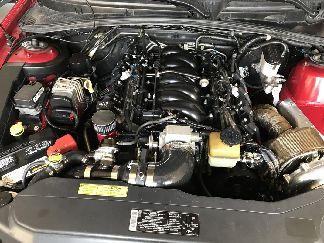

Ok here’s an update. Read through for anyone doing this. There’s lots of conflicting info on the web. What I’m am about to tell you is fresh on my mind and by actual experience. So. I got it running and driving. Last night I swapped in a cobalt map, 2 bar, it’s not 2.5 bar. The boost sensor a cobalt has is 2.5 bar, at least that’s what a gm engineer had posted. I don’t care anyways, this map works perfect. Gm part number 12580698. I installed my 60lb dekas. I did a complete rewrite to a custom 2 bar operating system. I uploaded the injector data a buddy sent me. (If you need it I have it in a tune file for easy copy paste because I’m not trying to be a secretive jerk) Turned the maf off just in case. Cranked it. Fired up and idles perfect. I had to make some fueling adjustments because it would barely rev. Got that out the way. Then I could not stall it up. More adjustments. I had a trans line pop out the radiator cooler, hate those factory quick connects now. I had fluid go everywhere. Cleaned it up but not so good. Kept getting smoke. So I washed the under side of the car. Let it warm up to dry everything off. Found a small leak at the drain flange on the turbo. Damnit. So I’ll have to fix that. But hell. Think about it. All the **** I did and that’s all I gotta fix? Not too bad. I’m satisfied so far. Now for the more interesting ****.
Took her out on the road. Had it running fat. Get on it, no boost. Cutout. Ok. Still too rich.
O btw.....it’s much quieter but kinda sounds like ****. Like a grand national. O well. Flock it.
Anyways. Lean it out a few times. Finally get some boost. Guage said 5psi. I didn’t run it out. Afr was in the low 10’s. Still too rich. Scanner and map sensor said 3.5psi. Probably more accurate than a $25 China guage. Time for an upgrade. I made three back to back pulls. I only pulled it to 5700rpm and 70% throttle. No boost creep I saw. Intake air temps got to 189f. Yea. I know. I know. It is very hot today too. I won’t keep gouging on it. Plus it running rich probably didn’t help. I do need to change my fuel pump so I’m dancing with the devil right now. Im going to stay out of it till I get the pump.
I’m pleased that my blow off valve isn’t loud either. I don’t have any more exhaust drone either. No exhaust leaks. So far so good. My hood doesn’t get too hot to touch with your hand. My under hood temps “feel” about normal or the same to me. I didn’t measure so I don’t have any concrete data. At this point it feels like it added 50-75hp and a bunch of tq. She drives very very good. If you guys want I’ll post a quick pull video.

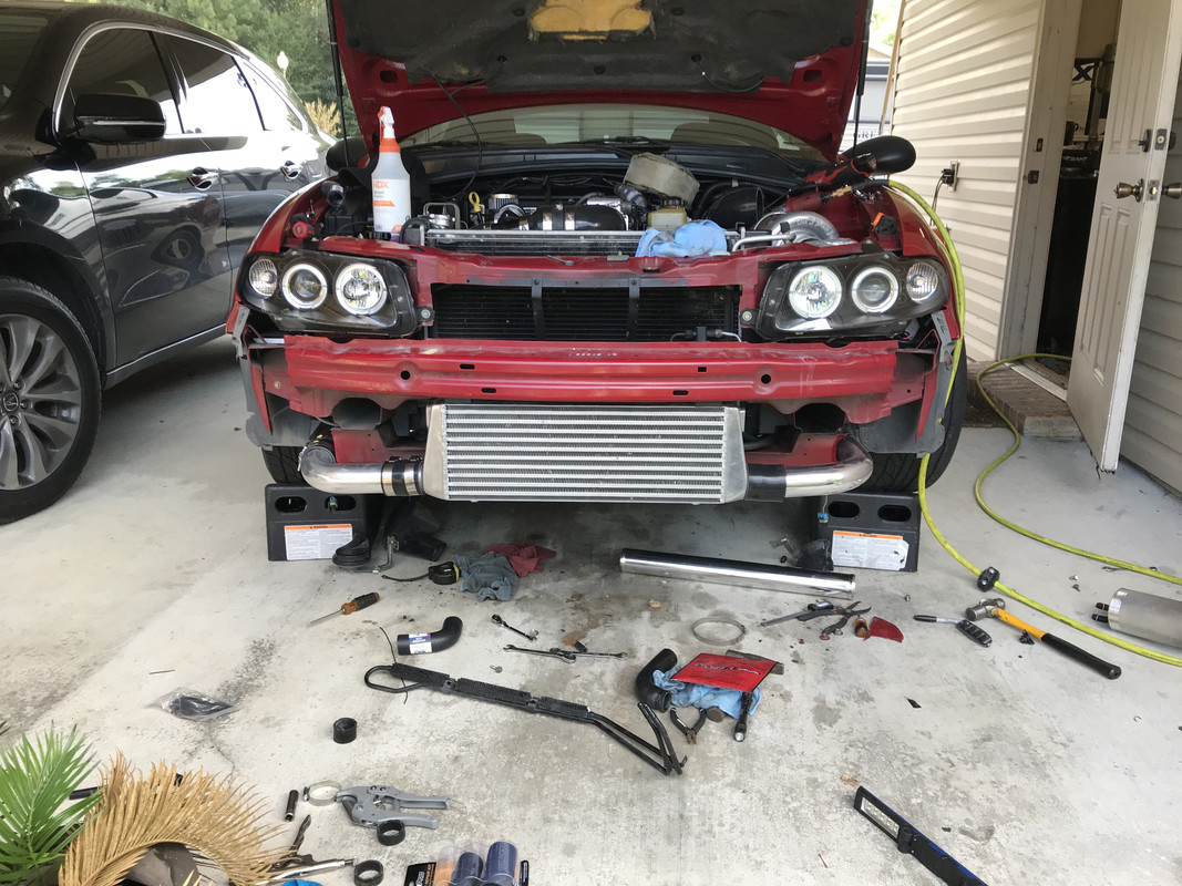

Ok fellas. I decided it was time for an intercooler. I didn’t expect this to take all weekend but I did because I was very picky at getting things to have clearance without rattling or touching. I also did not want to cut my frame rails and go through that. All I had to do was bend a few pinch welds and cut a hole in front of the driver front tire/fender so the pipe and air filter can go through. If I ever decide to remove the turbo it would be easy to put a cover plate over the hole. My iats are way way lower and I turned the boost up to 6psi for now. It pulls pretty dang hard now.

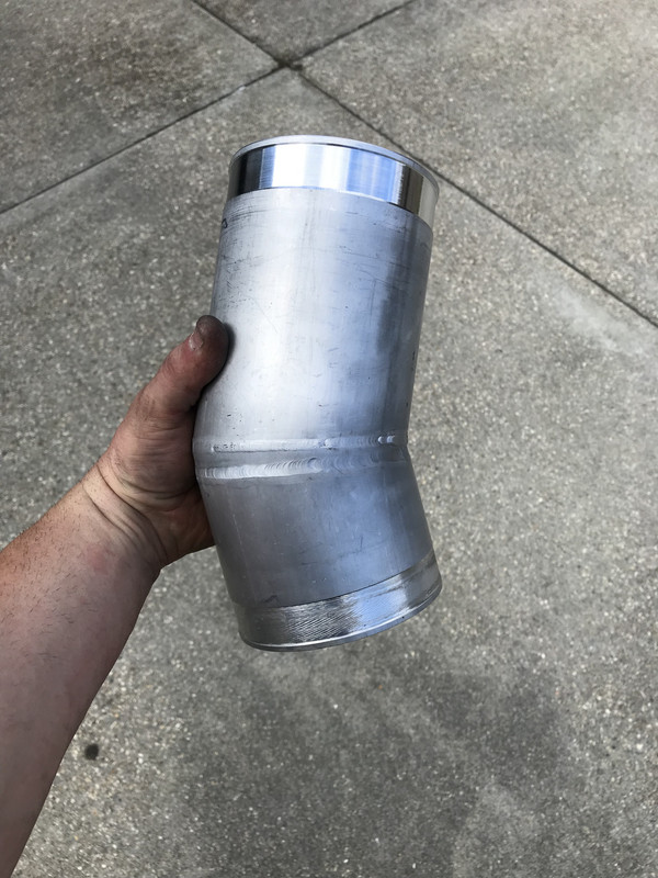

Had to shorten the intake. And I had to cut that groove in it. Talk about scary having that curved end whipping around

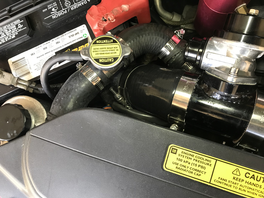

Had to snake the radiator hose around it

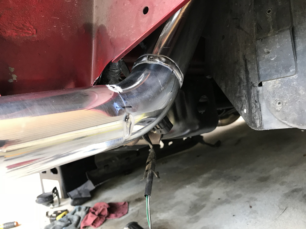

My super professional welds. Not! But I’m learning

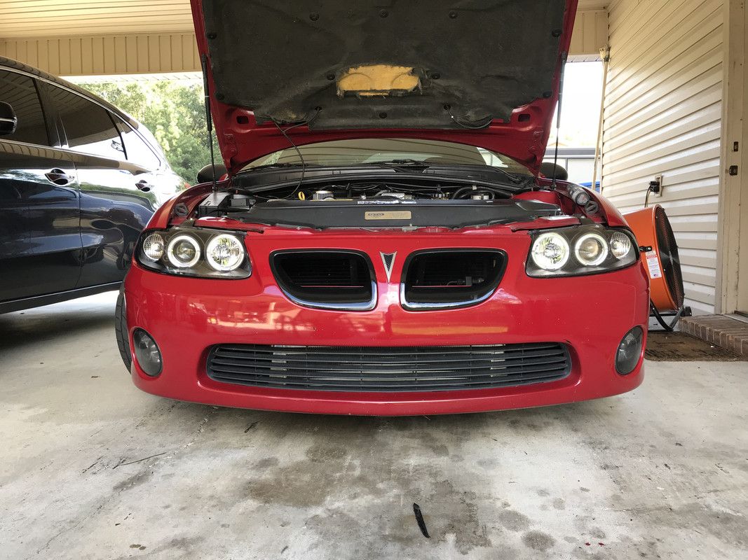

Top view. Had to trim the radiator cover a tad. I really didn’t want to cut on it but I had no choice
To the unsuspecting you can’t really tell it’s there. Sleeperrrrr

yesterday on my first drive rive I saw a max of 117f after smashing it about three times. This morning which it was about 75f outside, I saw about 84-85f cruising. Get caught in traffic it was 88-90f. Start moving it would drop. Today at lunch it’s about 95f and humid. Nasty hot. It got 135f in traffic but that’s after a heat soak. I start moving and the temps come down. I saw they sell some nice little 7” puller fans. I could put two on there to help cool at low speeds. Opinions? I’m about to post another thread in boost controller options. It’s time I start thinking of that. I can spin them in second gear at 45mph. That’s nto5r and I’m putting regular tires on to cruise. It’s going to be pretty dumb so I need to be able to turn it down.
