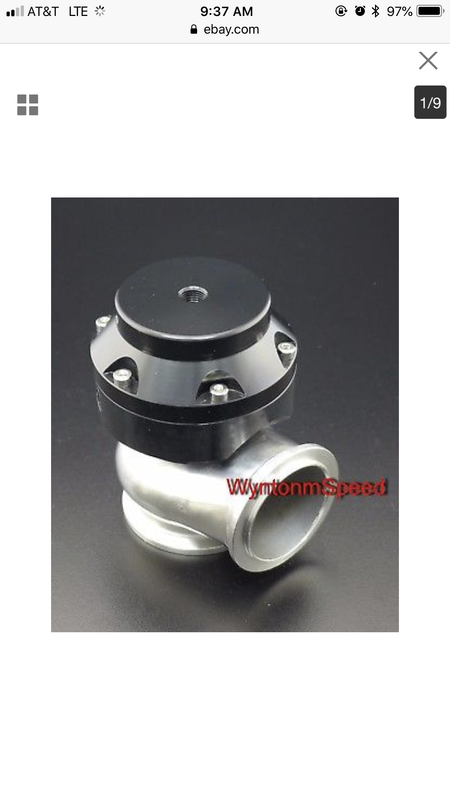

I have a wynton speed cheapie wastegate with a 4lb spring in it. I get 3psi on just the spring and 6psi on the controller, max. I want to put a 6psi spring in it but I can’t find the spring seperate. Any ideas? Anyone have a spring for this wastegate? It’s a 44mm btw.

I was in the same boat but opposite. I wanted a lighter spring. Emailed, no reply. So I just went to my local hardware store and bought a bunch of springs about the right diameter and measured them on a small scale. Surprisingly they work great and are very close to what they scaled out at. They’re only about an inch in diameter, by fit the register of the gate fine with a little persuasion. Air test your gate too before and after to get a cracking pressure. It’s not a guarantee, but at least a you’ll have a reference point.

Add washers under the spring to stiffin it. Tht will raise boost a few psi. Or add a smaller inner spring to the one u already have.
damn good idea! Thanks!

Stretch the spring a little too.

You could try putting the line from the turbo to the top, tee it to the controller,
then to the bottom-but you gotta be careful, open the controller all the way,
and watch the boost gauge.
You could post the dims of your spring, length, inside/outside dims., wire dia.

Yea be careful using the top wastegate port. It will make full boost, very quickly!! Your boost controller will work, u just gotta fine tune it and pay attention to boost.
U can also remove all lines from your wastegate and it will double your boost psi. If u have a 5psi spring with line on bottom, remove line and it will make 10psi. This is also why your boost controller can only get 6psi out of a 3psi spring.
I would get up to 5psi on spring and just use controller to work up to 10psi if needed. Use washers to shim it up to your boost liking.
To me 3psi of boost isnt worth bothering with. 5psi minimum in any of my setups. This is just to be able to control launch boost at the track.
Remember U can only go as low as your spring rating.
