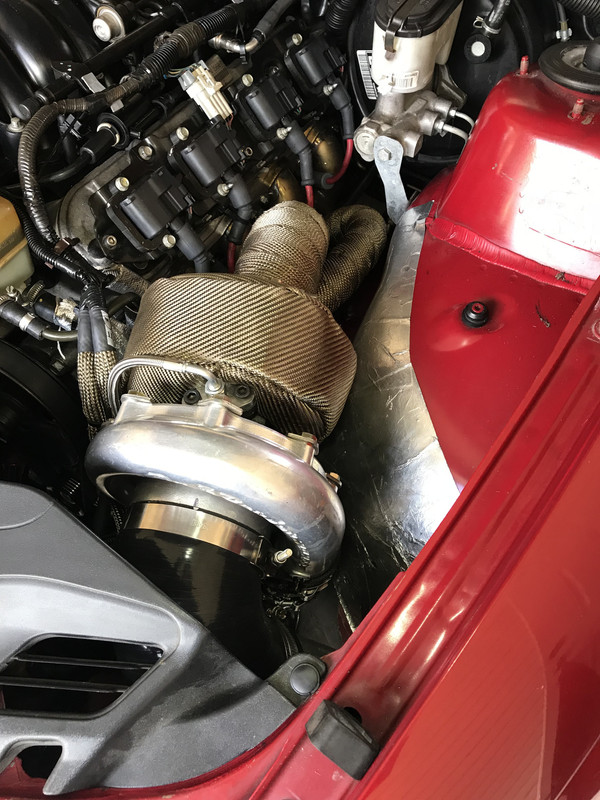

I sold my turbo system off my car. Well the guy is giving me a few lump sums till its paid for. So now I need to rebuild my system so while i'm at it, I'm going to upgrade some things including the turbo. Right now I have a $400 on3 7875 cast wheel journal bearing turbo. It works really really well. Honestly I've never had a turbo car so I have nothing to compare it to so it may be crap compared to other stuff, but for me, I like it. My budget is about a grand, maybe a couple hundred more. If i could get something that would have a little quicker spool, potentially more power and possibly better reliability then that would be great. I'll tell you the units I'm eyeballing right now:
VS racing Billet 7875
On3 BMF 7675 billet wheel
On3 8475 billet wheel with ceramic upgrade
Huron Speed billet 7875 (probably the same as the VS racing but its more money and has their name on it)
or a Turbonetics 11753-BB its basically a ball bearing 7875 with cast wheel for $1385
Thoughts?

What is that? Keep in mind I do not have room for a large turbo.
this is the room I have

if you can fit a 7875, you can probably squeeze a t4 flanged s480
but my vote is for the 7675 bmf, it sounds like it should make 800+ wheel
