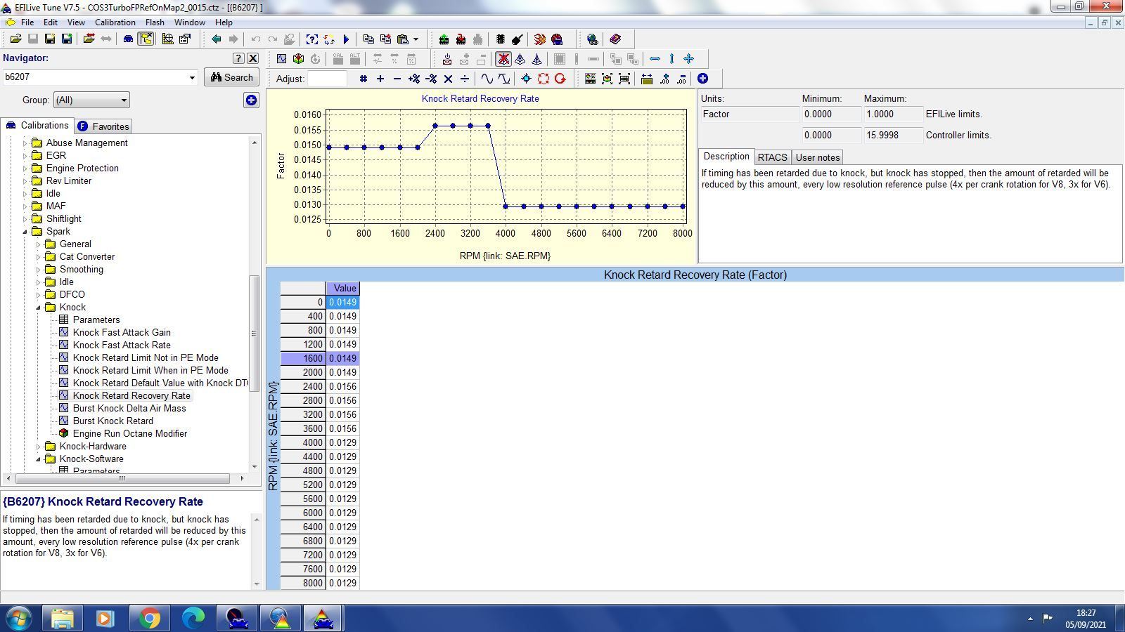

HI, you mean this table up figures to 0.25 ?
Old Sep 5, 2021 | 02:24 PM
  #105
ddnspider's Avatar
Posts: 14,628
Likes: 1,778
From: FL
Yes..

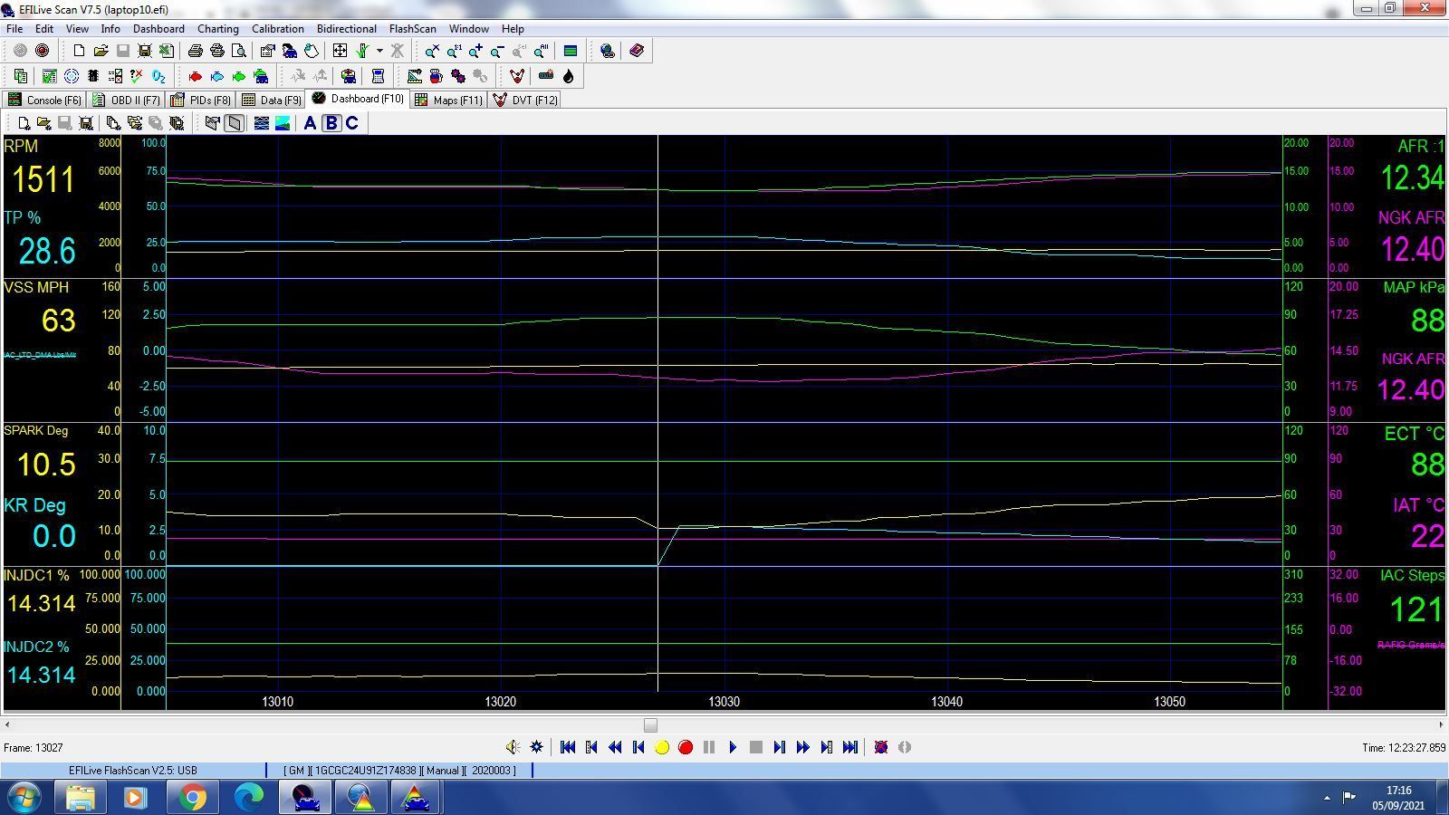

Have attached latest log and tune with BEN factors applied and returned mixture areas back to 14.63 (COS3 tune efilve) which is semi open loop? so any areas set to 14.63 will turn on Oxygen feedback from sensors in those cells.
My reasoning behind this i still want it to pass emissions and also have another problem
If im idling for some time the AF goes lean if open loop, or if i start the engine after a short stop my wideband reads 20 until the NB 02 sensors pull it back down.
If this is heat soak im not seeing it in the tune though as the IAT does not increase much at all. Any insight into this would be greatly appreciated.
