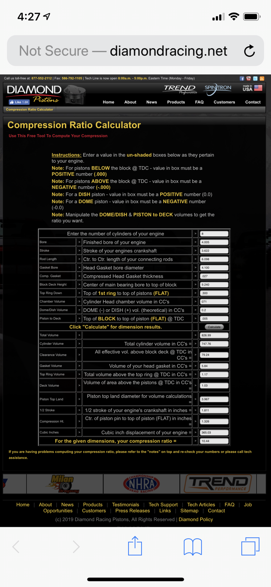

Hey guys just as the title says I’m building my 6.0 with summit pistons and have bought 2 dif gasket sets.. the basic ls9 .051 ones will put me at 9.86... and I bought some mls .027 ones..the thinnest I could find..would put me at 10.44. All on E85.. 7875 gen2 turbo..any advice or opinions are appreciated!
The block has not been decked nor have the heads been milled.. my block measured out at a true 9.240 so using the .027 gaskets Versus the .051 ones would be like milling the heads .024 which is safe

Here’s something to munch on.. so I decided I would check my quench/squish tonight.. so I put a .051 ls9 gasket on the block..put some nice thick peices of solder on top of the pistons.. set the head on and torqued it down..turned the engine over.. took the head of and mic’ed the solder.. .085 was my quench..! Now the heads have not been milled or the block decked.. and my pistons are .005 below deck.. now the 1 variable over factory is that I did put a set of summit LS pro pistons in it.. they are flat top +2 because they have valve reliefs..and although I haven’t checked it with a factory piston in the Block it should by all rights be entirely the same height as the factory one.. which brings me to believe that the quench from GM when they built it was .085..!

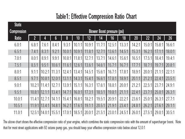

Boost is completely different than NA builds when it comes to compression, With a NA build you have what you have when bolt everything together, Boost essentially allows you to control effective compression ratio. You can have any compression ratio you want up to the point you exceed the capability of the fuel or the mechanicals of the engine itself or the turbo/supercharger ability to make more boost.
Speaking of boost and compression, I have a 8.5:1 compression 408 that made over 900hp with a roots blower @ 15lbs on methanol. Obviously a turbo on my engine wouldn't be responsive on the street but would still make great power when on boost.

I don't recommend going by effective ratio. There's way too many factors at play for any chart of it to be even remotely accurate.
Just using it as an example, It has some validity but not a bible by any means. There are many other variables and now with computers controlling timing and fuel it's possible to get more power than you could have with the same combination pre-computer since you can control fuel and timing in individual cylinders.
